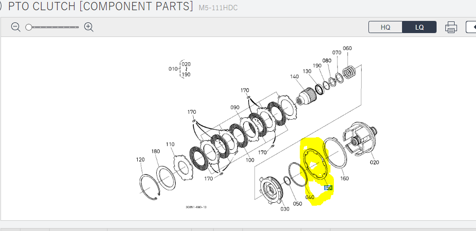

We don't have a M5112 in the USA, But this is a M5111, so guess would be it very similar.
Finding metal in the system and the clutch not stopping rotation means it's probably torn up the clutch, and the clutch brake (in yellow).
It would require splitting the tractor to get to the clutch and repair it.

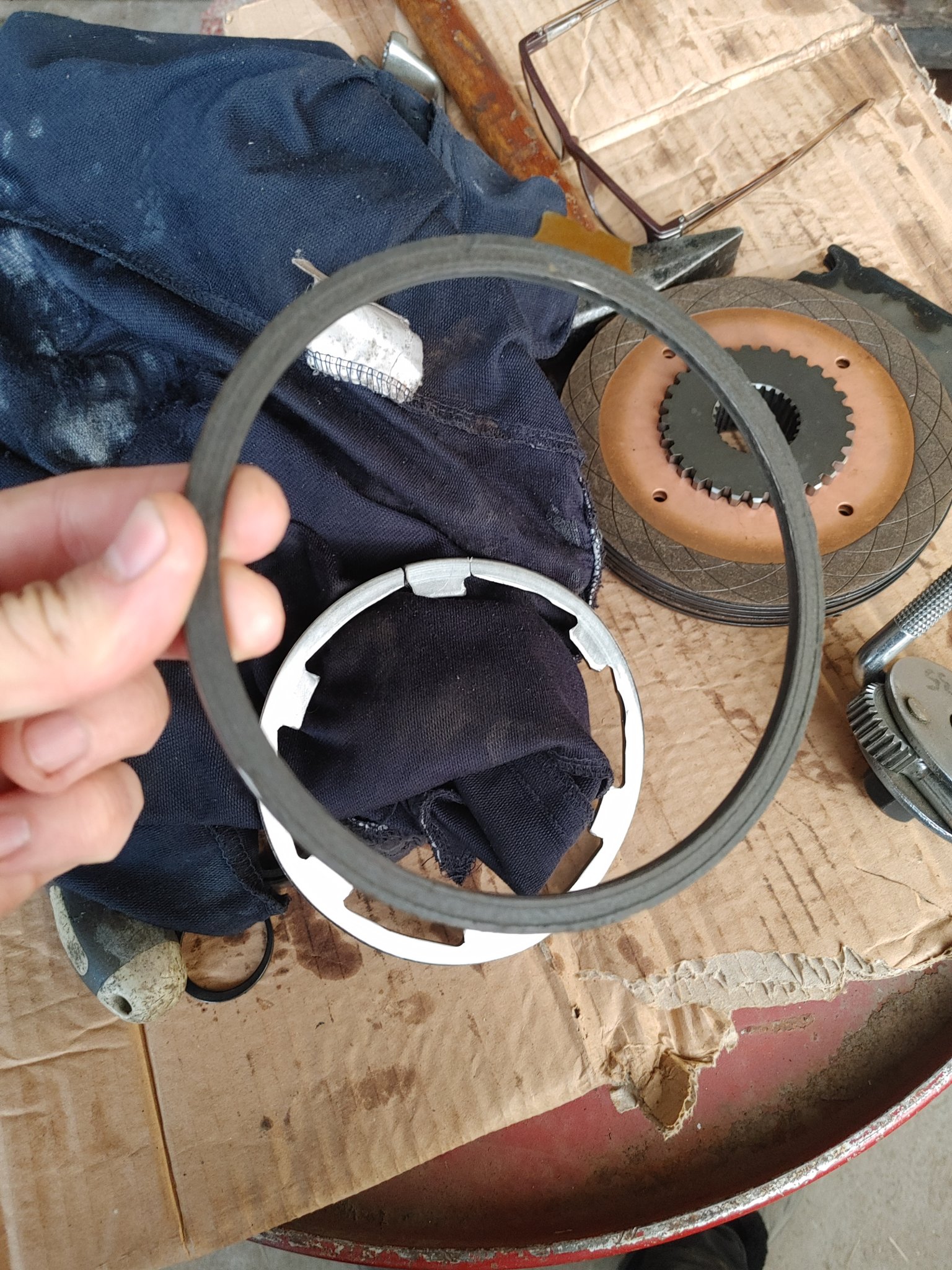

Tomorrow morning I'll start opening it, I'll send you pictures of what I'll find there

Anyway, I'll see what's there today
