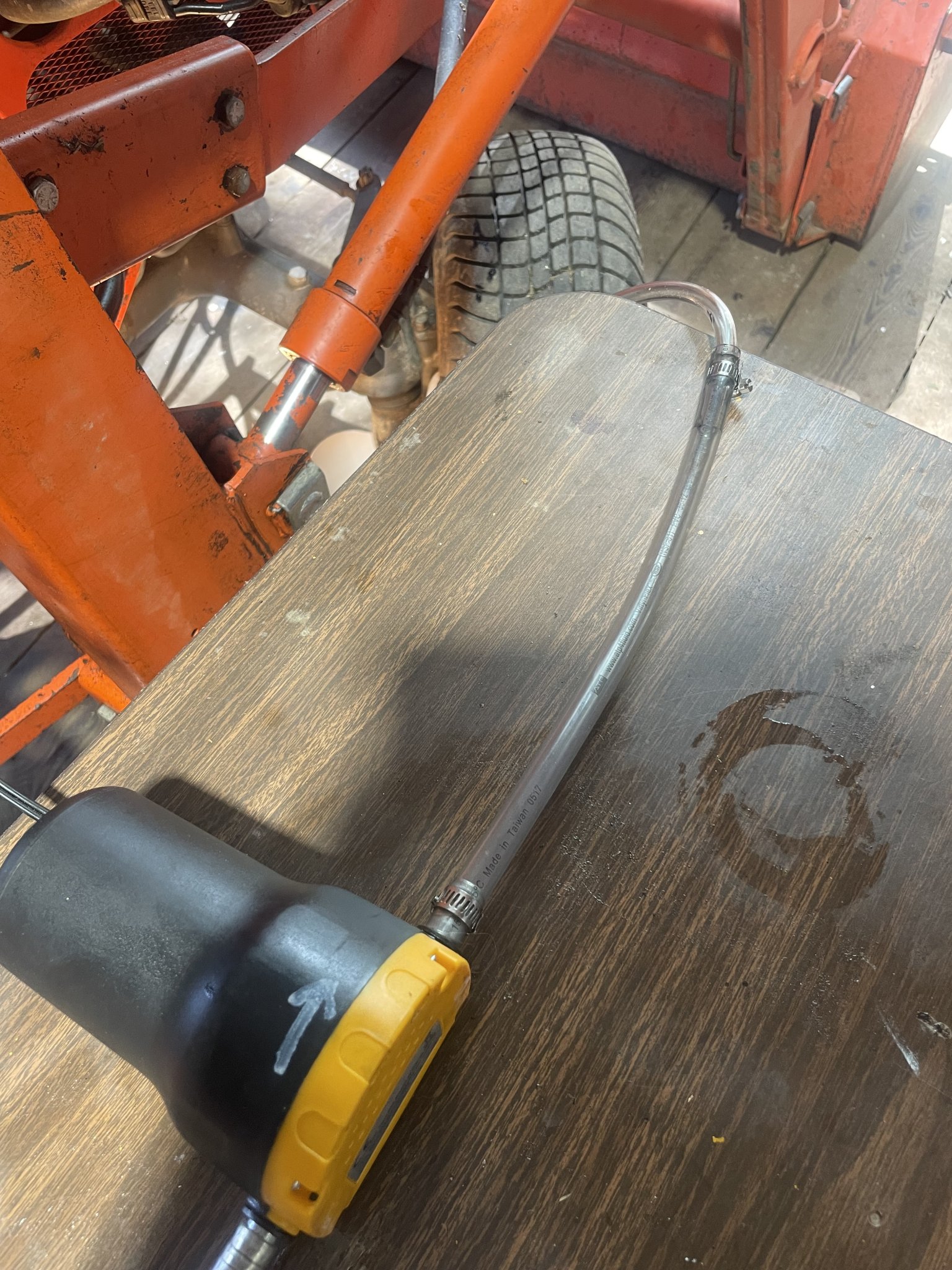

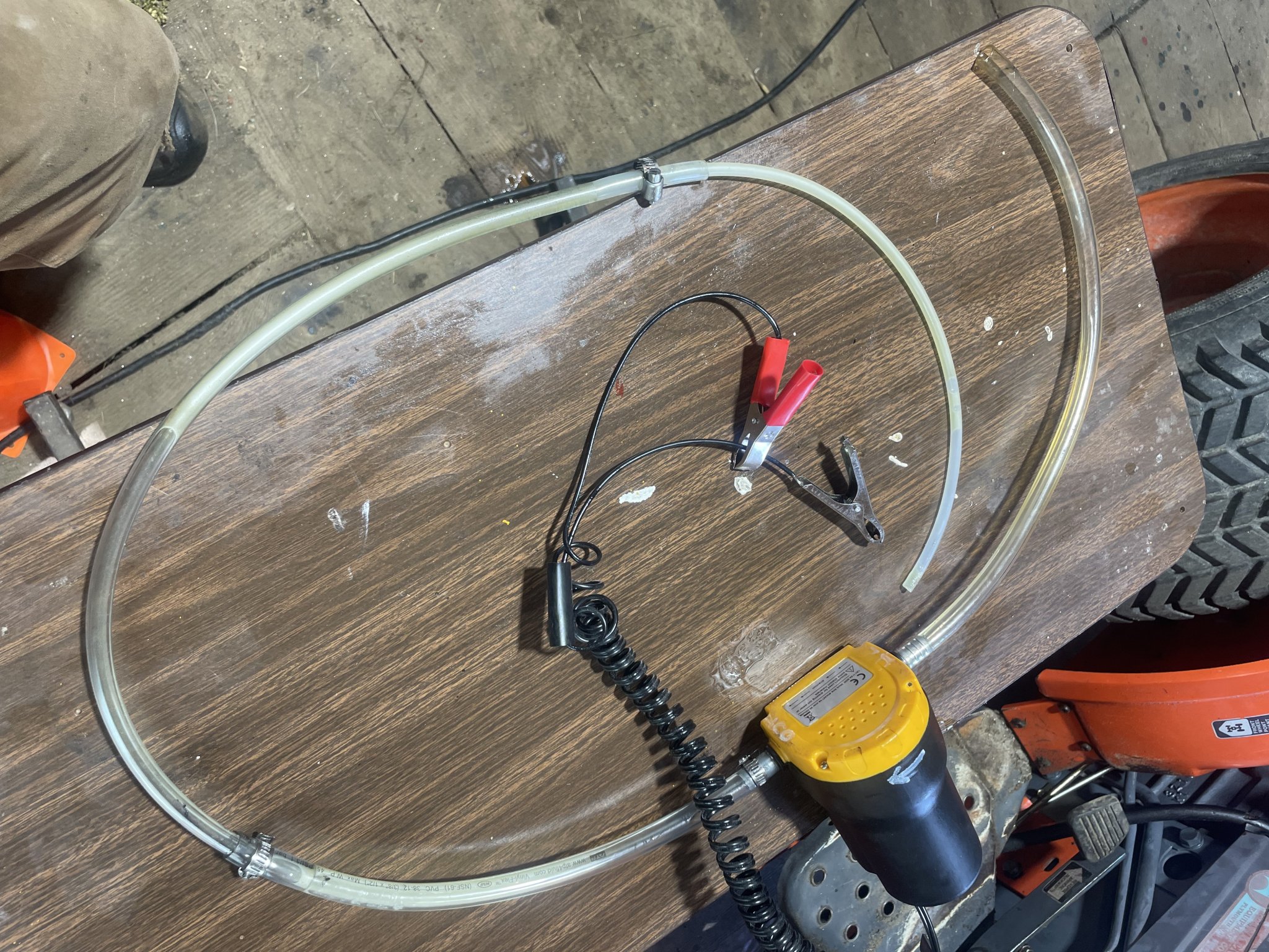

OTHER: How to fill Wheel gearboxes. I found it VERRRYY slow to use funnel and 3/8 tubing.
I tried 1/8 ID stiff poly tubing. It went into wheel sides about 1.5 inches. I adapted up to 3/8 for the small 12V DC fluid oil pump I have I use for draining truck differentials and automatic transmissions that have no drain plug. Wow - even with the 1/8" tubing it pumped .3L into wheel gearboxes in less than 10 seconds! I LIKE that. Photos follow. (I also used it for the .75 L into the differential).
What I used: (You can just see the 1/8 tubing into wheel gearboxes)
Pump at AMaZon :
HERE
Any update / Info Welcome!!

Don't use a pump to fill the front gearboxes and differential. You'll pump too much too fast and waste oil-----and get frustrated!!
Hi, What I did was premeasure the amount I wanted and put it in into a container. Ran the pump watching the level go down (fast) and shut pump off when it was all transferred,
