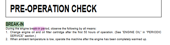

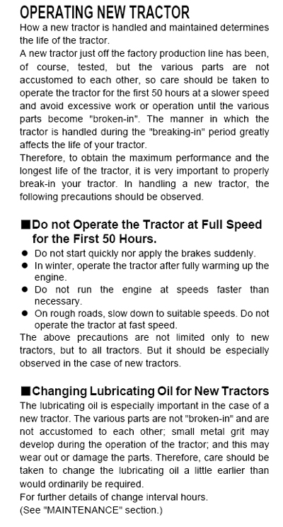

Just use it reasonably. Kubota says nothing about a break in period.
Oh really. Both of my tractor owner's manual have a section re a new tractor.
MX6000 owner's manual.
M6060 owner's manual

Funny, my K manual has a page on break-in. Just no wide-open-throttle and take it easy for starts, stops, loader operation to give things a chance to get seated. Then change oils and filters after the first 50 hours.
