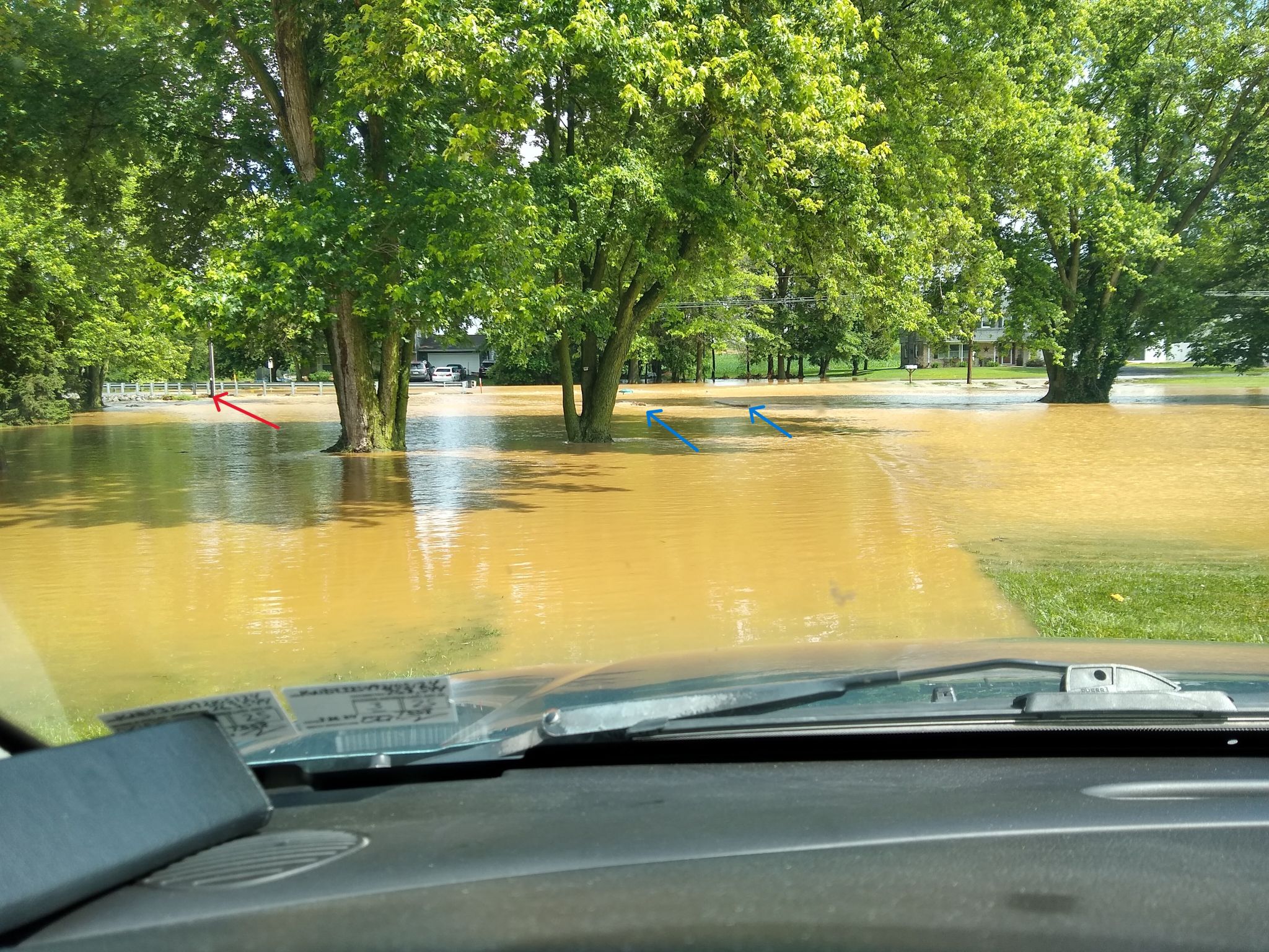

I voiced these concerns to them as the project progressed and met with them on site. I also went to their office in Harrisburg and was pretty much ignored both times. Normally I tend grass right up to the roadway all along our property. Some years we have water that flows far in excess of what can flow under the road. Then it runs over the road and onto our property. This happens anywhere between 0 and 4 times a year. With established grass along the road, the water flows over it without much effect. That's how it worked along the road where there was no guide rail and along my driveway.

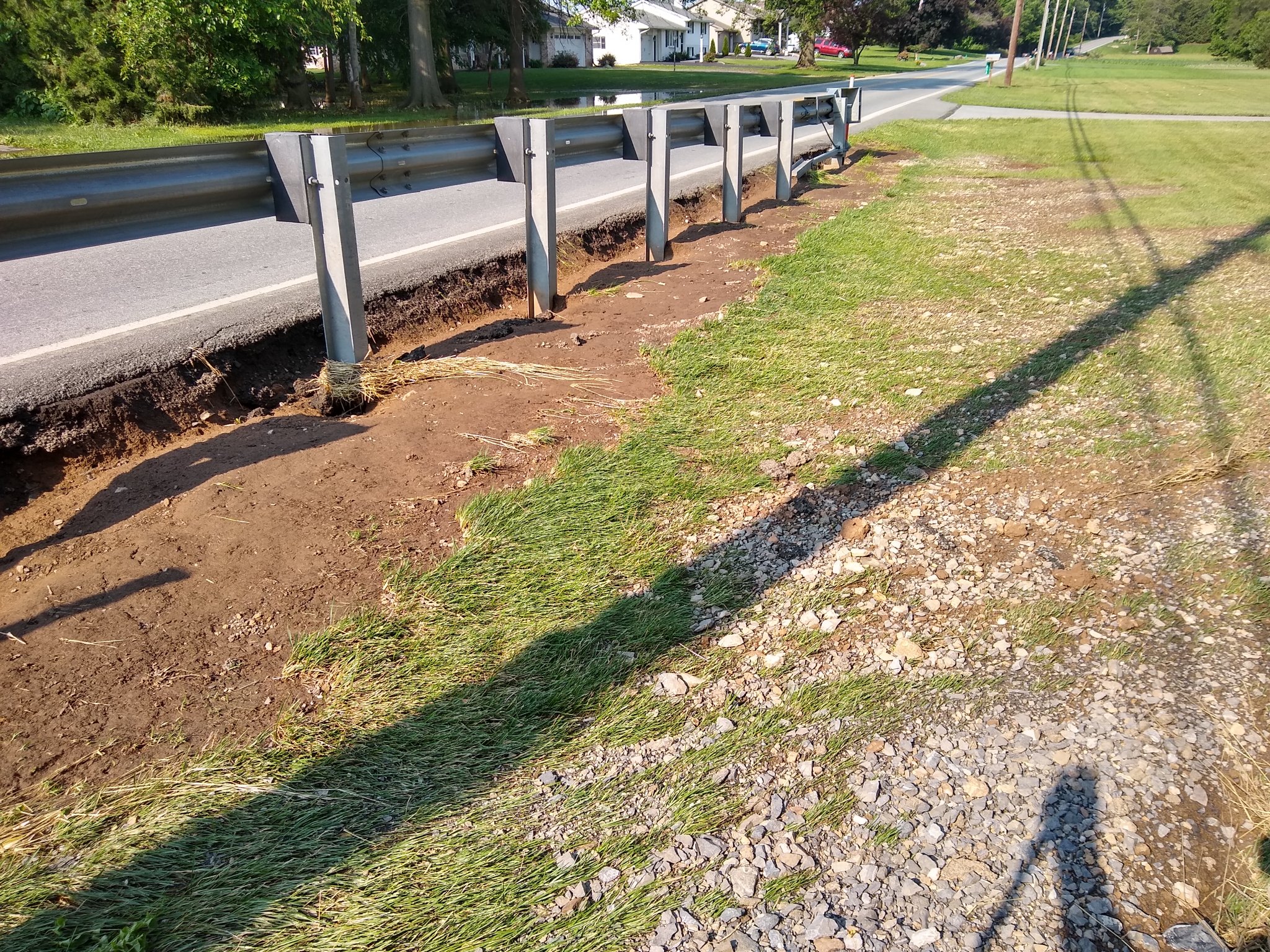

Well, this year PennDOT came along and did me the favor of spraying Agent Orange, Paraquat or some such chemical along the side of the road at the guide rail. It's been "scorched earth" there all Spring. So on Tuesday when we got the first real rain for a while, the water washed over the road. The turbulence around the guide rail posts scoured holes around them and caused the fill they placed to wash into my yard. Some of it didn't stop in the grass and went right into the creek.

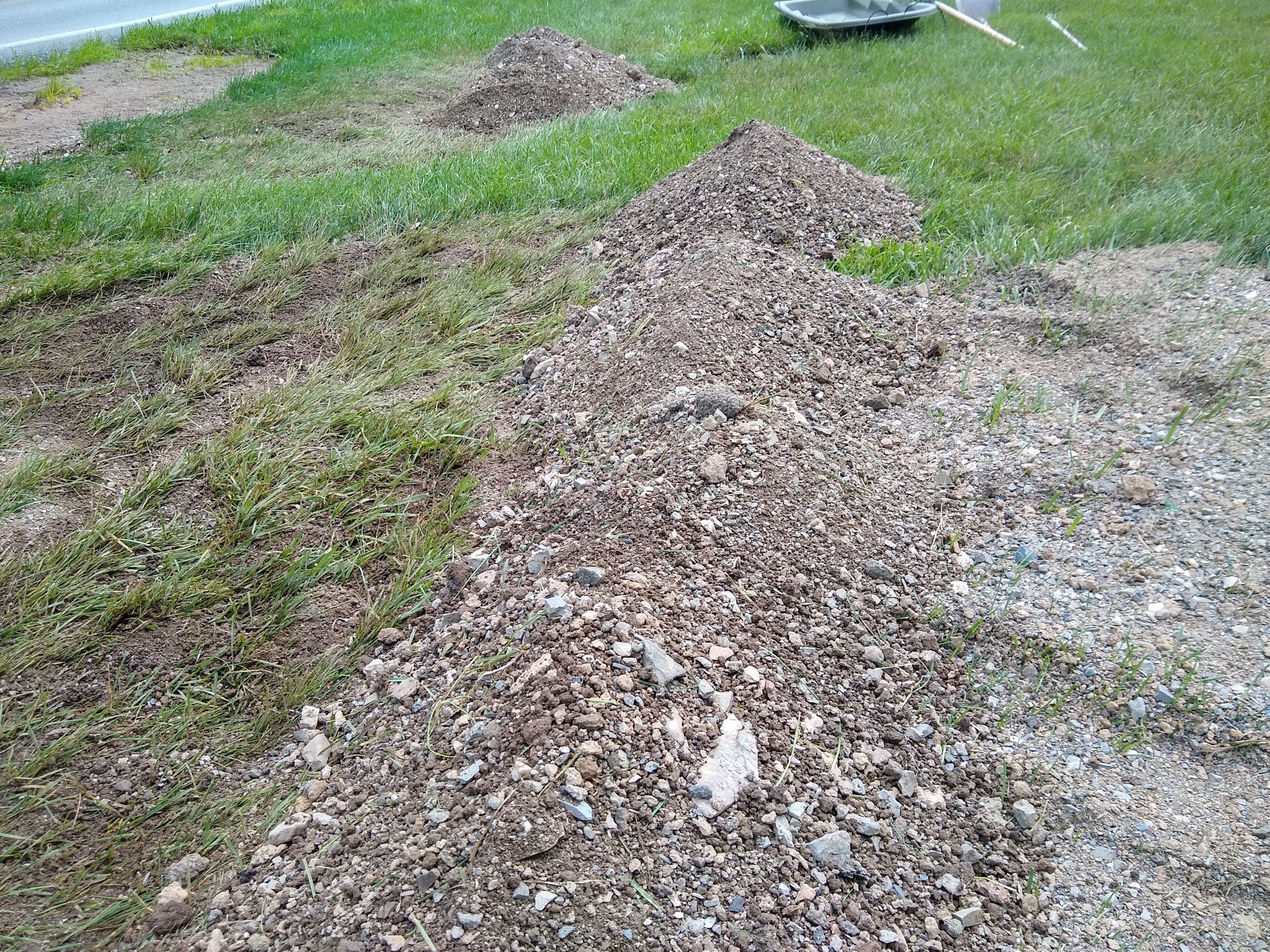

Friday was cleanup day. I spent about 6 or 7 hours removing THEIR crappy backfill from MY yard. Some experimenting with different tools, I found the best method was pulling what I could onto pile using a garden hoe. The I was able to get most of the rest with a flexible leaf rake. There were 3 and 3/4 full buckets of this stuff to haul off with the Kubota.
I've made another request for a seance with someone from the Commonwealth in hopes they don't do anything even more stupid when they come to repair the road shoulder. One can always hope. Probably 95% of the material they placed along the road will pass through a 3/4" sieve. Anyone who believes that is suitable material for backfilling along a road that floods needs to go back to school. And they should be forced to ride the short bus.

High water on Tuesday AM. Red arrow is the power pole for reference. Blue arrows are the 6" tall side walls of my bridge over the creek.
Tuesday afternoon after the water receded.
3 from cleanup Friday
