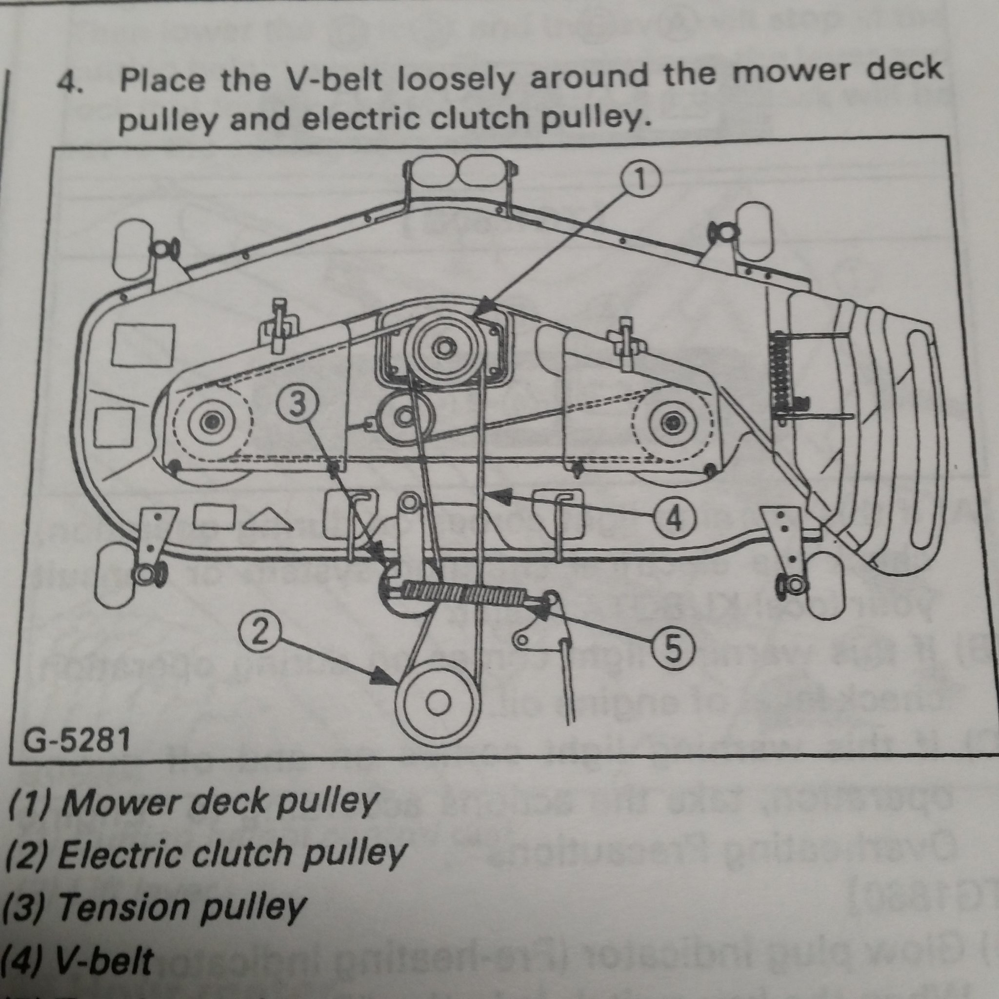

This might help you.
This is going to help a bunch when I put the deck back on!
The belt I am looking for help on is rear belt that orangekuby posted ending in 2010.png. I had to have put that thing on wrong for it to shred as fast as it did
