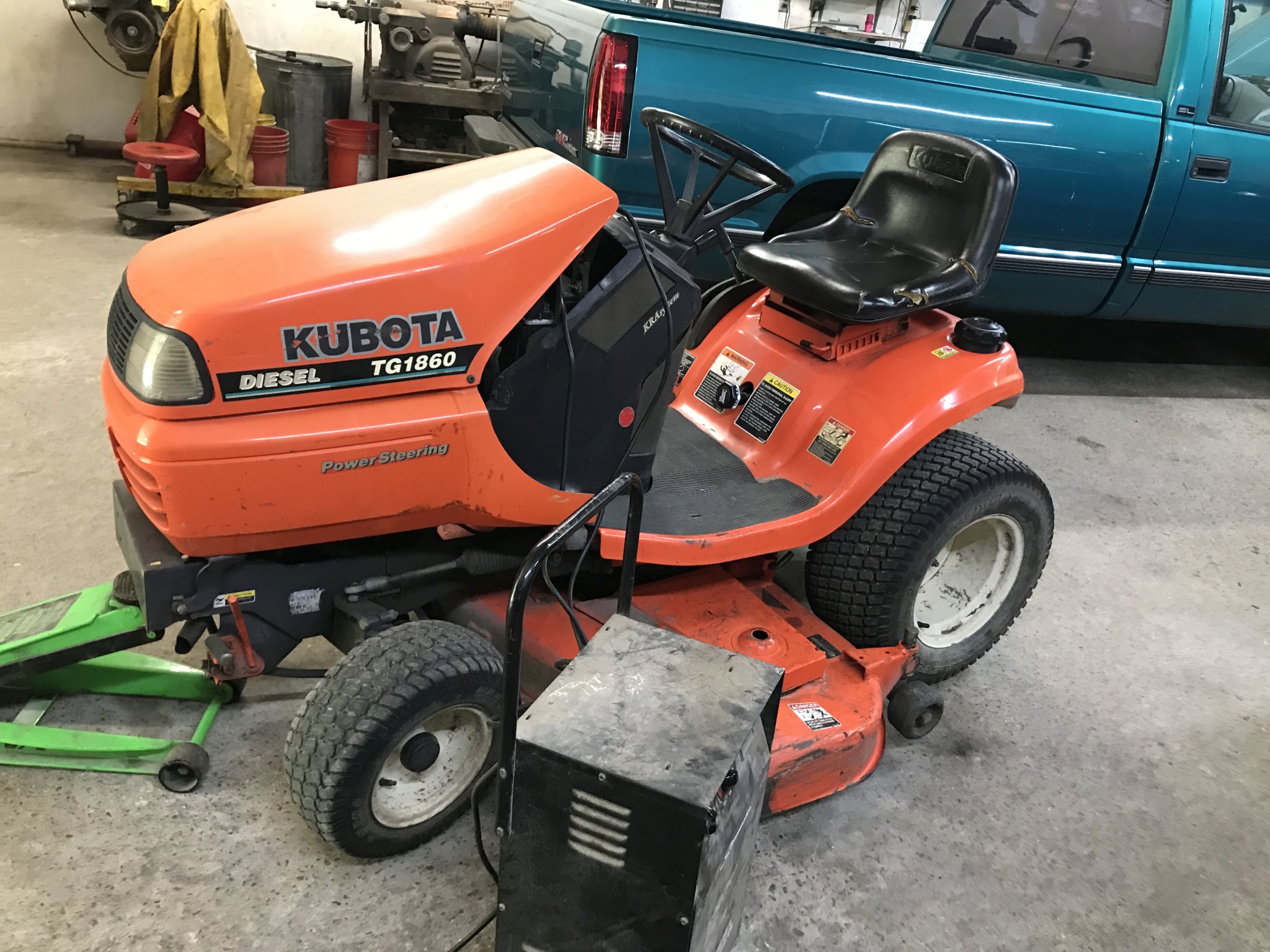

Hi all, this is something I just picked up, for what I thought was a pretty good deal. Even with 900+ hours on the meter. Needed a battery and belt according to the “second” owner.
A little about myself. I’ve been in auto repair since about 17-18 years old. I’m 67 now and have had my own business for 35 years, this past October.
The man had a battery charger and we charged the battery enough to get it started and loaded on my utility trailer. Once back at my shop I find the broken generator field and battery light feed wires. The “T” connector was missing and had been rigged with spade lug crimp connectors. Easy enough to add new crimp connectors until I come up with a real connector. One problem solved.

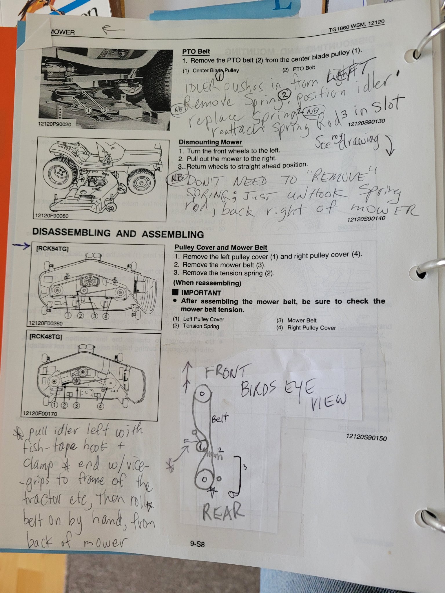

According to the parts illustrations and even a search function post here on this forum, one specifically made on June 30, 2017. Pg. 12.
A member asked a question and posted photos of the belt, tensioner, pulley, spring, rod and pivot bracket.
As anything can clearly see, why and what was the factory thinking?
The tensioner is technically being pulled away from the belt.
I just can’t grasp the idea or concept of this design. I haven’t done any further work. “Meaning” I have not put on this new belt and tried any attempts to run and mow with it.

The tensioner can go one of two ways, but it *IS* being pushed into the belt.
If I can get pix to load, I'll show pages from the parts manual and notes I've made over the last 17-18yrs of
ownership of my TG1860, which is knocking on 1000hrs

Ok, I got it lined out. Drove out to the river to check my buddies machine out. Here’s what I found without pictures. Someone back down the line had removed the tension bracket. When they re-installed it, the spring tab that faces up was installed incorrectly. The tab should be aft of the mid frame crossover, not in front. So long story short the idler pulley should be closer to the PTO.
Ve9aa, if I‘d had your hand drawn diagram, it would have been as clear as day.

Belt tensioner? It's a simple design. Not sure what the fuss is about there, but it sounds like you have it figured out. To change a belt on the 54 and 60 I take one of the gearbox brackets off (RH side). Slip the belt through the tensioner, wrap around the gearbox pulley, and you're nearly done. You'll find the easy way eventually.
