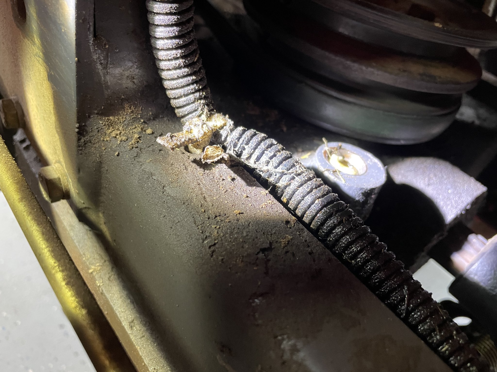

Today I rinsed off the mower before moving it into the shop to begin work. When I removed the RH deck belt-guard I found what looks like a vent hose attached to a broken off fitting. That's probably the reason for the oil splashed around. Now I'm concerned my washing off the dust and rinsing underneath I may have introduced water into the HST gearbox. :confused:
I should be doing some disassembly early in the week.

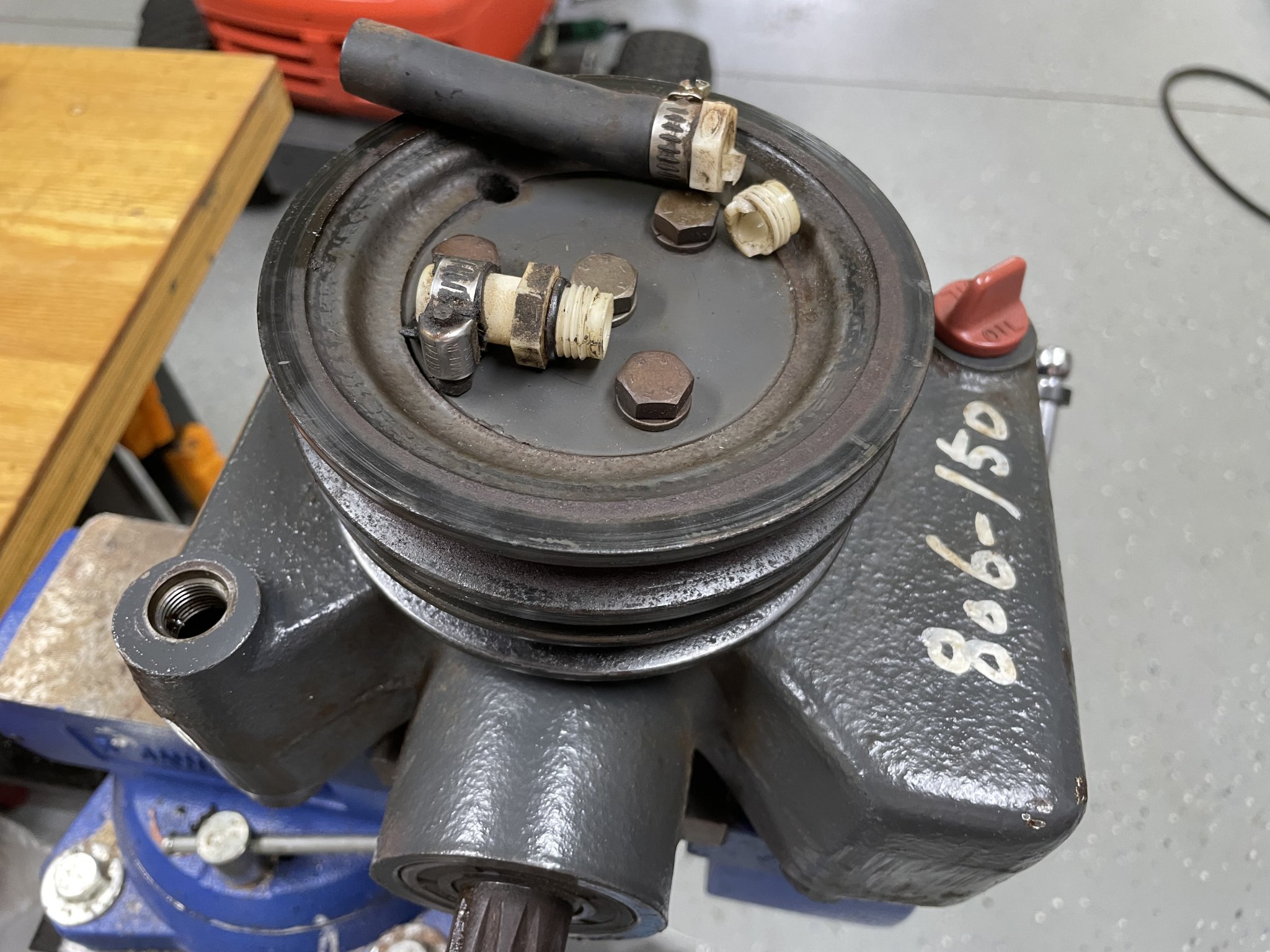

This morning I removed the gearbox with PTO and they were a mess. I scraped off the excess oil soaked crud, then brushed with diesel fuel, then rinsed with water. I still have to clean up the underside of the mower.
I was about to go to our local Kubota dealer across town to get oil, a vent tube fitting, a whatever filter to go on top of the vent tube hose and ask questions about cleaning up/out the PTO.
So, I called them first, and I get no answer. Their voicemail greeting says nothing about being closed today and tomorrow but no one will answer. So now I'm stuck here and cannot proceed until Wednesday at the earliest. :mad:
However, If I can establish what specific oil to use and maybe get the fitting at the local auto parts store, I might be able to get it back together. I do have a used vent tube fitting but it's 20+ years old and probably brittle like the other one was. If I had access to swap it later I might run with it for now, but access is very limited.
What oil for this gearbox? lmichael suggests "85W-140 I think it's from Lucas"

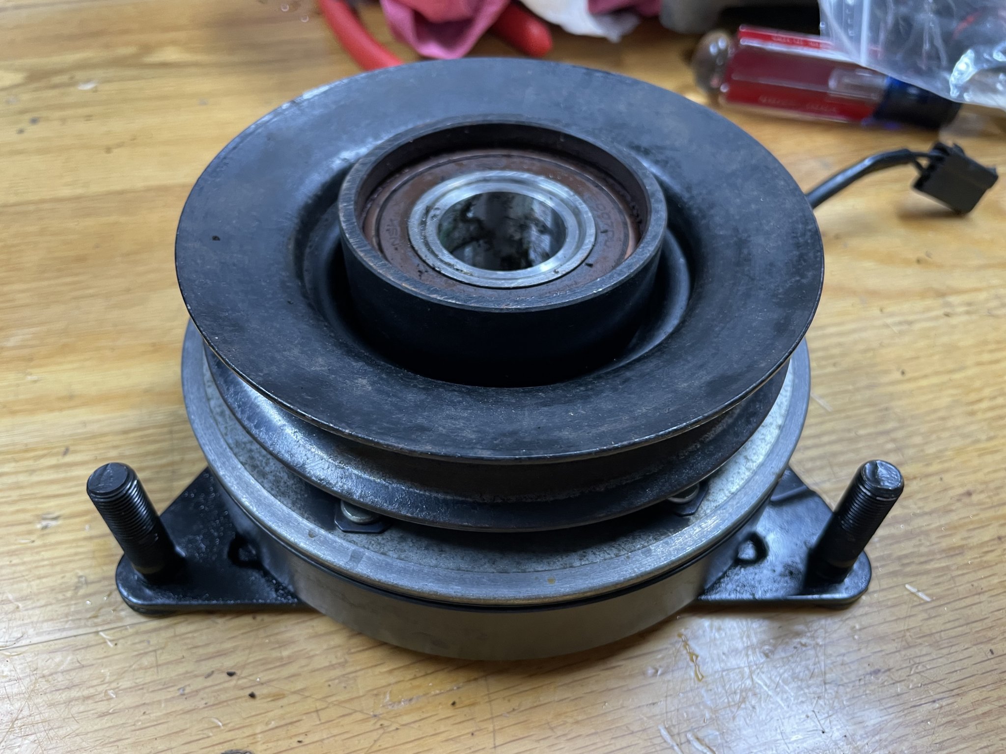

Can I soak the PTO in some kerosene, drain and blow it out, and then squirt a bunch of brake cleaner inside to clean the clutch contact plates? It doesn't seem to be made to be disassembled.
Can I test the PTO by connecting it directly to 12V power? Shouldn't I hear it click or something when under power?

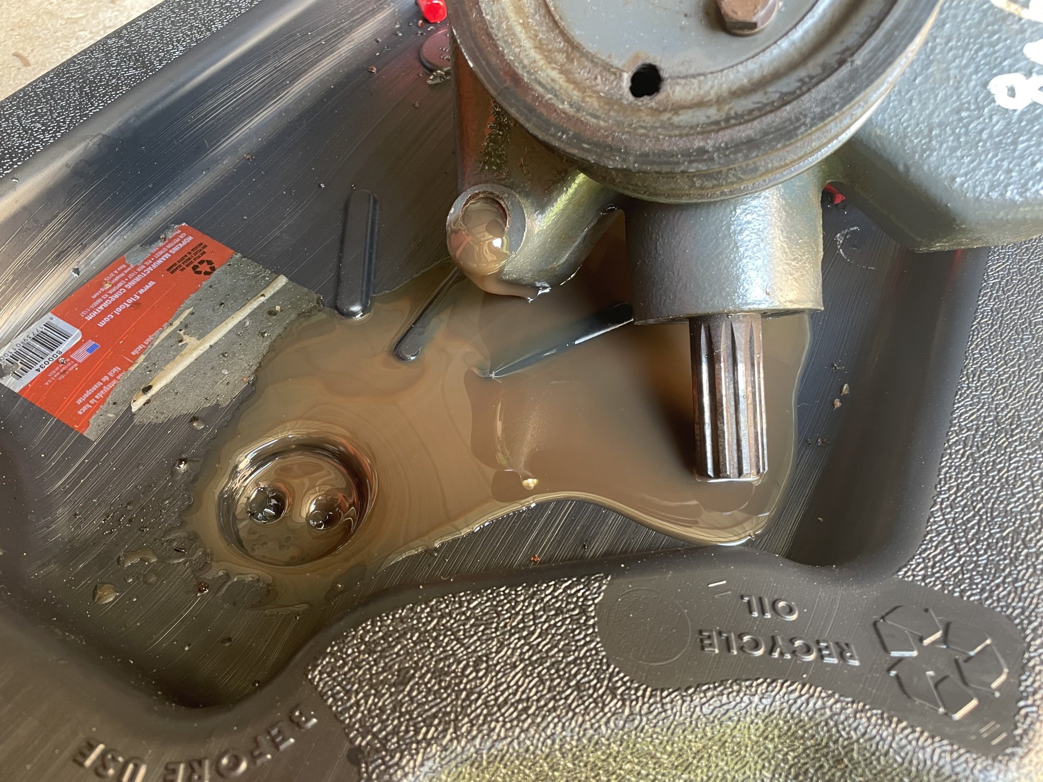

One thing to note is when I drained the oil from the gearbox it looked milky, like maybe some water was whipped up in it. I think I'll rinse it out with some 0-20, then drain it well before I fill it with whatever oil it needs.
Is there an online Kubota service dealer that might be able to ship today if I place an order?
I'm posting some pictures because this may someday help someone else who is experiencing the same concerns.

On the PTO, I wouldn't put Kerosene or diesel in there........just brake cleaner.
You don't want any kind of lubrication inside of it (more than you already have-- o_O )
Yes, put 12v on that thing and it should solidly pull in and snap. (watch your fingers)
If it does, then your issue is likely in the switch (easy to test on the bench with an Ohmmeter) or a broken wire (also, Ohmmeter). Not too much to it ! It's an off/on thing (magnetic). It'll either work or not.

I understand your aversion to using kero or diesel to clean the PTO as both of those have lubrication properties. Gasoline would be a better cleaner but it's flash point makes it dangerous to use in this fashion. I'll use the brake cleaner. I used to use something called ElectroClean to clean electrical circuits but not sure if I can get any. Wonder how it differs from brake cleaner.
I'll try the 12v direct to the PTO after cleaning. I'll bet it'll work, but hope it isn't polarized and I connect it backwards. I'll also believe the failure I was experiencing was oil on the discs allowed it to spin instead of gripping to drive the mower deck. With the mower engine running it would drown out most noises.
