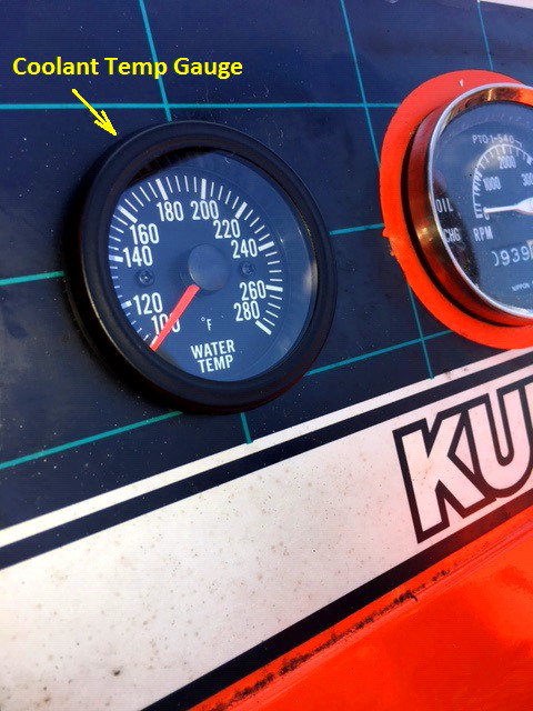

just a little unnerving to see the needle on red.
Is it possible to replace the gauge with an analog type? I've never really understood why a temp gauge would have 'windows' of operating temperature on a gauge. What does that 'area' on the gauge actually convey?
With an analog you know what the temperature is and IF that temperature is of any concern.
I installed one on my L2350DT.
