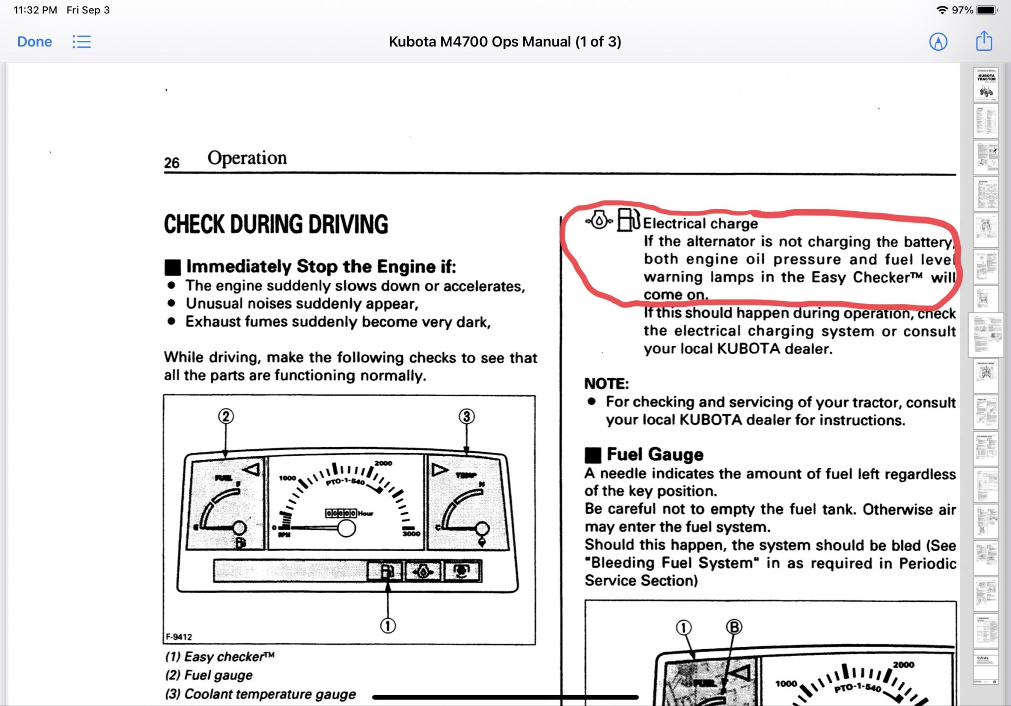

Hey ya'll my parts got backordered a couple of days but they are installed and the beast is back together. The temp gage is working fine and the ign switch great. I ran a voltage test and 12.5 is the best I get running or not. Looks like I'm going to be talking to the guys Geohorn mentioned for a new alternator.

The battery with cables off reads 12.5 with volt meter. When hooked to my charger read 12.6 at 80%. My charger has an alternator check feature on it and I clamped it on the cables. With the tractor warmed up and running the reading was 0. Not real sure on the accuracy of that old charger but that's all I got. Time for an alternator?

Since the tractor starts now,please check the battery voltage running.
12.5 volts or so would indicate the charging system isn't working.
Normal charging voltage would be around 14 volts.
An alternator is probably indicated.
Check the phone book for an automotive starter/generator shop.
They can usually fix up your old unit for very reasonable money.
Many auto parts stores will also check alternators.
Good Luck!

12.5 is a 'weak' battery(probably a single cell going bad.). Depending on temperature,type of battery and how it was charged, expect to get 13.2 or better from a good battery.
If it's 'old schoo'l ( NOT MTCE free) ,pop the 6 caps and see the level of acid in it.. could be low.
Might need to be 'desulphated', if not too far gone. Most(well some...) new battery 'chargers' will desulph, then 3 stage charge, then maintain.
Parts store can test battery....

Cole Camp Mo
OK guys, this is my final post on this thread (I hope). New temperature sensor works great, new ignition switch works great, new alternator putting out solid 14.5 volts and the low fuel light is off. Wow! Thanks to all who helped this Newby get this done I hope to be able to return the favor. And Geohorn how did you figure out that low fuel lite?
