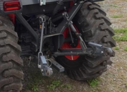

My B3000 came with the lower priced (and lower functionality as I soon learned) non-telescopic 3pt stabilizer assy. It takes a lot of patience to hook up an implement. I broke one side recently while disking and was able to borrow the setup from my brothers B3000 that has the upgraded telescopic assy. It's a joy compared to what I've got. Takes oodles of time off hooking and releasing implements. Problem is he wants it back. I went to local Kubota dealer and it seems this assy. is not sold as a kit and can only be bought a piece at a time for over $1,200. I just can't do that so I'm wondering if anyone knows an alternative approach. I've called around and searched online but I'm not finding any sort of equivalent and wondered if others might have made a discovery I've been unable to. The pic is of the assembly (or equivalent) that I need. Thanks! https://ibb.co/qFcKR6w

I want the whole assembly, which would be evident if the image I've tried to insert would actually insert, and yes I am probably not calling the pieces and parts by their proper names. I am after both the lower telescopic stabilizers and the upper leveling arm or box. Don't know why it's called a box though. I'm not seeing anything on the Agri Supply site (yet) that shows a leveling box for a Kubota.... still looking though.
I am having trouble loading images for some reason. The link worked when I first checked it. Perhaps someone can point me to a tutorial on how to easily insert images into a post..... always have had issues with this. I've tried an image upload site that provides a url to insert but the image never gets inserted for some reason.

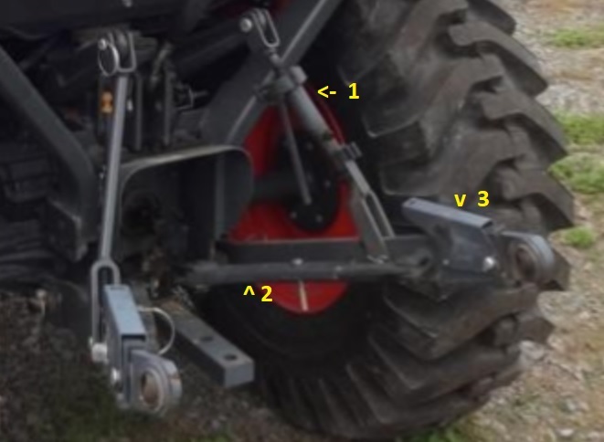

His Photo is there now and also here! Also a link how to subscribe to your thread in the other photo... (edit: added photo with numbers)
Thanks for clarifying O&T.... I swear I never noticed the 'thread tools' button. I knew it would be easy. And thanks for editing that pic with arrows indicating what parts I'm after!
