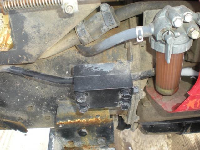

For what it is worth, I made my own block. Used the cover off of the existing block as a template for bolt holes,used a flat piece of steel a little thicker than the cover I took off, and then drilled two holes to mate up with the two holes in the stationary part of the block, tapped them 1/2" NPT, surface ground the inside flat and bolted it up and hooked up my aux. hydraulics.
lahoyer
B7100 and a bunch of attachments
Nov 12, 2010
Danbury,Wisconsin
I could take a pic of the block on the tractor but that's it. It's really simple to make. Just the block and 4 bolt holes and two for the lines. The one you take off has a port drilled/machined to allow flow through the block. The one you replace it with is basically an in/out situation. You do need to plumb this new block so that you end up with flow back through the port (open center valve). You need the hydraulics available to operate the 3 point.
