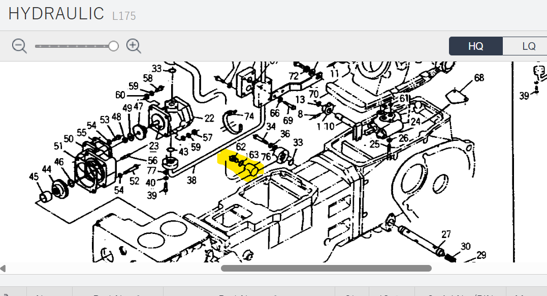

Does anyone have experience plumbing in a loader on a L175? I am trying to figure the best place to tap into for the "Tank Return" line. I am getting a "block" from Torch and have those lines figured out, but want to make sure I put the tank return line in the best place possible.

Look on the suction line and see if you have this plug in it.

You can also make an adapter for the transmission oil fill port that is like a Tee in a pipe, if the other location doesn’t work out.
