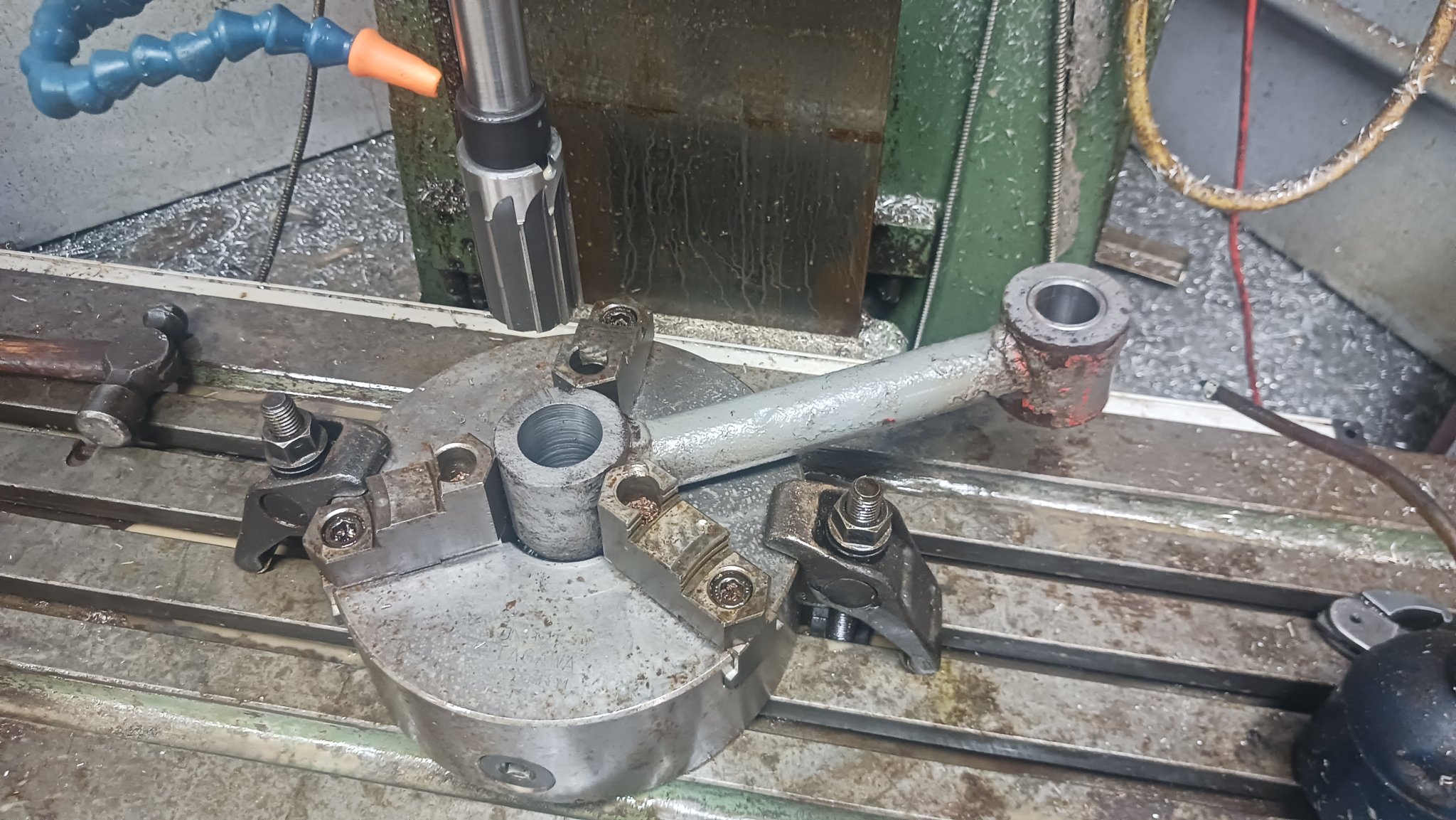

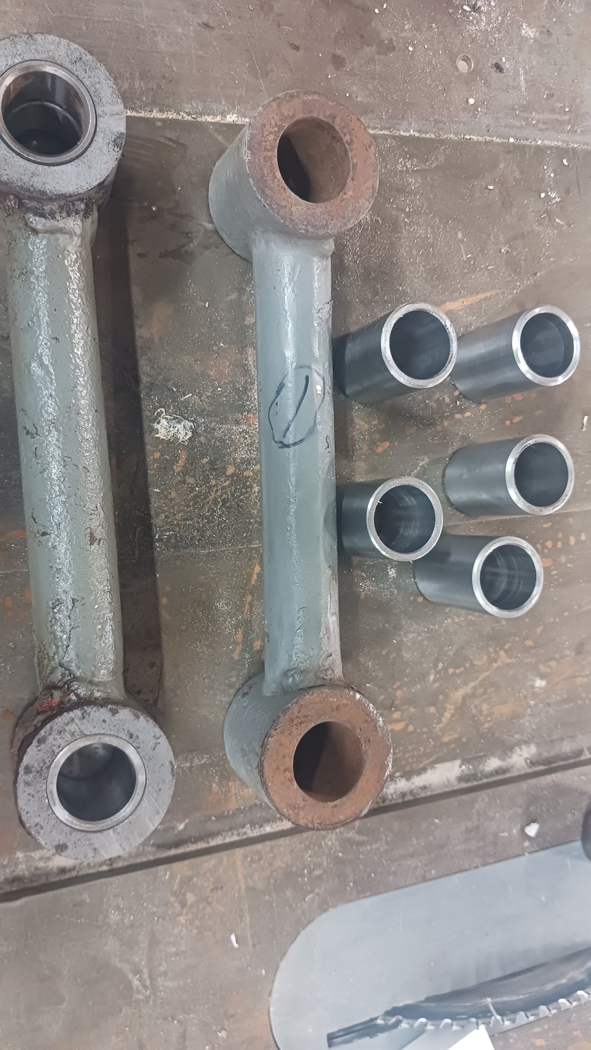

Nick Sacco had some backhoe parts that were just a tad worn and I volunteered to do a little machine work for him. Here are the new bushings he needed to replace the old worn ones that are NLA and the two very badly worn bucket links that needed to be rebored and bushed. Just one more link to bore and the job will be done.
Nick is a very nice guy and helped me out by contributing the shell reamer and arbor to my tool crib ;)

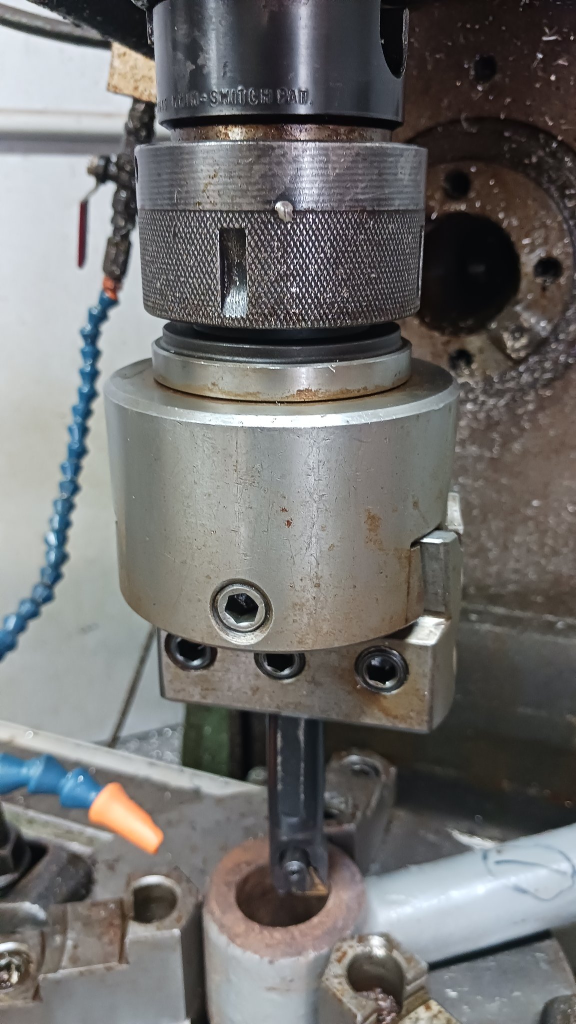

I’m trying to figure out why that reemer (if that is what it is) looks off center in the first picture…

Its not a reamer. Its an adjustable boring head and boring bar that I used for the rough cut. It looks off center because it is :rolleyes: i will post a picture of the real thing with the spindle off when I finish up tomorrow. Until then here is a stock photo.
Two passes with the boring head to rough cut to 1.475. About .100 on each pass. The reamer was used to finish the last rough cut to final size (1.500)

Of course, that makes sense. I thought the second picture was an after picture and the first picture was an action picture of what was happening before the second picture.
If I had paid more attention, I would’ve seen the first picture shaft was black and the second picture shaft was shiny

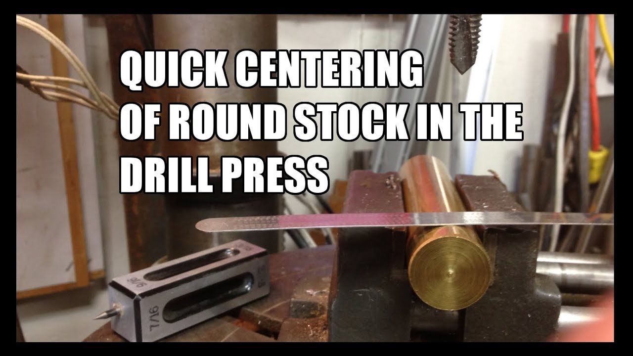

In my gunsmith days this was one of my favorite tips to quickly find the center of round stock when drilling a cross hole. Amazing how accurate it was and I always had a 6 inch rule in shirt pocket. Of course when drilling needed to be done "dead nuts accurate" I would use an edge finder and set up a dial indicator.
Not my photo, just pulled it from the net quick and I would used a center drill , not a tap but you get the idea and it was my Bridgeport milling machine.

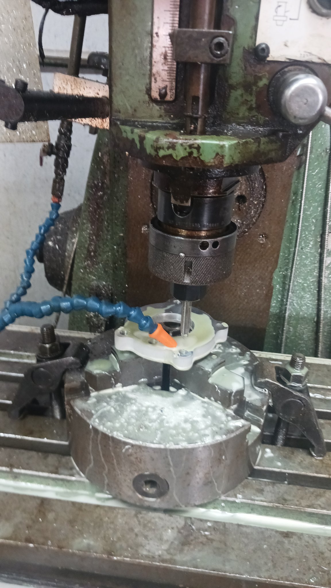

I promised @Henro a better picture of the boring setup:
And here is one showing another use for a three jaw on a milling table. Its not just cylindrical parts.
