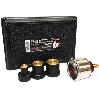

Not sure about the radiator on the machine, but this is what I use at work
(The harbor freight one looks identical)
the middle adapter is basically the only one I use for cars and trucks, don’t believe I have even ever used the biggest adapter. If I would have seen this at work I would have measured it for you.

Awesome! There is a HF nearby. We'll hit that one up. I was hoping that it went larger than what I have.

Take the cap with you, plus the O.D. of the radiator inlet to make sure the kit has the right adapters.

The HF one worked like a champ. It is the largest adapter for the TL radiator. It was one of the tubes that split. He has a new one on order but I soldered the seam closed for now. Pressure tested to 30 psi and the beast is back in action!
