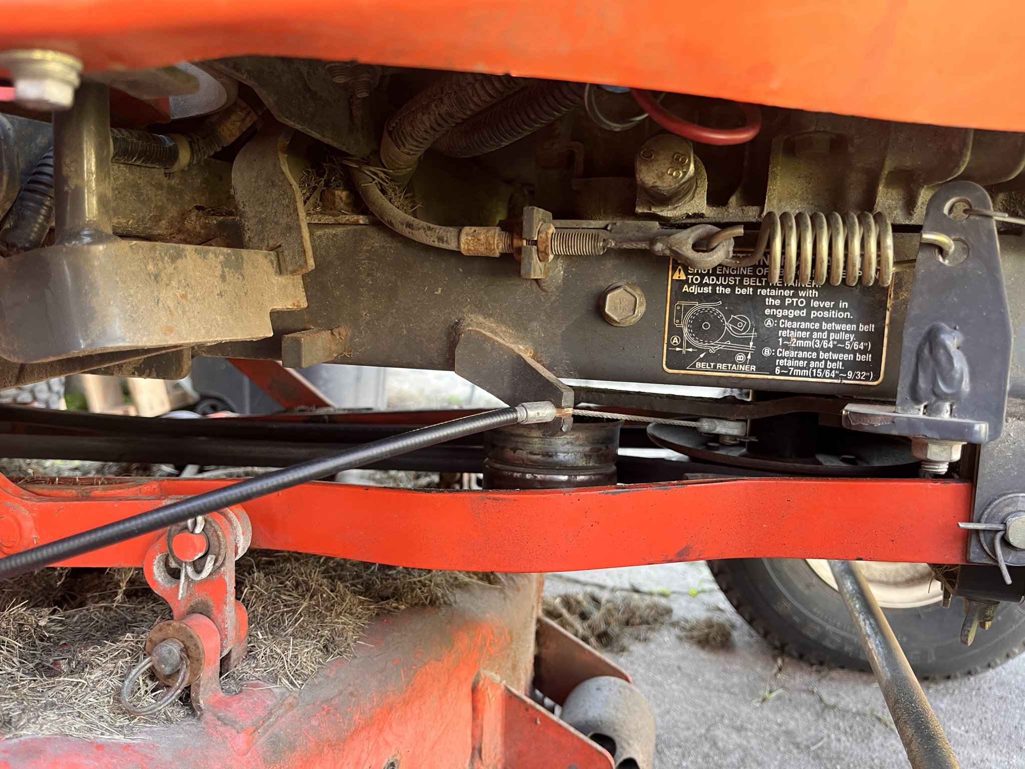

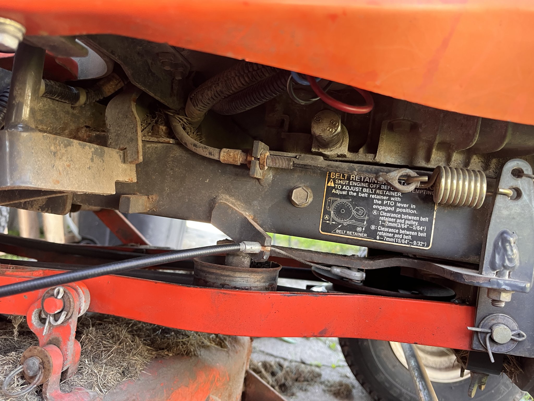

Is this the arm you’re talking about?
I’ve only ever done oil changes so bear with me

no, that's the primary belt tension arm
the secondary belt tension arm is the one I'm talking about. Have to remove the mower deck from the tractor to gain access.
