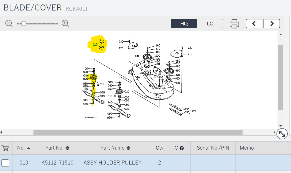

ok i got a what i think is a 1990`s kubota...serial# 36088....and a 40 inch cut 2-spindle deck....i can find all the numbers to build the spindle in the parts list, but what im looking for is the WHOLE SPINDLE part number and where to buy, havent had any luck with that yet. so any andall help is appreciated thnx bb

First thing you need to do is look for the part under the mower deck option.
I'll guess that you have a RCK40LT deck.
Kubota puts assemblies in brackets top yellow part noted.
(Part links) below Illustrated parts list!
Have nitro pills handy, 911 on speed dial, and a full filled out and signed Will BEFORE opening links!
1:
2: Colemanequip.com HOLDER--PULLEY-A/K5112-71510/

yep that looks like its it, and yes im finding that my deck number is RCK40LT also...and i in no way got that from the parts list until u explained it thnx, and dont worry ill be back :) next thing im looking at and for is bearings for the double pully in center of deck but ive found them just got to hunt for best deal. thnx bb
