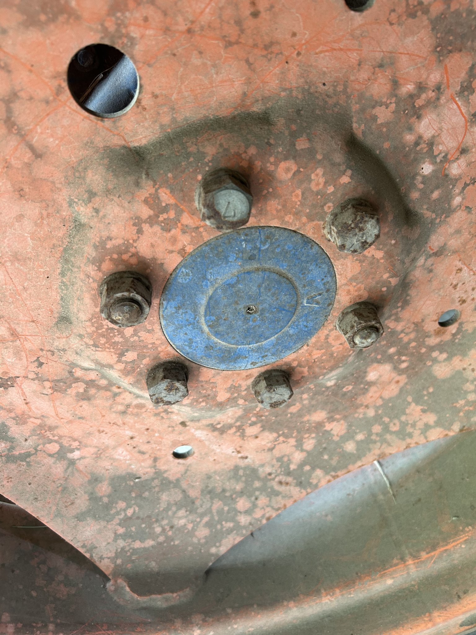

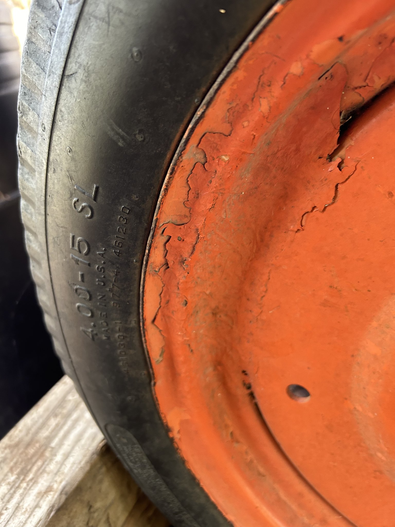

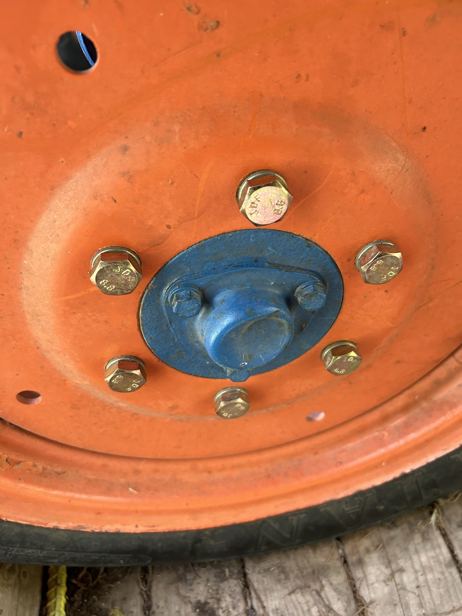

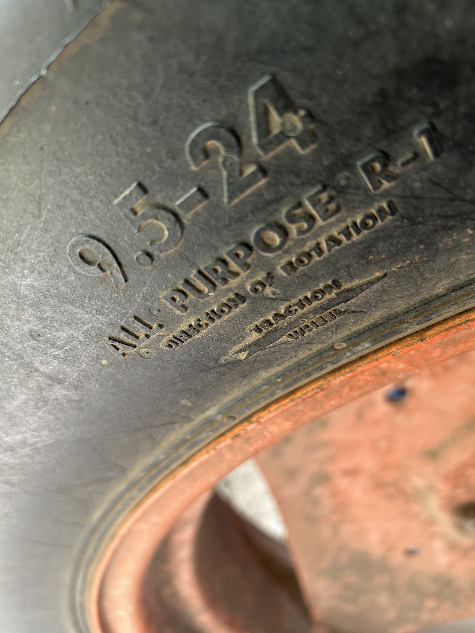

I will look at my L185F and see what size it has. It is AG tires and I would prefer Turf so maybe we can swap rims.
One of the front rims is damaged somehow (covered in some fiberglass repair from previous owners) but holds air fine.
Would you be interested in swapping if they are swappable?
6,815
2,355
Fronts are 4.0-15 with 6 bolt holes. Last photo shows the “repair”.
rears are 9.5-24 also with 6 bolt holes
