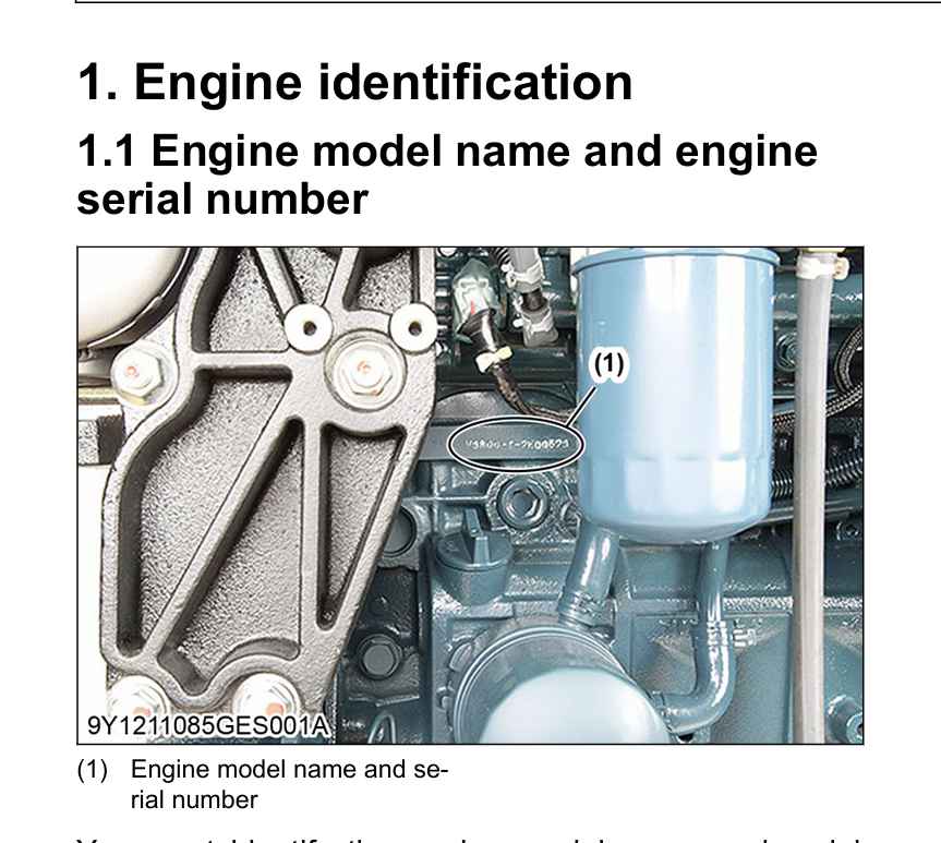

Units serial number?
Engine serial full serial number?
34,774
10,041
I think on that model it should be on the valve cover white tag not the black tag.
There is a flat spot on the side of the block that will also have the model and serial number.
It should be on the intake side, right below the head and back by the flywheel.

I will go to the shop and get the serial numbers around lunch time tomorrow. I know the skid steers serial number should be on the front right below the door. Where is the easiest place to find rhe engine serial number ?
The engine serial number is on the same tag below the cabin entry door.
34,774
10,041
You need to get the model / serial number off the engine.

Can't see any numbers where they normally should be. I am probably just overlooking them.

Really need the engines serial number, they all have one.
Left rear or right front just under the head mating surface.

His SVL95-2 is serial number 34889, and his engine serial number is 2HA2810, according to the PIN plate picture he posted. His picture does not show the LH part of the tag where it says engine serial. ;)

Would the 2HA… serial number be stamped onto the crankcase somewhere? I assume so but just want to know. He seems to state the engine is different so maybe the engine serial number on the block will NOT match with the stamped tag.
Yes I understand the tag, but if the motor has been swapped then I would really like to know the actual engine thats in it. ;)
