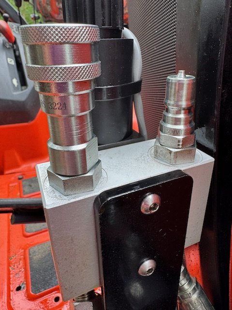

Recently having a leak at the top fittings ..... where the quick connect fitting screws into the aluminum body.
It uses an o-ring at the base.....
I've tightened it as far as it will go, o-ring seems good.... but still weeps.....
anyone else encounter a similar leak?
I have been guilty of pushing the button in the wrong direction occasionally... putting line pressure into the system... trying to get better about that....
anyway, I don't like the o-ring seal design... seems like a bad design for a pressurized hydraulic system....
I'm gonna take it apart today and see if I can put some thread sealant on it....

Thats an SAE-08 oring boss port and the gold standard for hydraulic system pressures up to 9,000 PSI.
Tighten the coupler to 40 lb-ft. If it still leaks replace the O-ring. The orings are specials used only for ORB fittings.
Thread sealant on an ORB fitting will do nothing except make a mess and possibly contaminate the hydraulic system.

Thanks Dan
I cut the grass this afternoon so I finally had a chance to take it apart since the loader was off....
I cleaned it up and socked down the bottom fitting to 40 ft-lbs and it seemed to do the trick.
There is also an o-ring on the other end for the pioneer? coupler
. I believe it's a JIC
looks like a smaller or I should say "thinner" o-ring.....
anyway... lookin good for now.
appreciate the tip and info.

If the adapters have orings on both ends they are ORB to ORB. JIC fittings do mot have orings.
yeah I thought that was odd....
I looked up the kit....
It says the couplers are NPT
I should have taken a pic while the fitting was apart..... but it stopped leaking so thats all that matters.... for now.

NPT would have been my first guess but no orings on them either.
