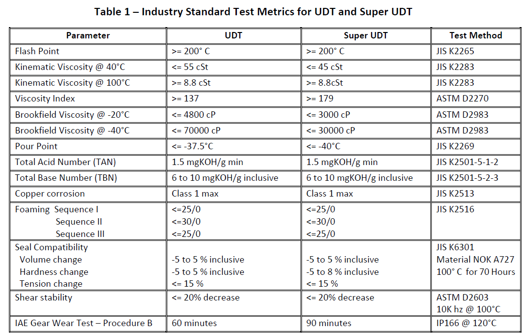

An SDS does not even qualify as long grrass let alone "the weeds".
How much of this did you find in that SDS?
1997-09-08
Development of High Performance Transmission/Hydraulic Fluid (KUBOTA Super-UDT)
Establishing the Specification and New Test Method 972788
Eodman
Kubota M7 152 Deluxe, Kubota ZD1211 72", Kubota RA212CR, New Holland TD 5050
Very little testing data listed in the MSDS, it was just how I looked up the company (Valvoline) that was making it for Kubota.
Found some of their test data later, but since it didn't compare and contrast with other fluid, it really didn't seem that it was that important since it was already proven as a superior fluid for Kubota Equipment. Though in their testing between their own fluids, they didn't seem to change much from UDT to SUDT except for the viscosity Index and the pour point which is directly affected by viscosity.
The engineer I spoke with at Lucas stated the reason he didn't have anything he could recommend was due to the High Viscosity Index of the Super UDT. It appeared to him that Kubota was tweaking the original formula to accommodate equipment in colder climates.
11,496
6,517
The Amsoil engineer is partially correct. If you read Kubotas .test report they tweaked the formulation in two areas;
They lowered the base kinematic viscosity slightly (both KV40 and KV100) while increasing the viscosity index The goal qas to increase low temperature flow through the hydraulic system at cold startup. The qualifying test is a 5 minutec timed flow through a hydraulic filter at extremely low temperarure.
They added a water tolerance requirement which seemed to be aimed at humid climates. They specifically mentioned Asia and rice paddies :rolleyes:
There are multiple qualifying tests for water tolerance
  1. The oil has to absorb 1% by weight water without emulsifying, additive percipitation, or forming free water.
  2. The oil has to pass a longer humidity cabinet test.
  3. The oil has to pass the SAE brake chatter test after being mixed with 2% by weight water
