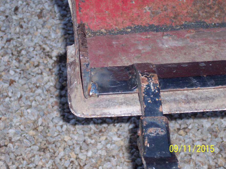

wchp12, I bought a 78" toothbar at 7 Highway Auto Salvage for $25. It had the heals of the teeth torched off. I shortened the bar and attached to my 60" bucket. Then added some iron back to the heals to make sure it would catch the lip of my bucket good. Total of 2hrs. work.
