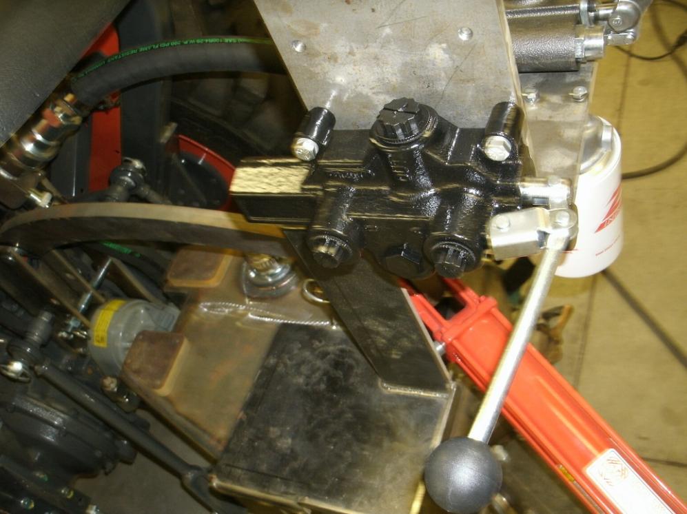

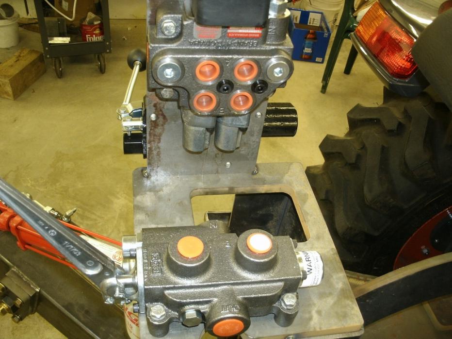

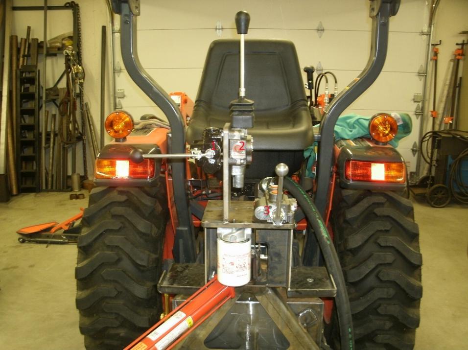

This is where I'm needing advice. Valve #1 is a motor spool valve, obviously for running the hydraulic motor. There is no power beyond on this valve. Is there a way I could still power the joystick (#2) and the boom extender valve (#3) ??
The other thought I had is using the PTO pump just for the motor and running the others off of the tractor hydraulics by adding a rear remote.
Hoping somebody can help me with this.

Can you tell by looking at them? The other two valves had no literature with them.
How many ports are on them, other than the work ports? What are they labeled?
It's very hard to offer specific advice without specific information.

Maybe with a few close up pics of each valve, we could design a diagram. We will have to know how many ports on each and if they are labeled.
I would say that one would want power at the motor spool valve first, then the up/down/left/right boom valve, then the boom extender valve. But since your motor spool (let's call the MS) valve doesn't have PB, that would be a problem. But, maybe you could put a "T" in, splitting to the MS and boom valves (with boom valves hooked in series). Then put a relief valve on the PB of the booms valves. That should give power to the MS, without anything blowing up. IF IM WRONG, PLEASE SOMEONE CORRECT QUICKLY.
I can draw a diagram of my idea if needed. Just let me know.

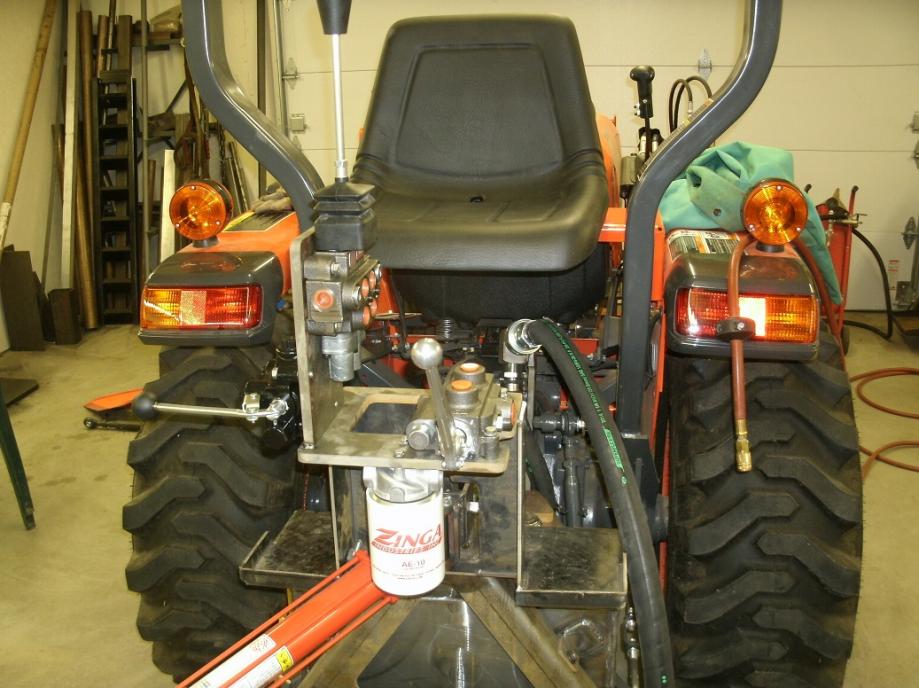

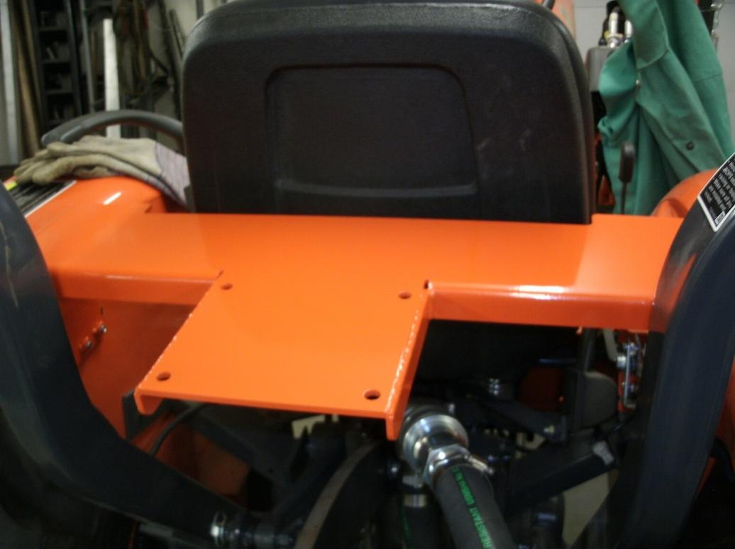

Found some Kubota orange powder from a place called Powder Buy the Pound and used it to coat the seat mount. Matched pretty good. Not a cheap date, though.
Working on dialing in the valve mounting so I can begin to plan the hose routing. That motor spool valve...still deciding if it stays or if it goes.

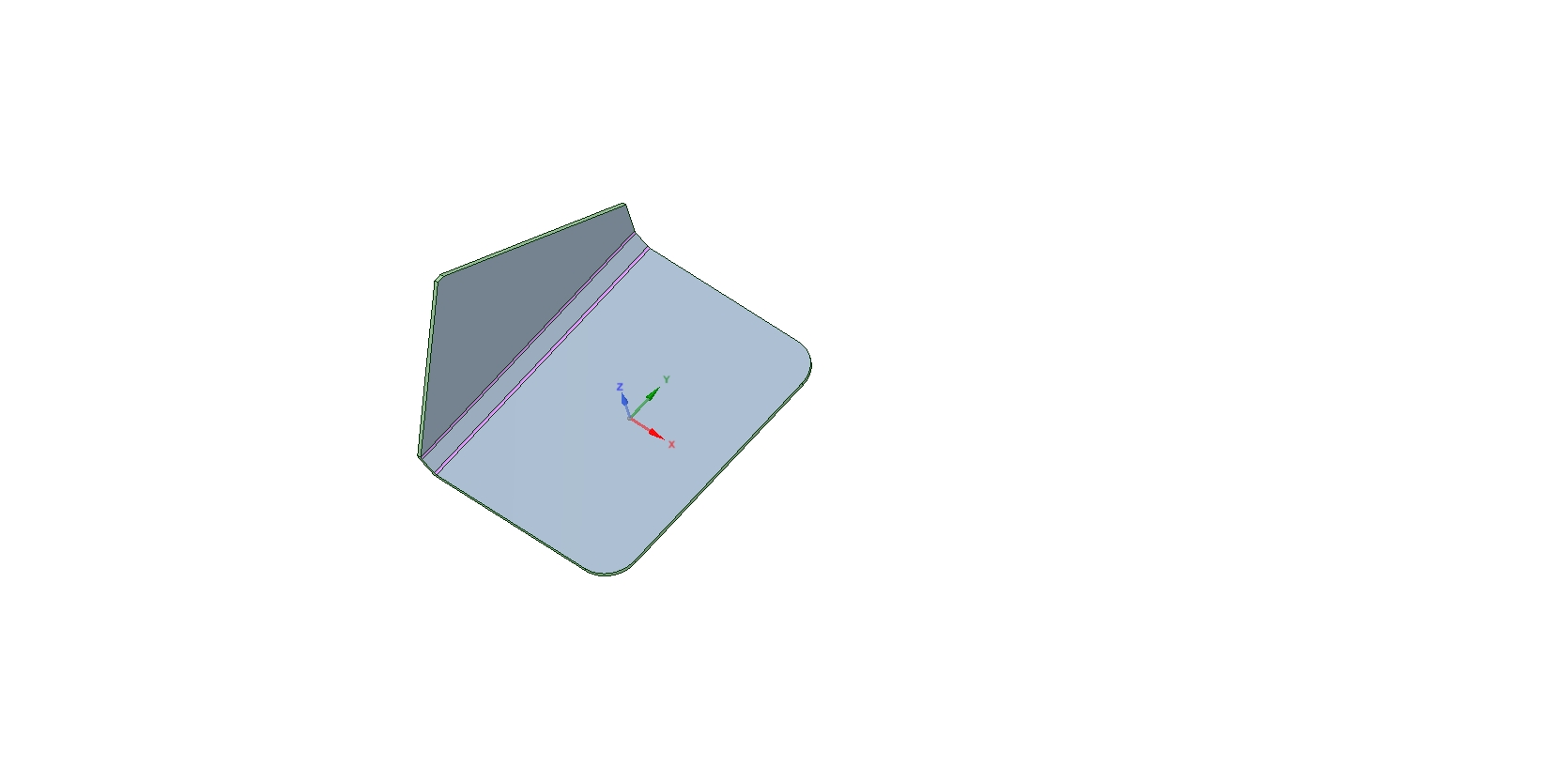

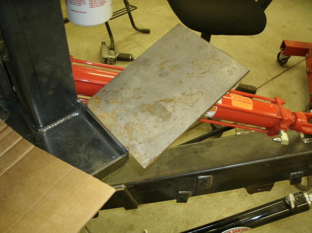

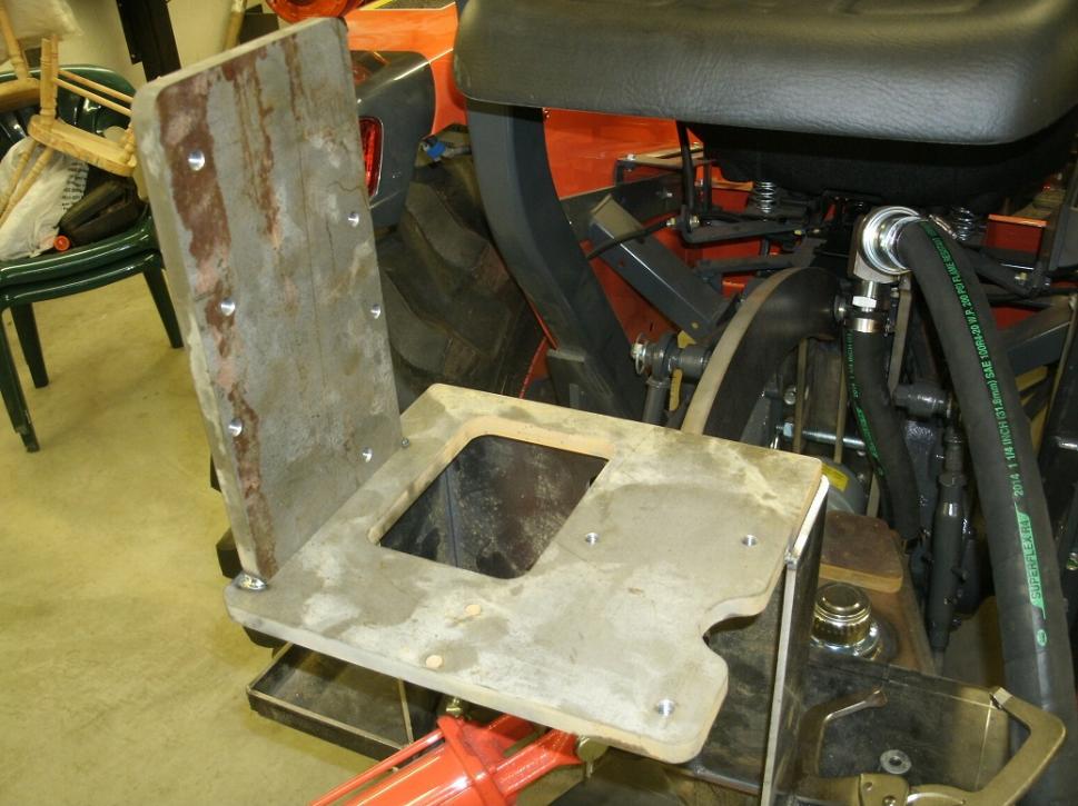

Just sat down and made a list of miscellaneous things I want to get done. I'll work on these as I'm working through the hydraulics set up. Foot rests were one of the things on the list and I found a plate that I tacked on to establish the angle and clearance for the raise cylinder. The foot rests will not only be for comfort, but also for safety because my foot could get pinched when swinging the boom.
