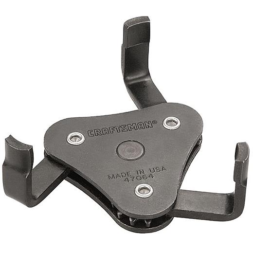

Looks like a spanner wrench would help remove that.
I have used my adjustable oil filter wrench several times to remove those. I put a good 3/8" extension and 3/8" ratchet on it and they always come loose.
http://www.sears.com/craftsman-univ...1x000001&kpid=02820523000&kispla=02820523000P
Sometimes this wrench will partially collapse the end of the filter, but it always has come off.
Thanks for that info. I'll get one of those for next time. I almost used a full-chain wrench on it this time, but I didn't want to damage the filter in case I would have had no choice but to leave it on. Thankfully, I did get it off, but I'm getting one of those spanner wrenches. I love tools! :D

When all is said and done, yes ChannelLock is tops, but this is what took that filter off. Sears Craftsman Universal Oil Filter Wrench. Use your 3/8 inch square driver ratchet or your 3/4 inch wrench to turn the oil filter wrench effortlessly.

Glad my suggestion helped you Justacafe, I have used that thing for just about everything and NEVER had a problem. It will go down to the little tiny BX oil filters and all the way up to the largest M series hydro filters, and everything inbetween!

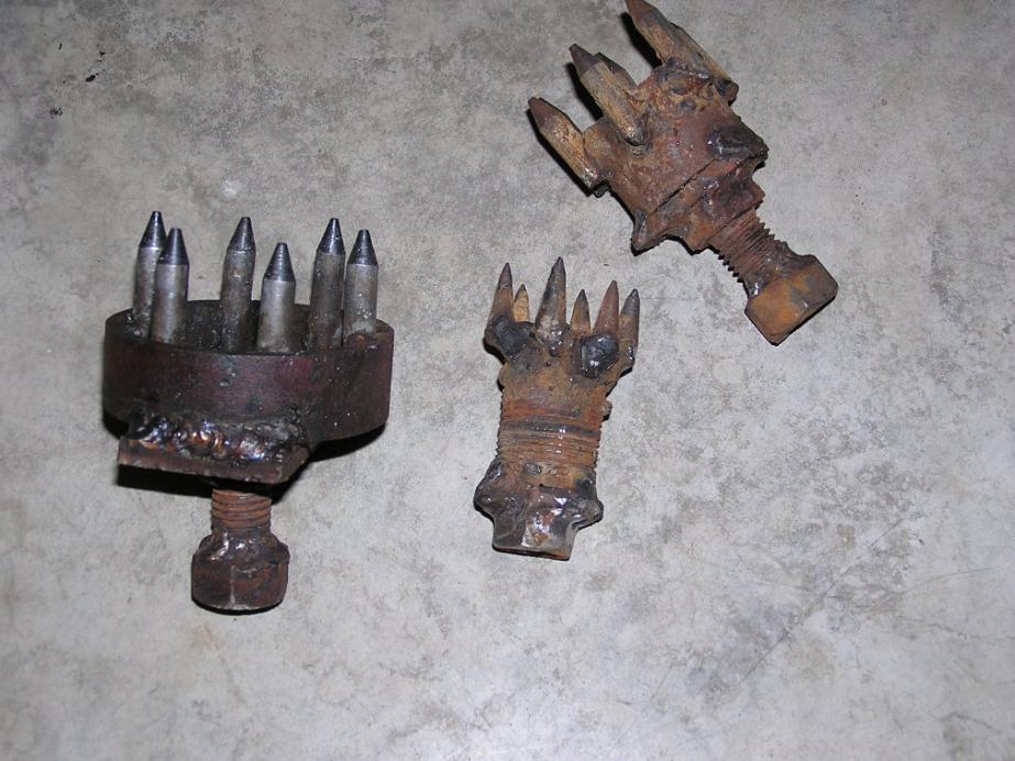

Having had just too much trouble especially in tight quarters, i put my lathe to work and with the welder made these. They work great. Using pipe wrenches, channel locks collapse the thin metal, but you give the thing a rap to mark where the pins go and then with a punch make the holes, followed by pounding this in, nothing stops these tools. Make up a few for different size filters.
Those are darned near medieval! Awesome!

having had just too much trouble especially in tight quarters, i put my lathe to work and with the welder made these. They work great. Using pipe wrenches, channel locks collapse the thin metal, but you give the thing a rap to mark where the pins go and then with a punch make the holes, followed by pounding this in, nothing stops these tools. Make up a few for different size filters.
kool.....!!!
Awesome set of tools. Years ago we used to stab a screwdriver through the filter and twist to break it loose.
The worst I came across was a situation where I had to cut the filter off literally using a small set of bolt cutters to nibble the filter off and using a chisel to smash off the remaining flange. The screwdriver approach just ripped through the housing.
