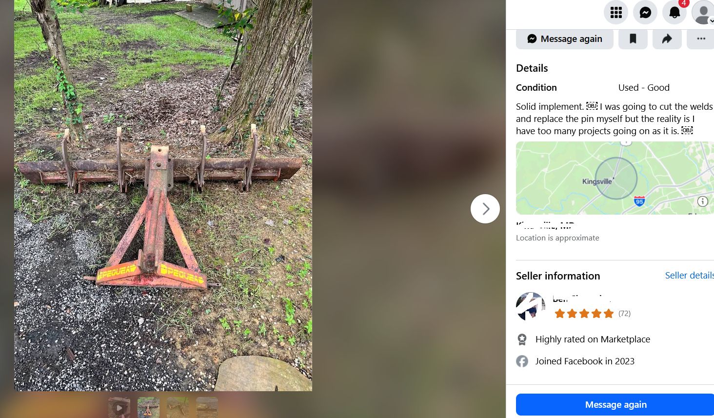

Long story but after considering different implements to solve a problem with too much dirt one place and not enough in another a search on FBM led to buying the 84" Pequea blade below. It has height-adjustable scarifiers that flip up when not needed. The seller provided a very good description and the final price was $270. The seller said that the PO welded it so it wouldn't rotate left / right. It does tilt left / right OK.

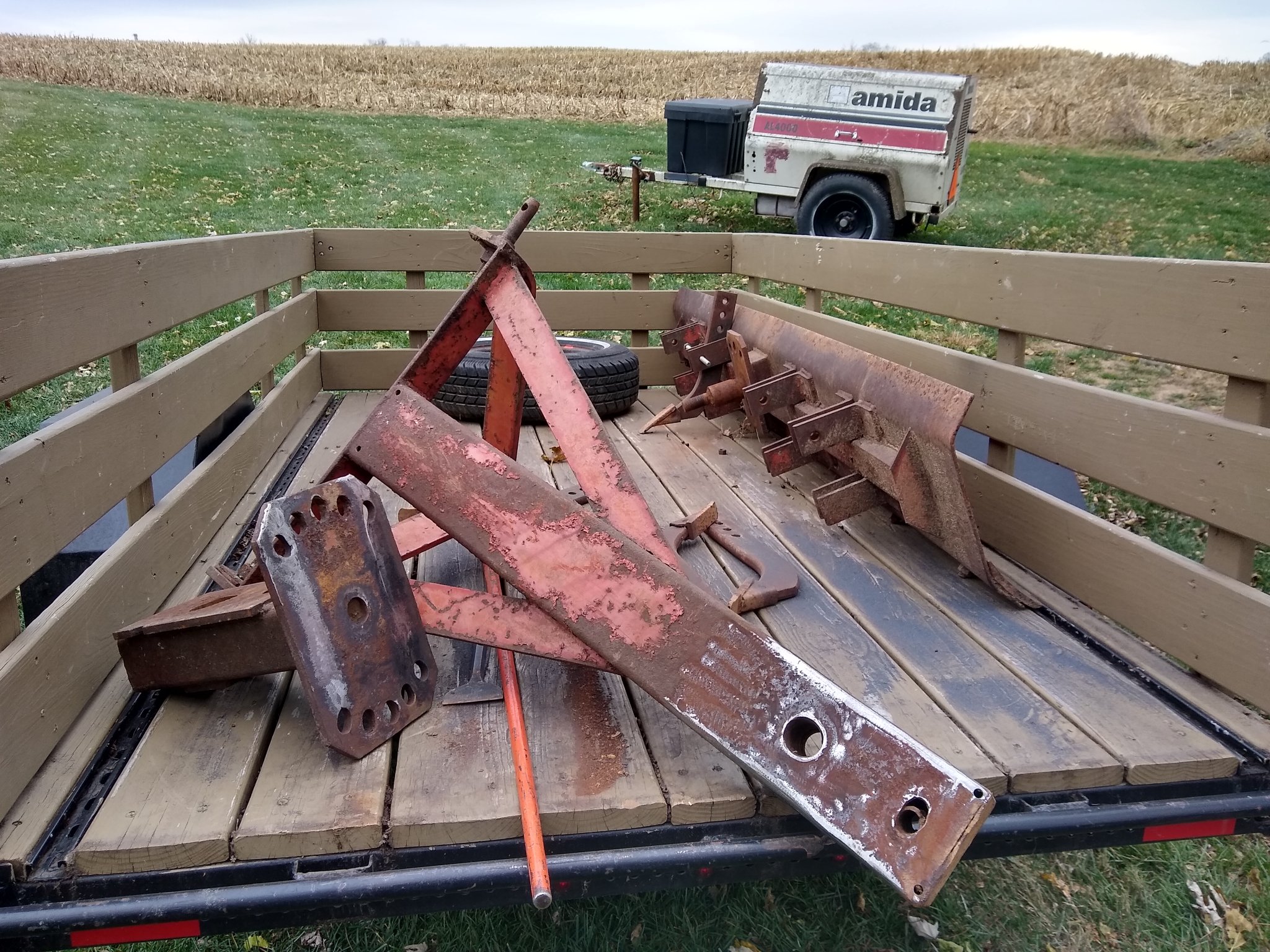

With the exception of popping end plates off, disassembly is pretty much done. The next couple of sessions will be cleaning up and truing up any damaged holes. The scarifiers were attached with an assortment of nuts 'n bolts that I will replace with pins. It would be nice to add some clips to keep the scarifiers flipped up.
I have some preliminary thoughts on making a very robust axle for the rotation. It appears to have had welded-in bushings for the main and locking pins where they passed through the main beam. I'm considering modifying extra large hitch pins and pipe sleeves.

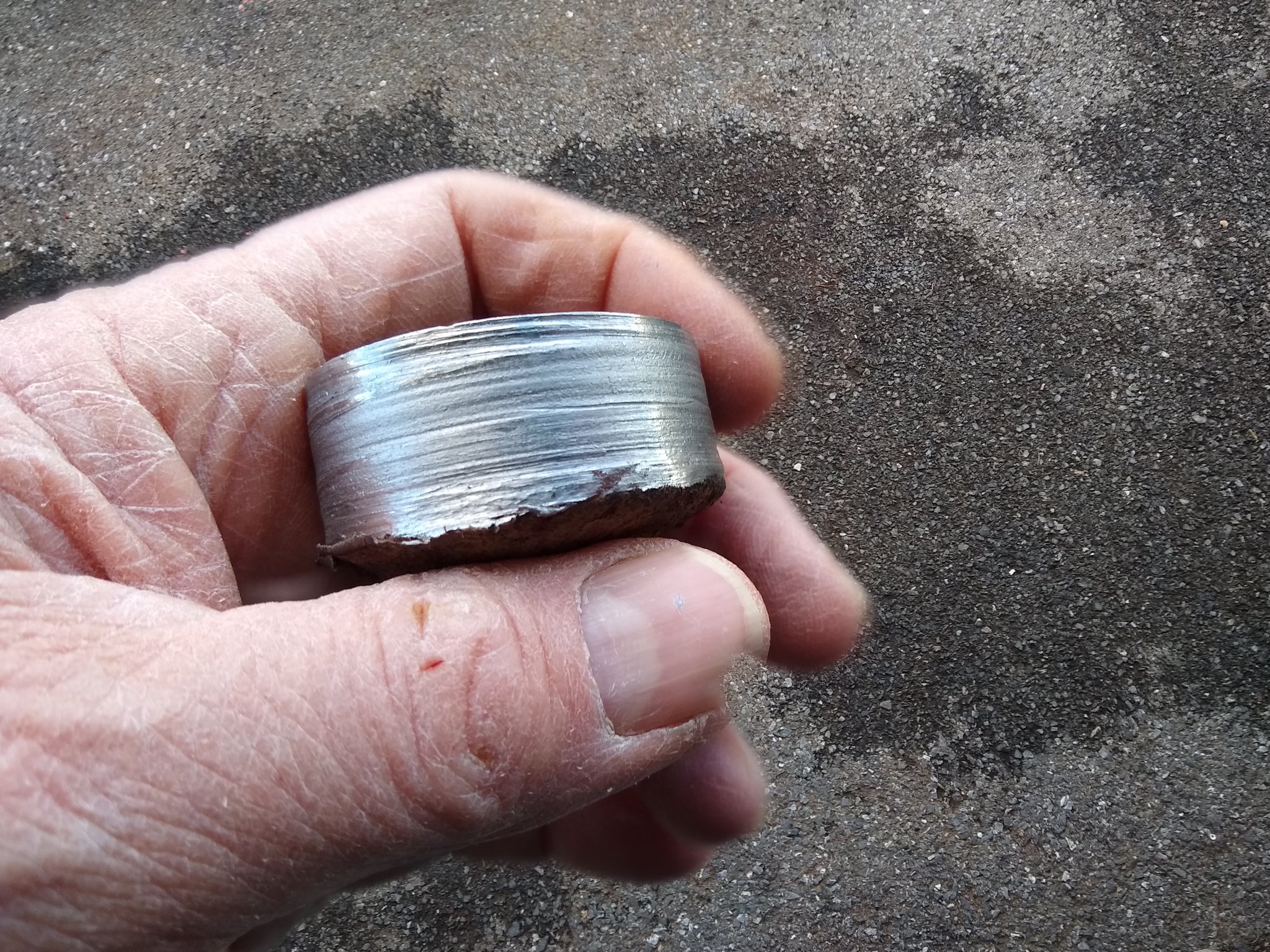

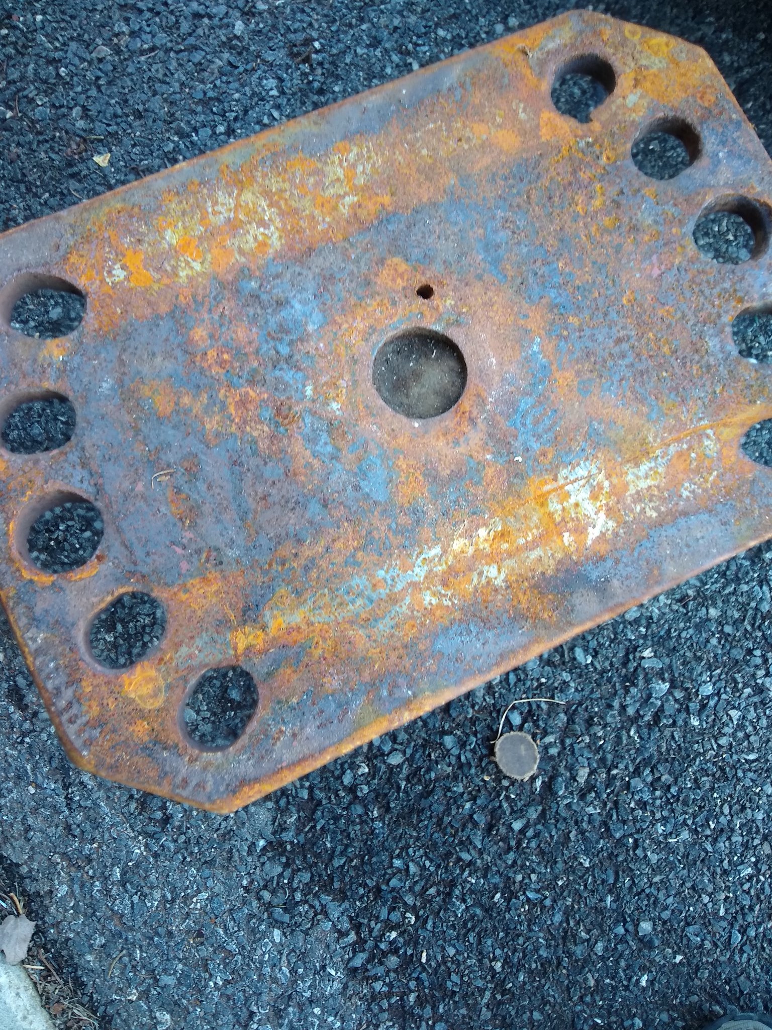

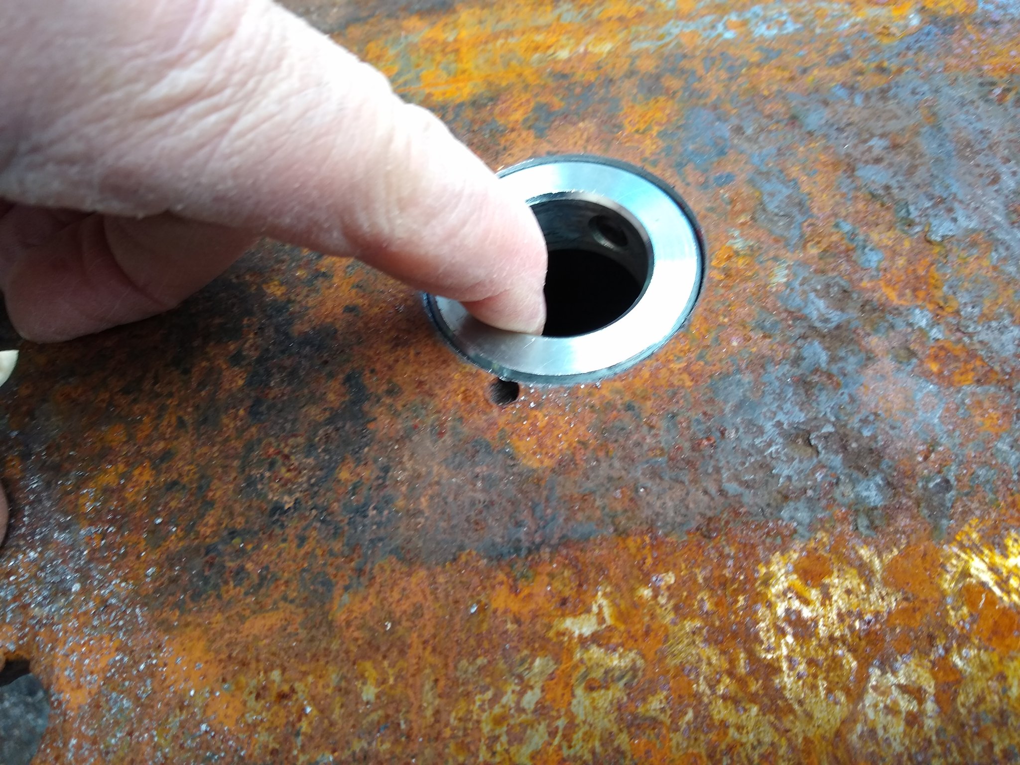

It appears the main reason for the PO to have welded it was that the pin that the blade rotates on is snapped about 1/2" down in the plate. Still thinking through the best way to access what I need to for the repair. Current thought is to use a GR8 bolt . The broken pin is 1-1/4"Ø, so I'm thinking that 1-1/4 or 1-1/2"Ø would work. When that's determined I'll use a sleeve. When the OD of the sleeve is known, maybe a hole saw will work. The old pin is harder than woodpecker's teeth, so I'd use the hole saw to cut the plate around the pin.
