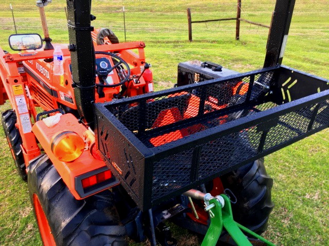

Looks great / well done. I really like the mounting solution through the rops…maybe I missed it but where is the bottle opener?😉
Lol. I do have one that came with my rollaway Husky tool box. I should take it off there (I’ve never used it) and mount it to the bottom of the bracket. But truth be told, I’m a simple domestic aluminum can sort of guy.

Nice! My intended usage is the same as yours. Just day trips. I think my little Coleman cooler (from the late ‘80s, but still just low molded plastic) might?? fit like yours.
Looks like you have a decent sized tool box mounted directly to the right fender as well. That looks very handy. How do you like it there?
That toolbox holds a decent amount of 'Must Have' tools, shear pins, extra hitch pins, lynch pins, etc.....
But the best thing about it is that it makes a perfect Arm Rest. :)

Great write up my man!
Outstanding job on the bracket, it looks like it will last forever.
I am looking at options for a "tool box" as well....the backhoe complicates things though.

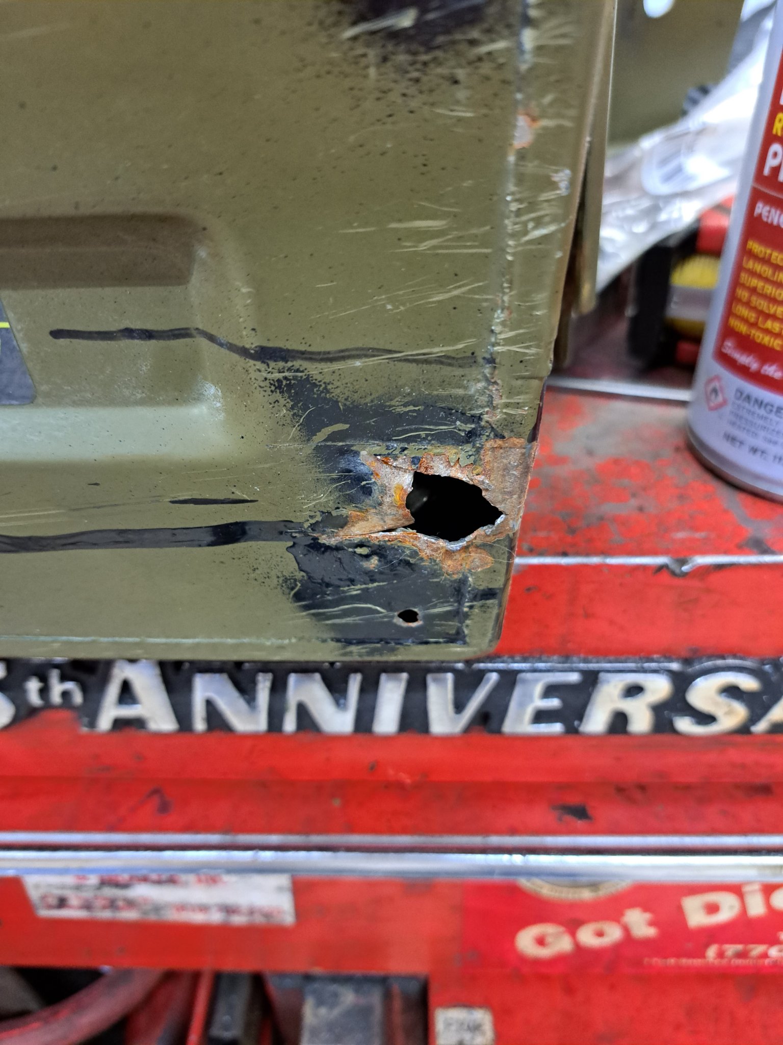

I have one. 2 problems though.
1. I put some chain in it and the constant vibrating ripped out the bottom of the ammo can. Said ammo can was probably 50% Chinese'ium so maybe that was a factor.
2. It sits so high that I have to carry a stool around to see into it. Hahahahaa....seriously though...it's a problem for the "vertically challenged".
I get the vertically challenged aspect. It’s a good thing the basket I put in is mesh. :)
On the aspect about the chain wearing the bottom of the ammo can, I wonder if a chunk of rubber mat in the bottom of the can would help? I’m cheap so my “raw material” is often something I can repurpose. I use road find semi truck tire mud flaps for my anti vibration rubber mat source.
I added a piece of flat steel to the bottom of my tool box where my chain resides for that very reason.

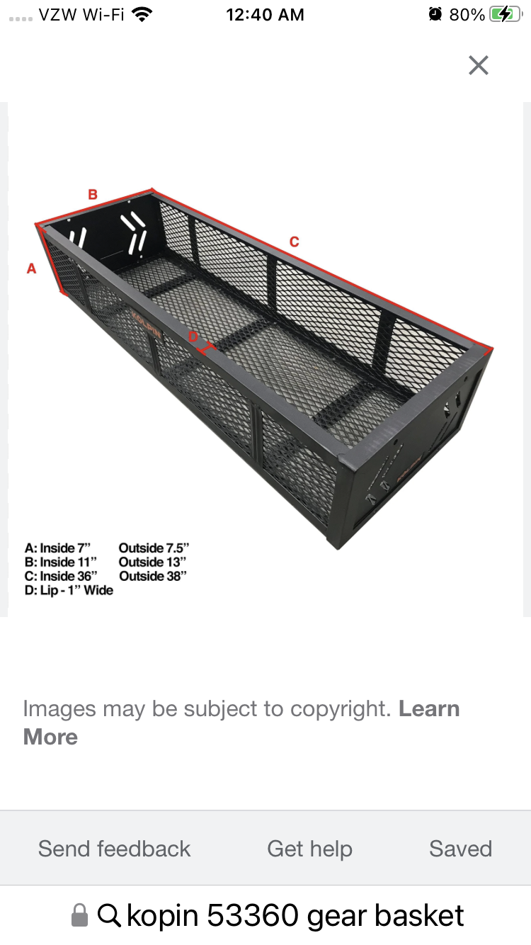

Here’s the basket info, from one of the Amazon vendors. I paid $90 from Amazon in late July 2023, although I noticed immediately thereafter the price increased to about $106.
The basket itself is not very well built, in my opinion. The welds are only tack welds on the vertical “bars” (sheet metal actually) securing about 1/3 of the available cross-sectional area. Regardless I think it will work fine on the bracket I built, as that system will carry any real load in the basket.
One seller has it for $90
It actually pulled the little washer and bolt head through the bottom. I could probably use a Fender washer, or make a larger plate to make it stronger, and I might have to do that in the interest of time.
However, making a plate won't make me any taller. (unless i make plates for my feet)
