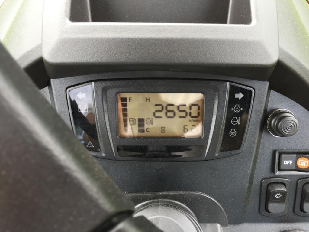

So after receiving my B2650 I noticed I could bring the RPM to 2650 at max throttle. Although not again after a few minutes. Then I can bring it say 2640, and it seems to vary over time slightly.
Is it coincidence that the RPM is 2650 like the name? When I had the 3350 it maxed out at roughly 2500.
Could this be detrimental to the lifetime/operation of the engine?
Any thoughts or comments appreciated. Thanks!

I think the rpm and model designation being the same is just coincidence.
The L2650 manual says that engine is rated for/at 2600 rpm. Your B series manual would have that info.
I read that these newer tractors run a higher rpm to improve exhaust emissions. My BX idles at 1500 rpm and maxes out at 3200 rpm.
Wow, 3200. On page 3 of my manual under specifications it states engine rpm as 1100-2500.
I know you may be hypersensitive after your 3350 experience. I would too. :eek:
A VERY general rule is a smaller engine of the same type will run at higher RPM.
Your manual says 2,500 RPM, and tach says 2,650. Given the lack of precision and inaccuracies of the machine, I wouldn't have an issue with 2,650 on the tach. At a difference of 150, it's within 6% give or take. Personally, I seldom run WOT. Close, but not wide open.
Your tractor looks great!
I know you've really been through the prickers to get to this point, and I wish you the very best with this machine!! :D
But for the cab, I know I'm envious, indeed!;)

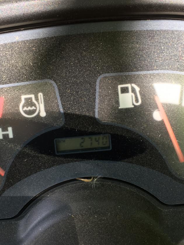

Just an afterthought - my BX2360 was 3 years old last month at ~180 hours now. I honestly don't know what the WOT rpm's are, because I haven't felt a need to find it.
I think I mow and snowblow at about 2,700 RPM or so, and I think my manual says max of about 3,200, like the other BX guys. I know that setting is enough throttle, and don't feel a need to peg it.
Again, no offence intended, and I certainly hope none taken!
10,020
6,823
Guess I wasn't far off.
Had to wipe dust off the tach, been a little dry here. Can see my finger swipe.
