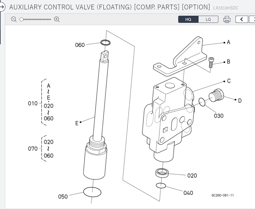

Disassembling a sectional valve work section is not brain surgery. You just have to exercise care when removing the endcap. The springs and balls can get away from you if you are not careful. However the component parts diagram for those valves does not show any of that. It looks like the spool and endcap assembly screw into the body and is not serviceable. The only parts you can purchase are a seal kit and the entire valve. Unless the spool is sticking in the body and you can free it up it looks like the fix is a new work section @ $900. That price is insane. No - let me change that to verging on criminal.

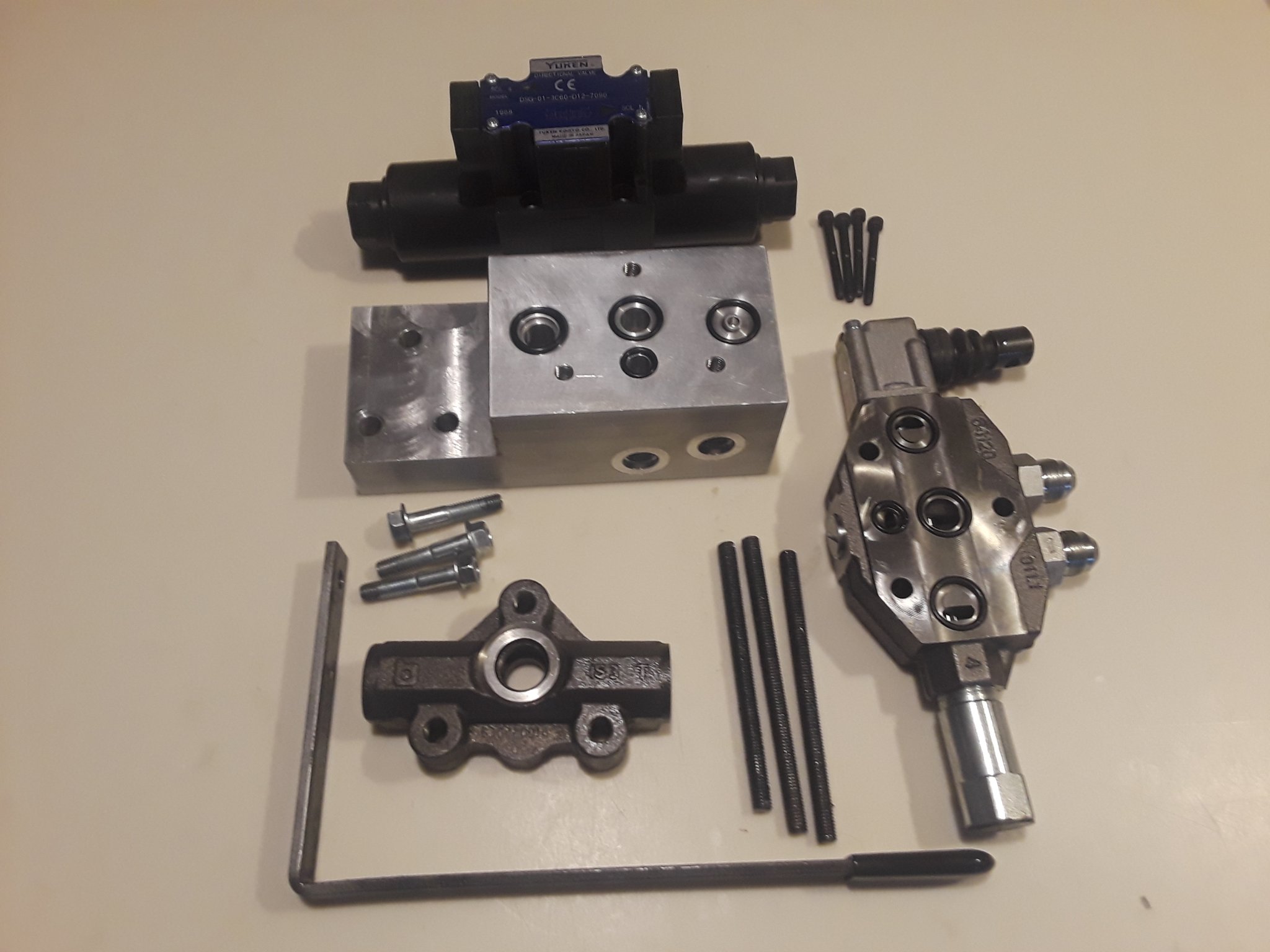

Here is a picture of a custom made manifold and commodity work section I am trying to retrofit to my L3901. The bolt patterns and internal passages are specific to this particular valve. It would not match up with the ones on the Kubota valves. I am using high quality valves not cheap junk and that work section on the far right costs $135. Kubota wants $900 for the one on your LX,.

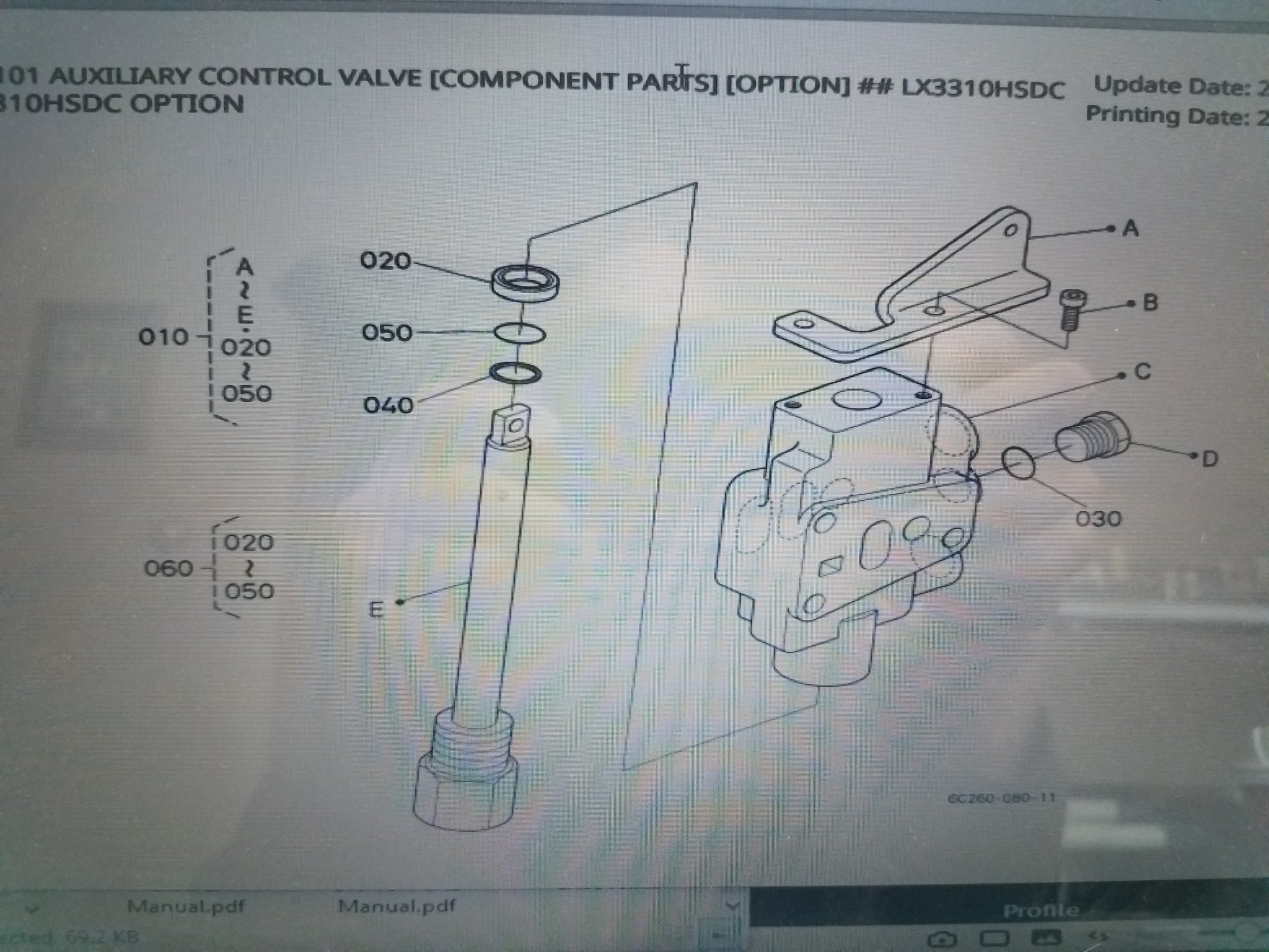

Has anyone rebuilt one of these valves? Does the plunger (E) just slide out of the valve body after you remove the lever off of the top of it?
I can't see any other possibility. What do you have in mind - cleaning? I am guessing the dealer was not helpful?
33,600
8,840
There's really nothing to rebuild, besides a couple external seals.

Thanks but I'd like to hear from someone that has actually taken one of these apart so I know for sure. There is a hex shaped piece on the bottom that may be used to twist out the plunger. The seal kit isn't expensive so I'm thinking of just trying to replace them first. The drawing isn't helpful to understand how the valve works. Wondering what the stack of what look like washers, above the hex shaped piece, is for.
13,017
5,726
It looks like 'E' is the spool valve to control where the oil goes. It's not just a smooth 'rod' as shown, will have 'grooves' milled here and there.I'm thinking the hole in the milled top attaches to some kind of lever
One of those , have to see it in person,on a clean bench with lots of lighting.
A proper WSM shoud have detailed pictures on disassembly and rebuild of it.

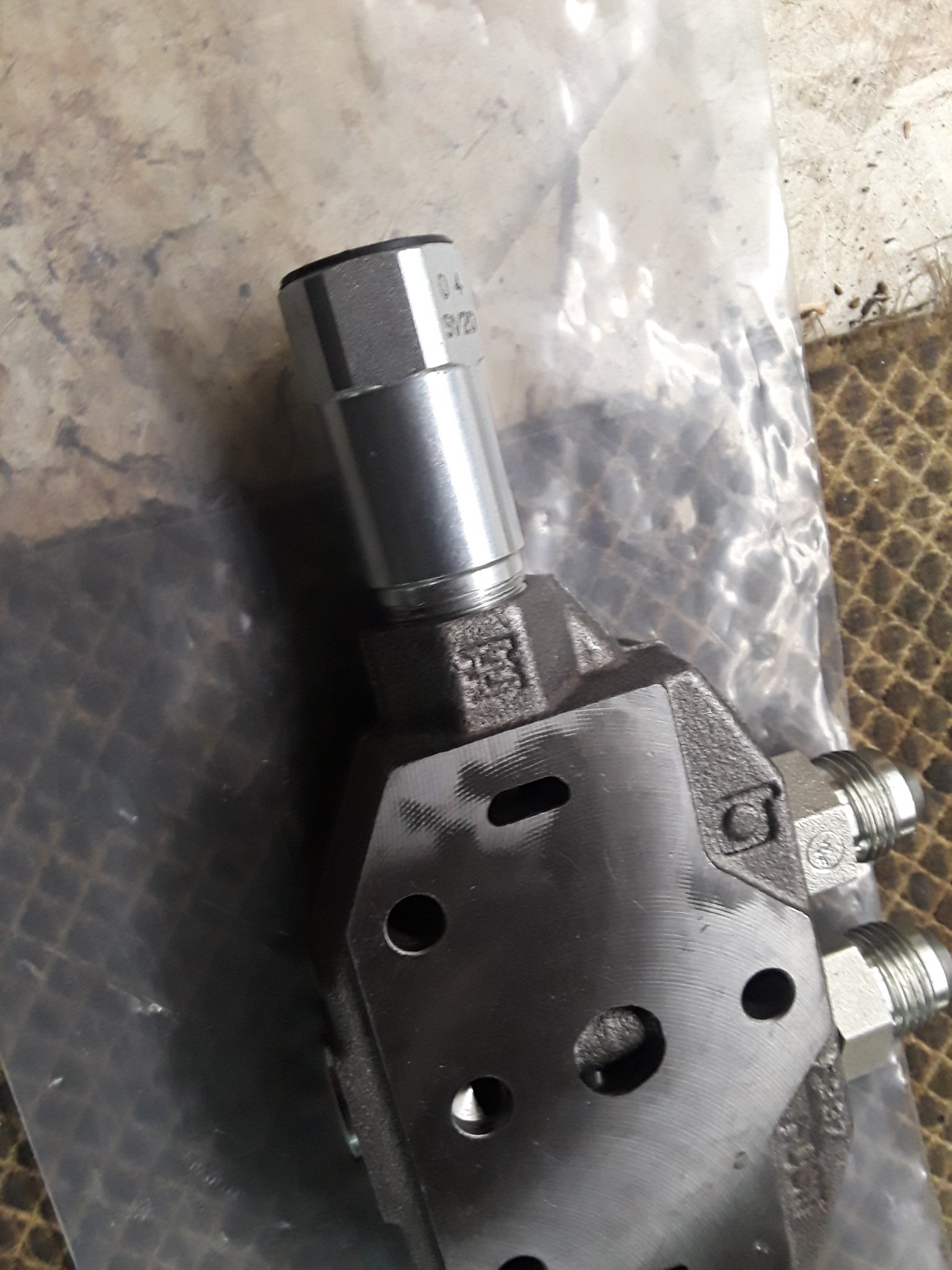

Here is a similar valve (different manufacturer) I have on my bench right this second. It is a sealed unit and quite obvious the whole assembly is screwed into the back of the housing. Once you unscrew the sealed cartridge portion the attached spool can be CAREFULLY withdrawn from the body. Scratches or nicks on the glands will turn it into scrap. The other stuff in the parts diagram are stem seals and bushings. You may find its just got some junk trapped in the bore and a little shop air will fix it right up. Coat the spool with clean hydraulic oil before you put it back in.
