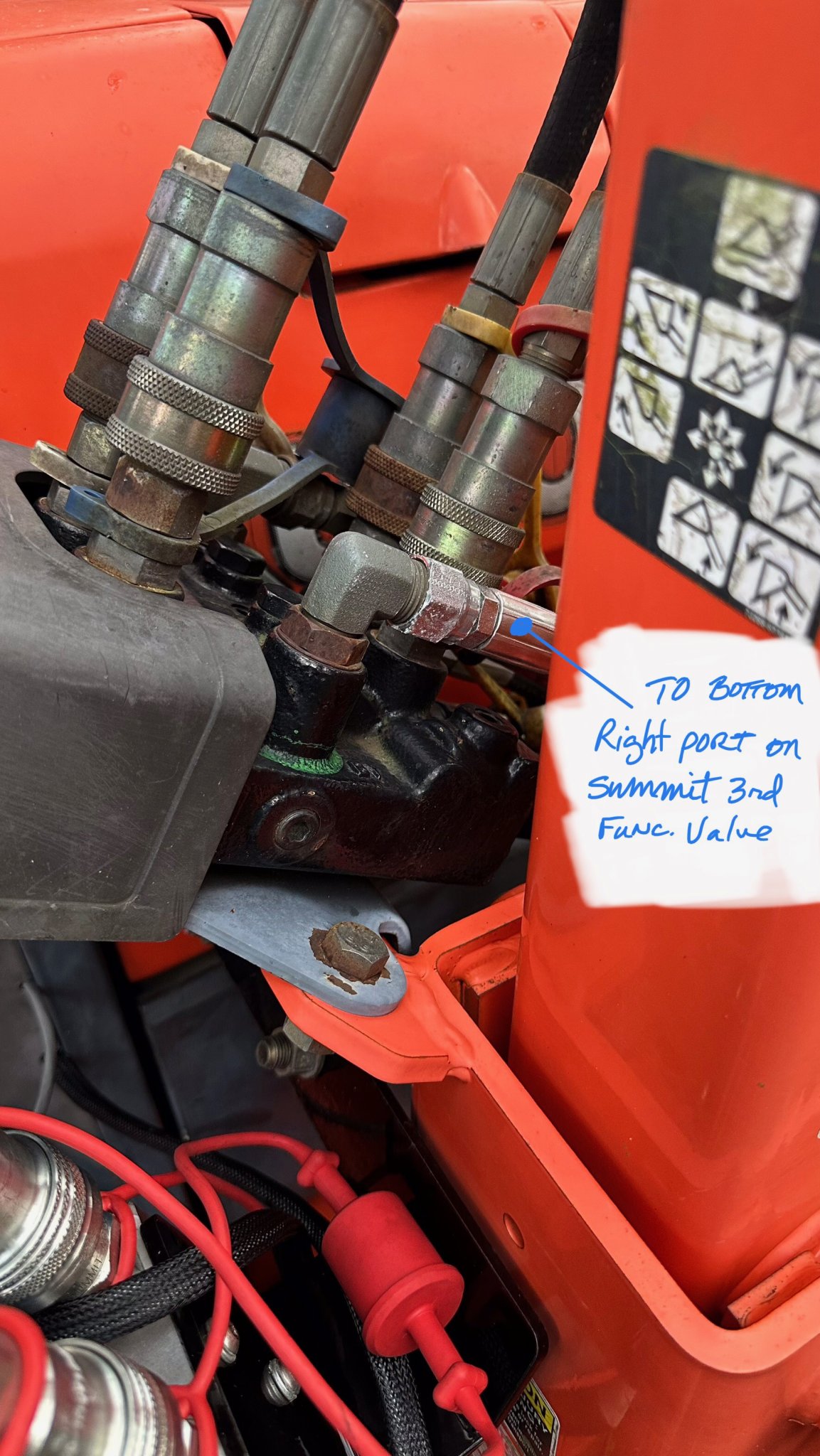

Sounds like the third function is not hooked up properly.
Any pics of the install?

Is this attached to the T port on the valve?
It should be attached to the P port on the valve.

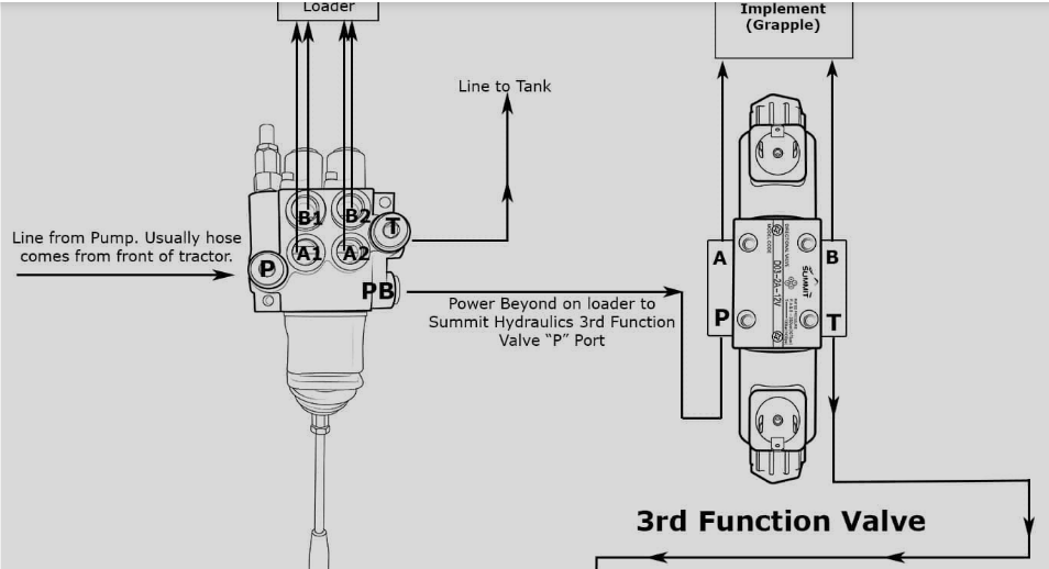

I understand what you are saying, this part of the instructions were the most confusing. The markings on the TFV are not clear. Is it possible if the lines are crossed at P and T that all of the loader functions would still work perfectly and the steering only be affected??? If I switched the lines to P and T is there a chance of damaging anything if it is correct now?

It should be stamped next to each port.
Just going by their schematic it's backwards.
And no you won't hurt the tractor if it's backwards.
