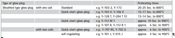

Will a different type of glow plug (assuming I can get one to fit my tractor) enable me to start the engine with the throttle at idle, with significantly less pre-heat time?
The NGK website refers to different types of plugs, with times to 800-900 deg C ranging from 25 seconds (probably my existing type of glow plug) to 4 seconds for a 2 coil self regulating plug.
(My current glow plugs are NGK marked "7812 Y-105-I 10.5V" and could be original. The numbers have been superseded, no info about it on the NGK web site. The WSM describes the OEM plugs as metal sheathed coil type factory spec is 1.0 to 1.2 Ohms, replace a plug if resistance is zero or infinitely large. Actual resistance for each one is 1.7 to 1.9 Ohms, so electrically I assume my plugs are OK.)
