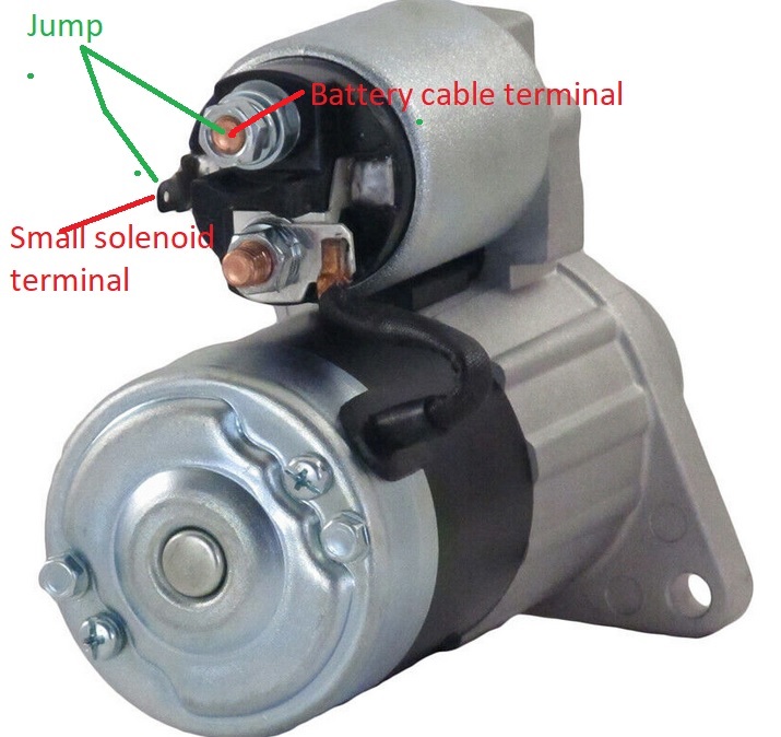

Jumping the starter will tell you a lot but you need to realize this comes with risks.
All safety features are bypassed and it is very easy to get run over or end up with a runaway tractor.
Having someone knowledgeable in the seat with the brakes applied is best.
Expect a small harmless spark when the jump is done.
The engine should crank immediately. If it does then your problem is in the safety circuits controlling the starter operation.
Dave
