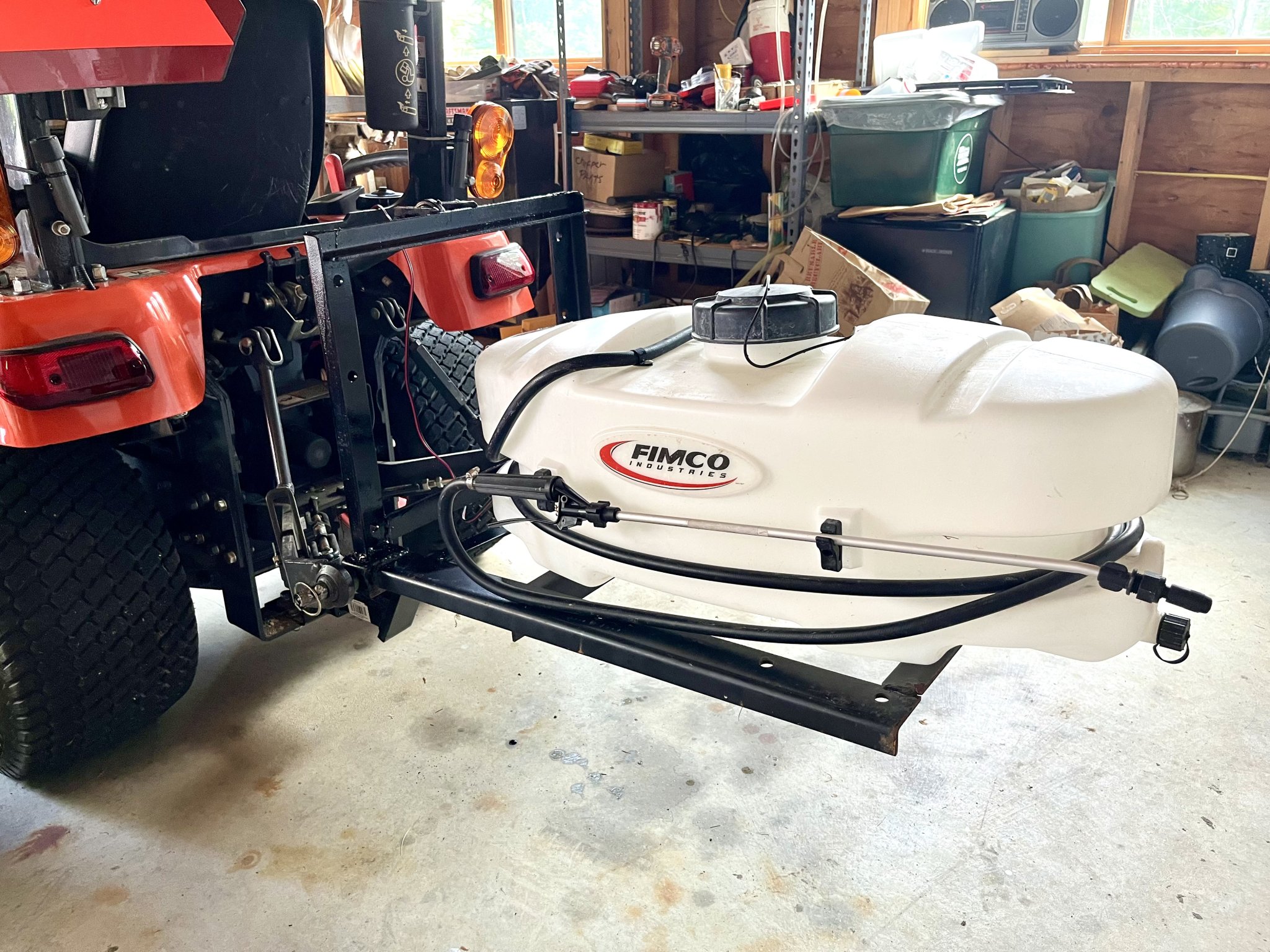

I have a few apple trees and spray them with Kaolin Clay Powder mixed into water to drive off the Japanese beetles organically.
The 15 gallon sprayer was carried around in a small trailer but recently I decided it needed a dedicated frame for my BX’s 3pt hitch. I mounted the tank longitudinally so I can agitate the contents by heel and toe on the HST pedals. Everything but the pins came from two scrap metal frames that came as shipping brackets on my garage lift. 2 hours and done!
