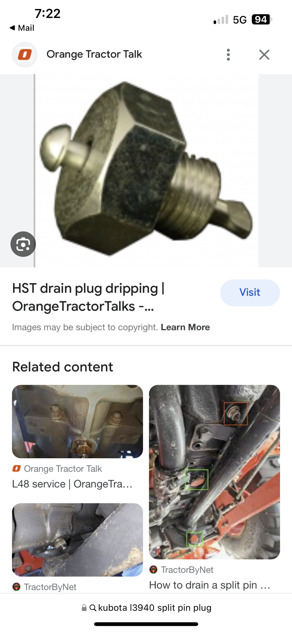

Split pin plug

That plug is designed to allow condensation to escape. Plug it…and you’ll have it cause corrosion and if it freezes will break the housing.

Probably should figure out why hydraulic fluid is leaking into that cavity and repair the leak.
If you do plug it, count on other problems later. Likely a non op clutch.
32,935
8,388
NO you can not plug it, plugging it would fill the clutch housing with the leaking fluid and render the tractor inoperable in short order.
It's the propeller shaft seal that is leaking.
You will need to fix it.
It requires splitting the tractor to fix it.
