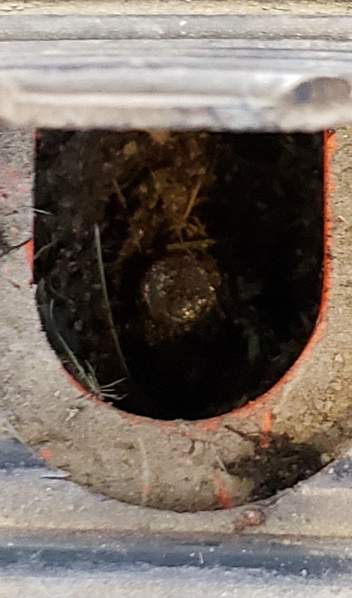

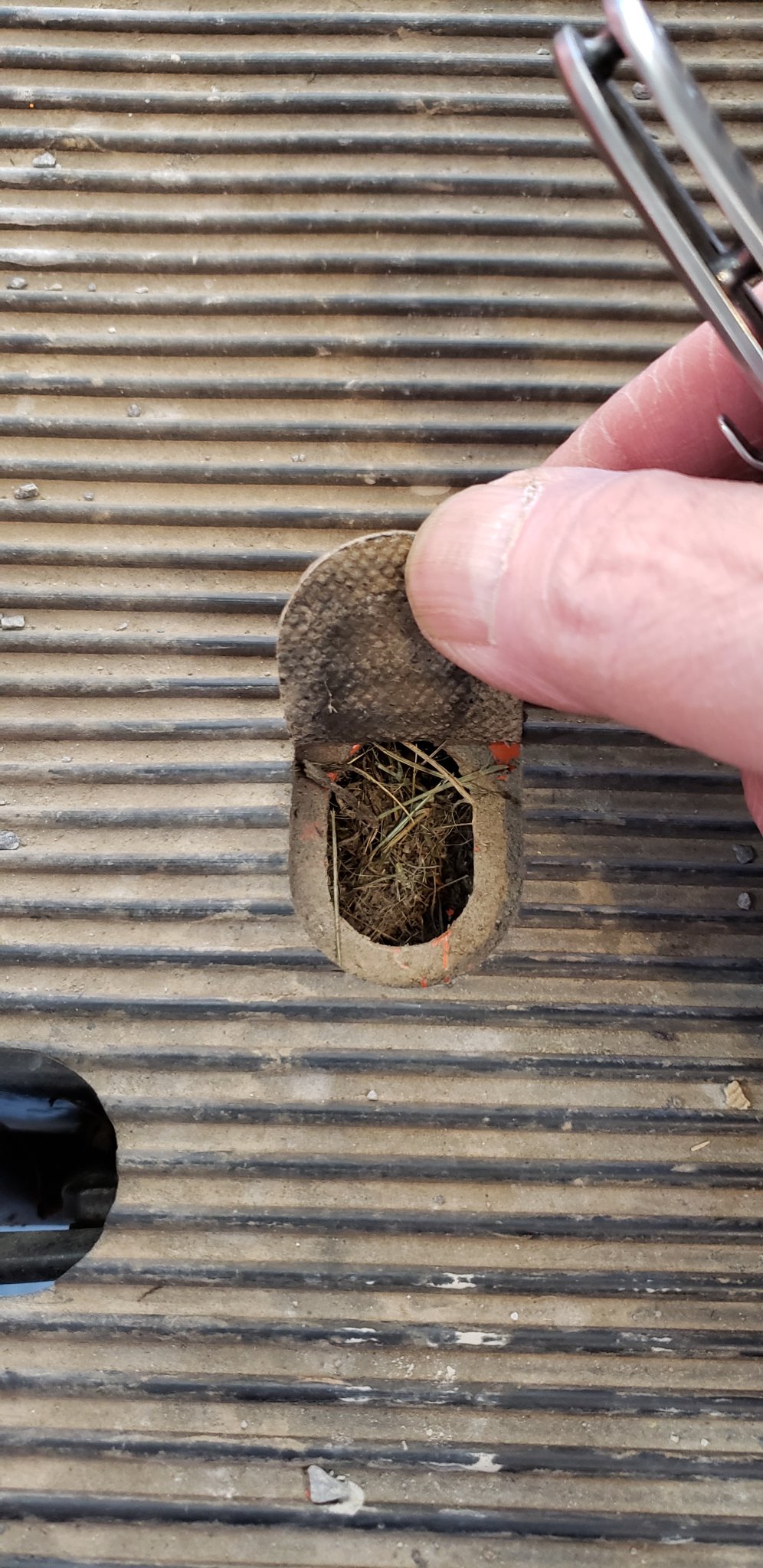

I noticed lately when I take my foot off the speed control level (treadle pedal?) the tractor would continue to move in either the forward or backward direction. So thinking really hard (Whinnie the Poo style) I remembered some advice on OTT about lubricating some hidden grease jerk. Here’s what I found. Looked like a mouse nest.

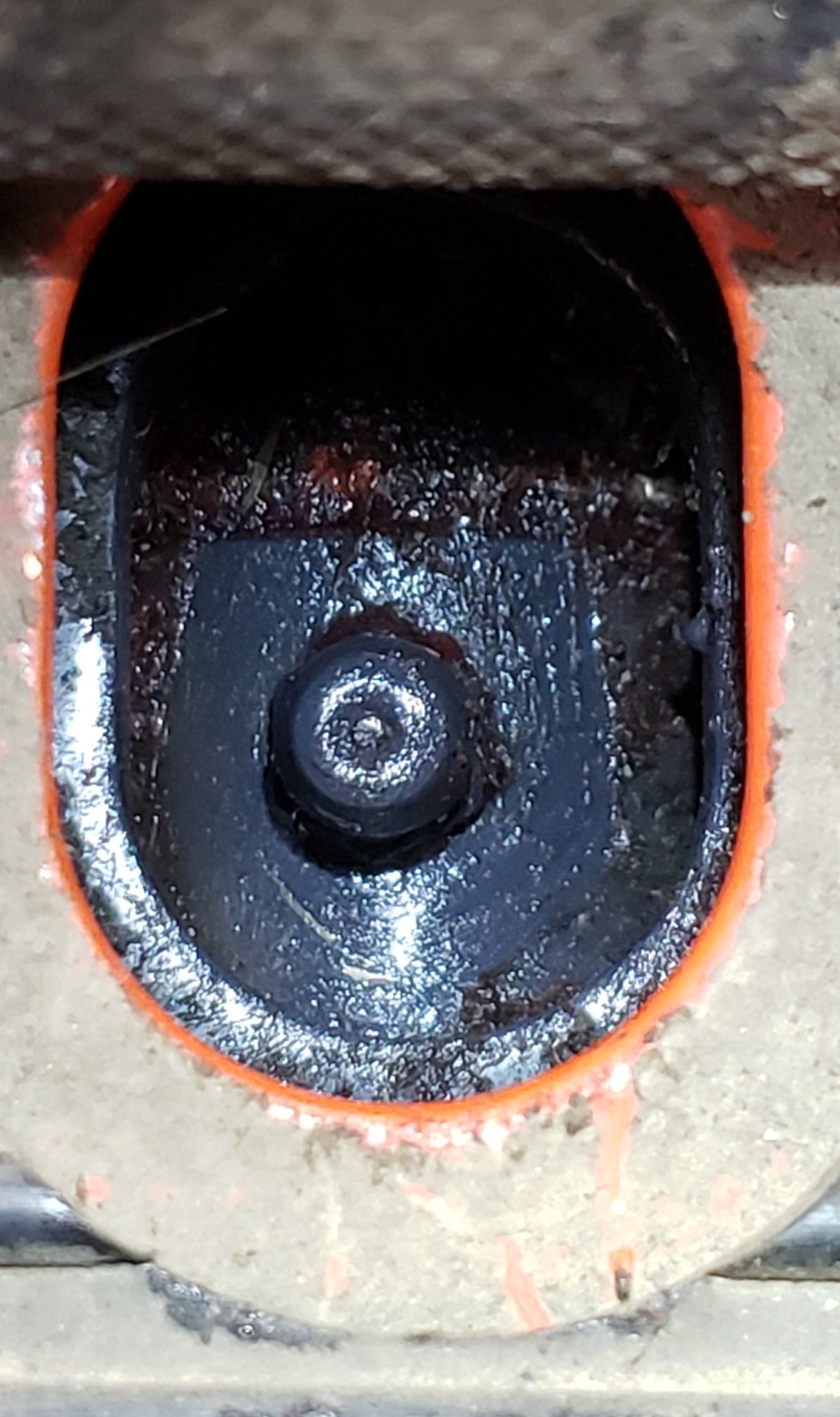

Now it's all greased up and good as new. So simple, quick, and easy but never done until...
