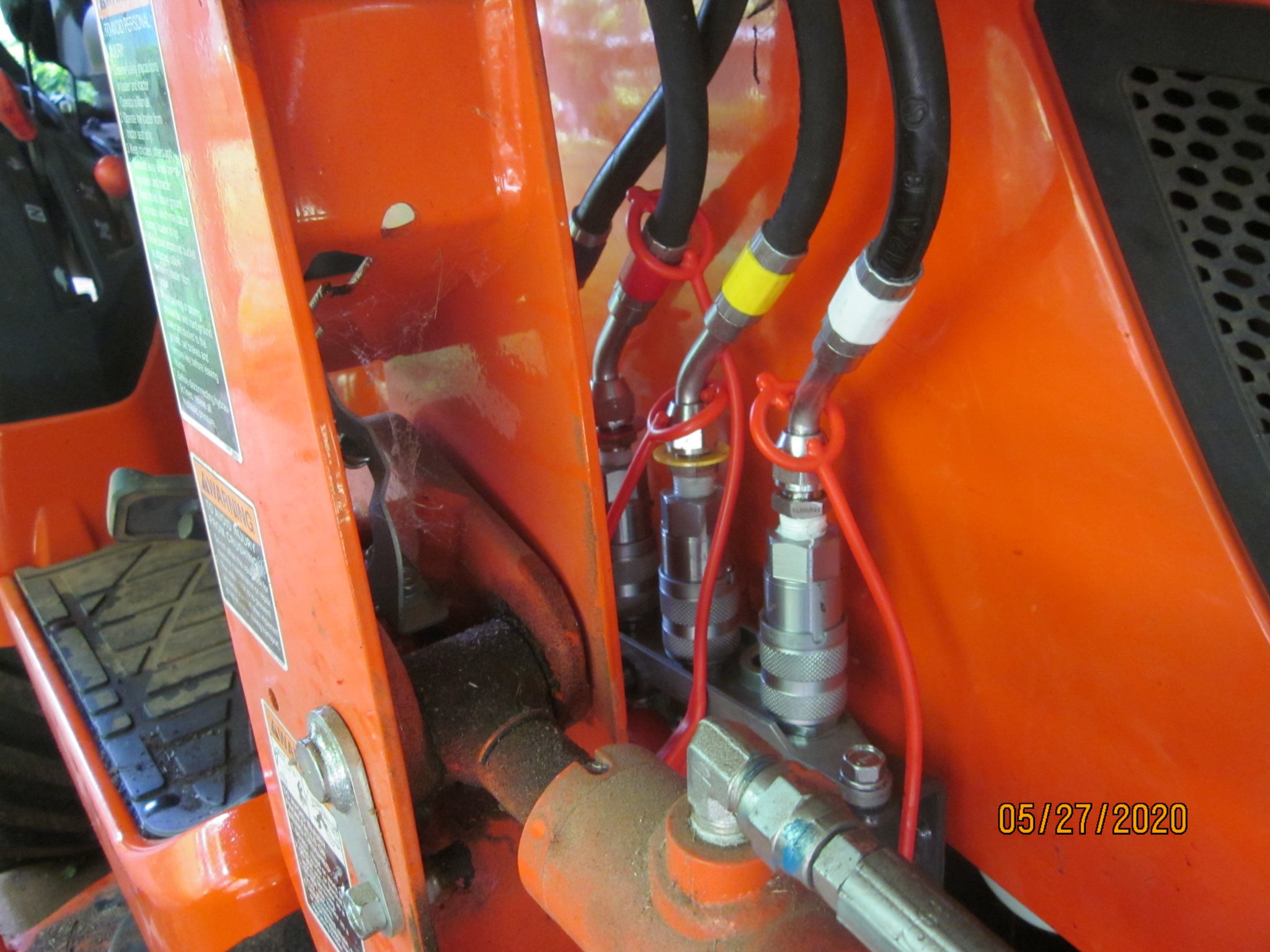

I used different colored electrical tape when I replaced the crappy upper quick gang coupler with individual couplers on my 2380 about a year ago. Works fine for me.

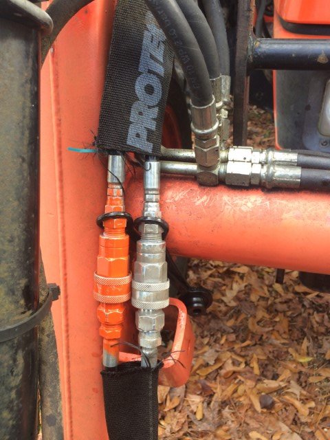

Sadly, UV will kill colored zip ties making them brittle and oil will melt the glue on tape.
All of the hydraulic hoses on my sawmill are painted with different colors for identification. Blue, green, yellow, etc. I have done the same thing on my tractor attachments.
The top tractor fitting is also painted orange and the bottom light gray.
