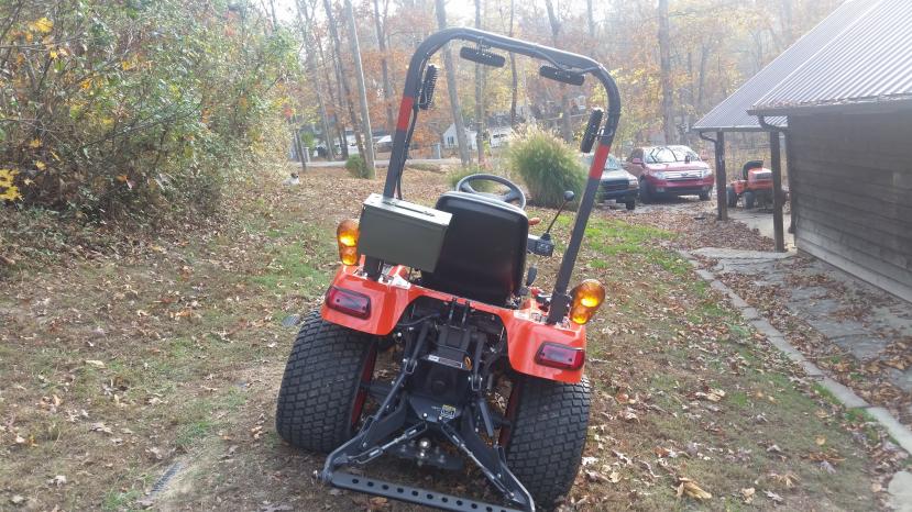

I'm also not sure about mowing on hills with the BX. I can maneuver around my property with little trouble, even with FEL on, as long as I go slowly. I could zip around easy with the G1900, especially since it was 4WS. I'd welcome thoughts from anybody with experience mowing with a BX in a wooded, hilly area.
Here's a pic of my BX on about the steepest place on my property. Incline meter on top of ROPS says it's about 20-22 degrees. I've read several threads on BX as primary mower, use on slopes, etc. but would welcome advice.

I agree, with or without ballast that is not an issue. I regularly have mine on twice that grade with no issues. As always; when side-hilling you need to pay close attention and be aware of variances in the terrain and implement height but as a base angle of operation that isn't anything concerning for a BX.
I've found it's not as much about the angle of the terrain as it is about the condition of that terrain. A 3" down hill wheel dip on a 20 degree side-hill is more dangerous than a 40 degree smooth surface to me anyway. Momentum is what rolls most tractors.
10,977
2,831
I think you will be happy holding onto and using the BX - I have to admit, I moved from a brand new BX, back to a old B7100 for cutting grass, the old B is a beast, and will climb mountains, not that the bx cannot, but with a loader and BH attached - cutting grass took on a whole new meaning on the BX!
The last shot of yours, you seem to have spacers on already? If not get them, and if you do not have your tires filled with something, that 70 lbs per tire will really help in that situation - even with the bucket low.

Thanks for the replies. I do not have liquid in the tires, although I am open to trying it. I am a little concerned about adding more weight to the tractor and having it press the grass down and not mow well enough. Guess I can give it a try, though.
I've mowed this yard for 20 years so I know it well. No real trouble spots I don't know.
85Hokie - good eye! Yes, I added 2" rear spacers. I;m sure they help, but I didn't notice much difference in the "feel." I guess its the way you sit higher in the saddle on the BX as compared to a mower.
cerlawson - thanks for the tip. I did try something similar. In the photo of the BX on a hillside I got off and tried to lift the high side of the machine. I could do it, especially if I pushed on the upper part of the ROPS, but it did take quite a bit of force. My 190lbs in the seat probably raises the COG somewhat.
