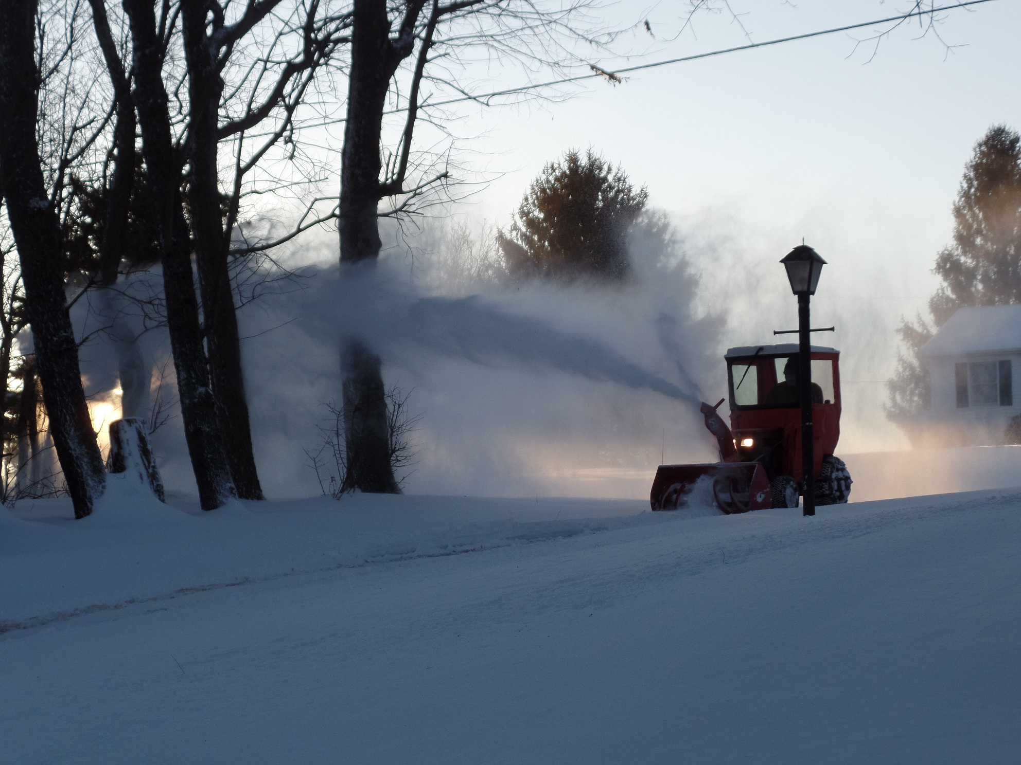

I have an Original Tractor Cab on a Wheelhorse tractor that I use with my 44" 2 stage snowblower. That cab is the same for nearly all tractors from the bottom of the windows up. If you decide on a soft cab, get the glass windshield and electric wiper if you will blow snow or get out in bad weather. Yes, there will be some fogging and the wiper is necessary, on the side windows I use a soft, clean towel so that the clear plastic doesn't get scratched. I have used it for about 25 years with no tearing, the plastic is just now showing signs of age with a few pin holes. I do partially disassemble and store it in the basement during the no snow season, and that surely helps preserve it.
