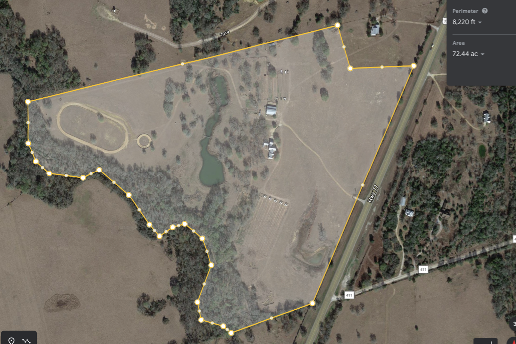

I am all over the map on what tractor to buy. I have never owned land and a tractor before, but I have helped out on a friend's 50 acre ranch driving his small old Ford tractor with a 5 foot brush hog. I am now moving from a house near downtown Austin to a 72 acre ranch that will close in early Feb or late Jan. The ranch currently has 45-50 acres in hay field that look to be in pretty good shape. A third party fertilizes and harvests hay on the property to keep the agriculture exemption on the property but I am unsure if this will continue, though I could likely find someone else that would be interested in doing so. Additionally as part of the great change in where we live I promised one of my daughters a horse. The land is in excellent condition but some early projects will be to remove the fencing pens for the greyhounds the current owner used to raise and to return the tracks to hay field use. I also need to keep the woods and the weeds at bay from encroaching on the coastal hay fields. I am unsure what I will be doing on the property 3 years from now. I may have 10-20 head of cattle, I may bail hay, I may plant pecans, so basically the future is wide open. Every friend and family member I talk to has a different take as to what tractor to buy. The opinion of my landed friend is that it takes two tractors for a property like this. One that is small and can mow the fence line and around the trees, and another that can do scale work. My current thoughts are an old 25-40ish 2WD tractor with a 4-5 foot brush hog and then a large tractor. I am seriously considering a M5-111 as a buy once pay one solution to the scale problem. This way anything I would find myself doing in 3-25 years from now will be doable. Baling hay is a definite possibility and the main reason I would want 85+ HP. My time is also valuable and it needs to be spent wisely and with enjoyment. I've also considered a single tractor like an MX6000 at half the price of an M5-111 and just stick with one tractor and continue indefinitely on a third party to bale and take away the hay. I am extremely mechanically inclined and have tons of tools to work on a tractor, but at least one of my tractors needs to be turn key. I feel like if I bought an M5-111 that spending the money would sting for a year or two and then past that point there would be no regrets, but another voice in my head says 65K for a tractor is crazy unless you are making money. For members with land similar to mine what tractor or tractors have working for you? I know I need something in the first few weeks of ownership but I am just all over the map. I do plan on buying a zero turn mower for the 2-5 acres near the house on day one but beyond that this much land is daunting for me. I know its a good problem to have but would I be a fool or smart for buying a large tractor early?

I am all over the map on what tractor to buy. I have never owned land and a tractor before, but I have helped out on a friend's 50 acre ranch driving his small old Ford tractor with a 5 foot brush hog. I am now moving from a house near downtown Austin to a 72 acre ranch that will close in early Feb or late Jan. The ranch currently has 45-50 acres in hay field that look to be in pretty good shape. A third party fertilizes and harvests hay on the property to keep the agriculture exemption on the property but I am unsure if this will continue, though I could likely find someone else that would be interested in doing so. Additionally as part of the great change in where we live I promised one of my daughters a horse. The land is in excellent condition but some early projects will be to remove the fencing pens for the greyhounds the current owner used to raise and to return the tracks to hay field use. I also need to keep the woods and the weeds at bay from encroaching on the coastal hay fields. I am unsure what I will be doing on the property 3 years from now. I may have 10-20 head of cattle, I may bail hay, I may plant pecans, so basically the future is wide open. Every friend and family member I talk to has a different take as to what tractor to buy. The opinion of my landed friend is that it takes two tractors for a property like this. One that is small and can mow the fence line and around the trees, and another that can do scale work. My current thoughts are an old 25-40ish 2WD tractor with a 4-5 foot brush hog and then a large tractor. I am seriously considering a M5-111 as a buy once pay one solution to the scale problem. This way anything I would find myself doing in 3-25 years from now will be doable. Baling hay is a definite possibility and the main reason I would want 85+ HP. My time is also valuable and it needs to be spent wisely and with enjoyment. I've also considered a single tractor like an MX6000 at half the price of an M5-111 and just stick with one tractor and continue indefinitely on a third party to bale and take away the hay. I am extremely mechanically inclined and have tons of tools to work on a tractor, but at least one of my tractors needs to be turn key. I feel like if I bought an M5-111 that spending the money would sting for a year or two and then past that point there would be no regrets, but another voice in my head says 65K for a tractor is crazy unless you are making money. For members with land similar to mine what tractor or tractors have working for you? I know I need something in the first few weeks of ownership but I am just all over the map. I do plan on buying a zero turn mower for the 2-5 acres near the house on day one but beyond that this much land is daunting for me. I know its a good problem to have but would I be a fool or smart for buying a large tractor early? View attachment 53001
Let me add the current land owner has an old 85HP IH 2WD tractor, a Case construction tractor with a backhoe, and a garden/lawn tractor. He is taking it all with him. Not sure what the guy with the baler has but his partner used a Deere 5XXXE to cut and load the bales on one of my pre-ownership visits. There is also 10-15 acres of woods with very tall trees for the Texas area.

Well, you've dived in the deep end, haven't you :eek:? Congratulations.
Your land looks pretty flat, right? You're going to get lots of opinions, no 2 the same, so be prepared. Besides tractor/equipment, I recommend befriending neighbors and figure out whose judgement you can trust. Ask questions and listen. I think you're right to consider used equipment. First, you need a utility tractor. I'm thinking something in the 50 - 75 HP M or MX model range (I'm talking Kubota, but other makes may suit you better). 4 WD, SSQA loader, hydrostatic or shuttle shift tranny. Start with a 6 or 7 ft 3pt brush cutter. With the SSQA you'll be able to handle round bales with a spear and haul crap with a bucket. In my opinion, any tractor with a loader is better with 4wd.
I'd forget about cutting my own hay, for sure at first. It's a lot more involved than you might think.
Depending on the lay of the land, you'll always need to trim bushes, etc. And depending on your land and the size equipment you find, you may be able to run a bat-wing mower to mow pasture.
That's my thoughts, I'm sure others will disagree. Flame away 🔥!

Which leads to this thought. If you're going to be trimming around those trees, I'd strongly recommend pruning the branches up to 10' or so, so your tractor can pass without hitting. A pole saw and brush cutter should probably be high on your list so you can get this done before summer. I don't know your age or physical condition, but that pole saw will give you an upper-body workout.
