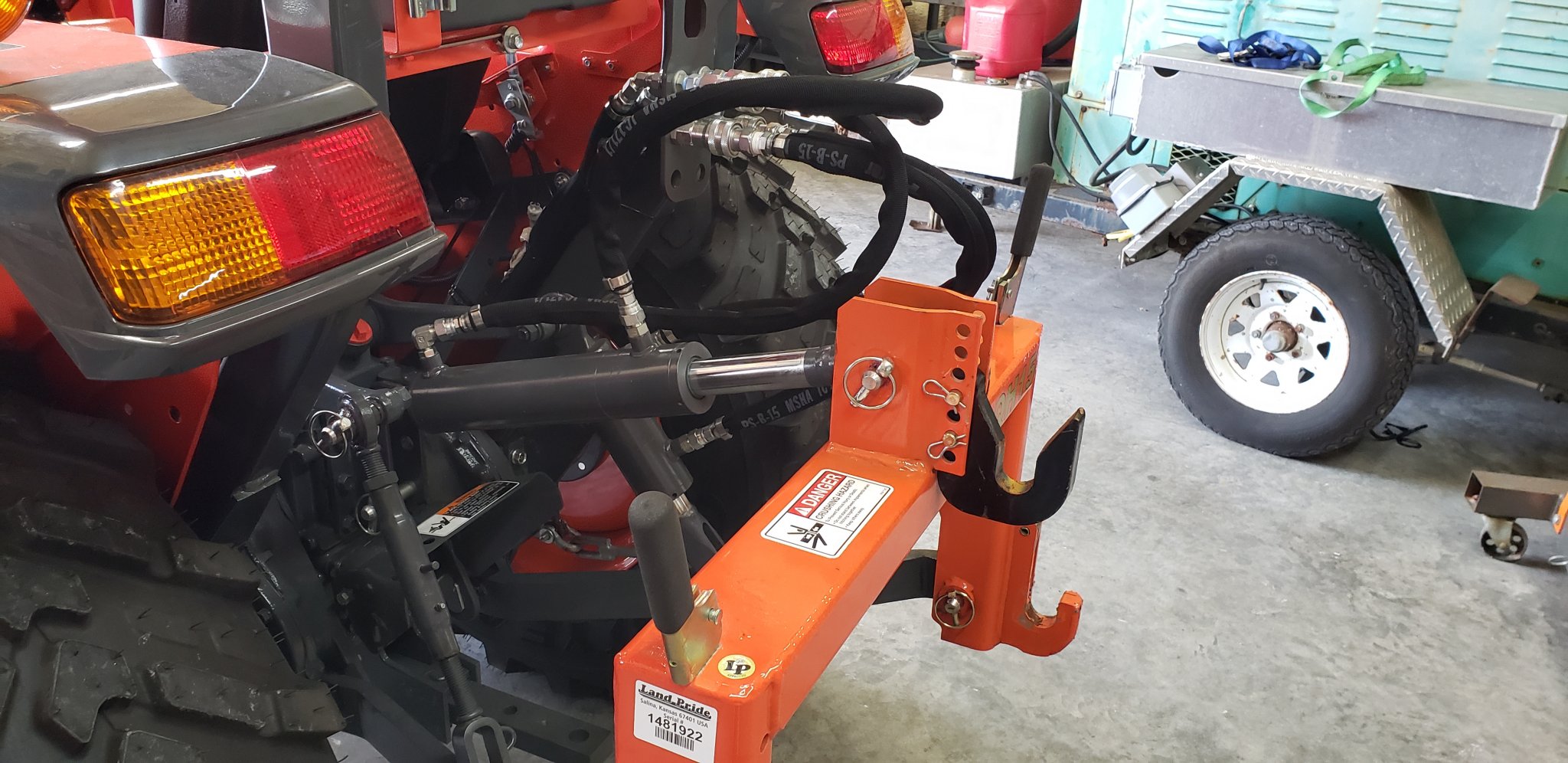

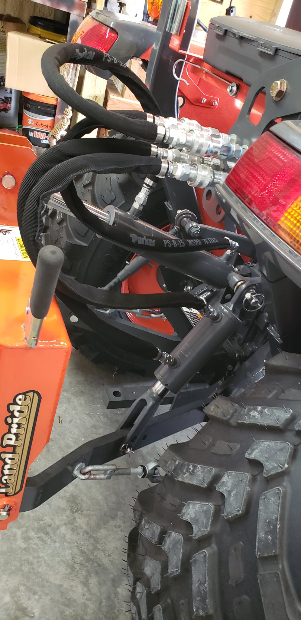

Here are some pictures of my l2501 with top n till and quick attach.
You might want to think about the cab tractor for snow, and those
hot summer days.. more money but will be worth it when its 20 degrees and you're pushing snow or 95 and mowing
