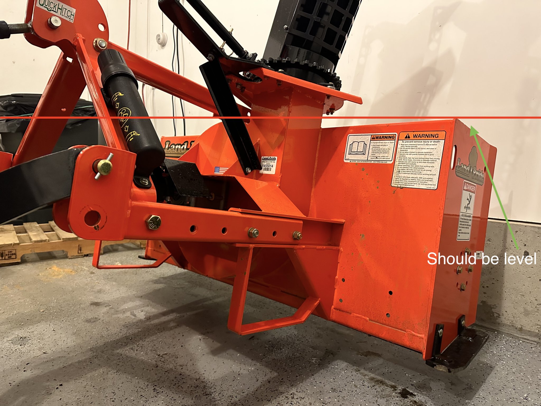

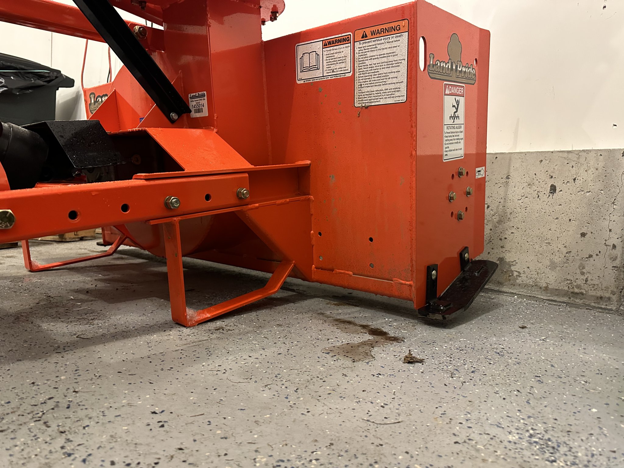

I am very new to my tractor (BX2380), I have had it just over a week, and most of that time it was at the dealer. Before the dealer came to pick it up, the snowblower worked, and dropped level to the ground, with zero issue - I was able to play with it in the little snow that we had before they took it. I took delivery of it this afternoon, they had come to get it for a service - oil change, standard look over, and to replace the rear PTO seal, as it was leaking, and we got snow this afternoon, and after work I went to use it, and the snow blower won't come anywhere close to sitting level on the ground. Any thoughts? Would they have messed with the 3-point hitch to replace that PTO seal? Here are a couple pictures of it not touching the ground. Thanks in advance!

That is kind of what I figured and was playing around with it since I posted this. I've raised/lowered, adjusted, repeat probably 20 times, and it won't quite sit level.. Another odd behavior, which it was not doing previously, when I raise the attachment with the lever, the attachment starts to droop toward the rear of the blower (essentially tipping the opposite direction when on the ground). I'm sure its supposed to do this a bit, but the angle seems very extreme. Is this more of a trial and error thing until it sits flat with all the hydraulic pressure released?

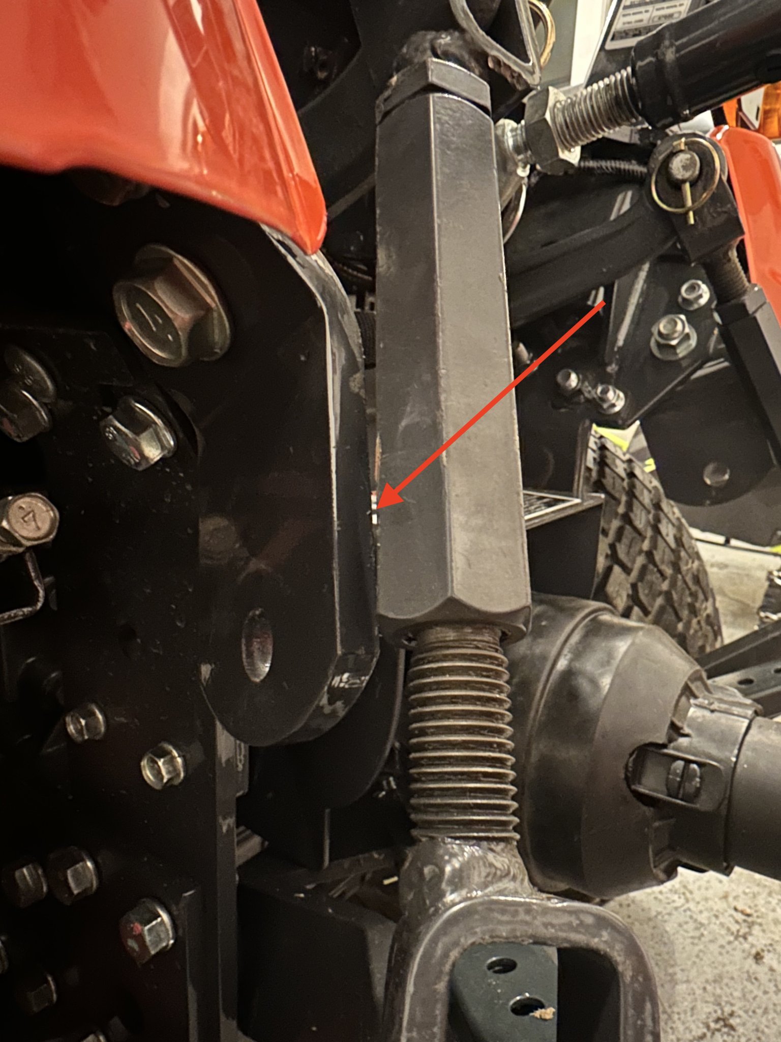

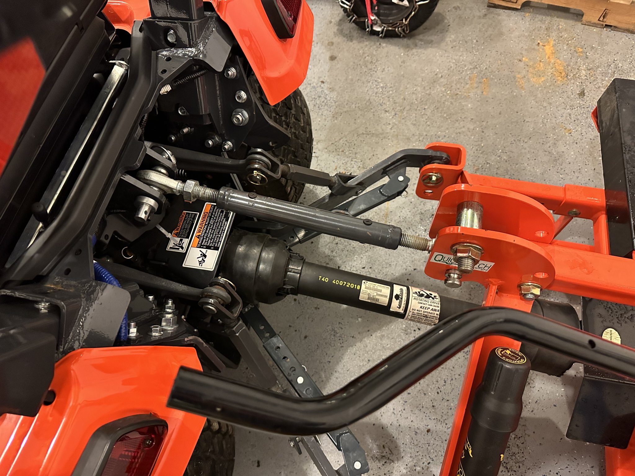

I'm not seeing any additional holes on the tractor side of the top link. Here is what I'm seeing (first two images)

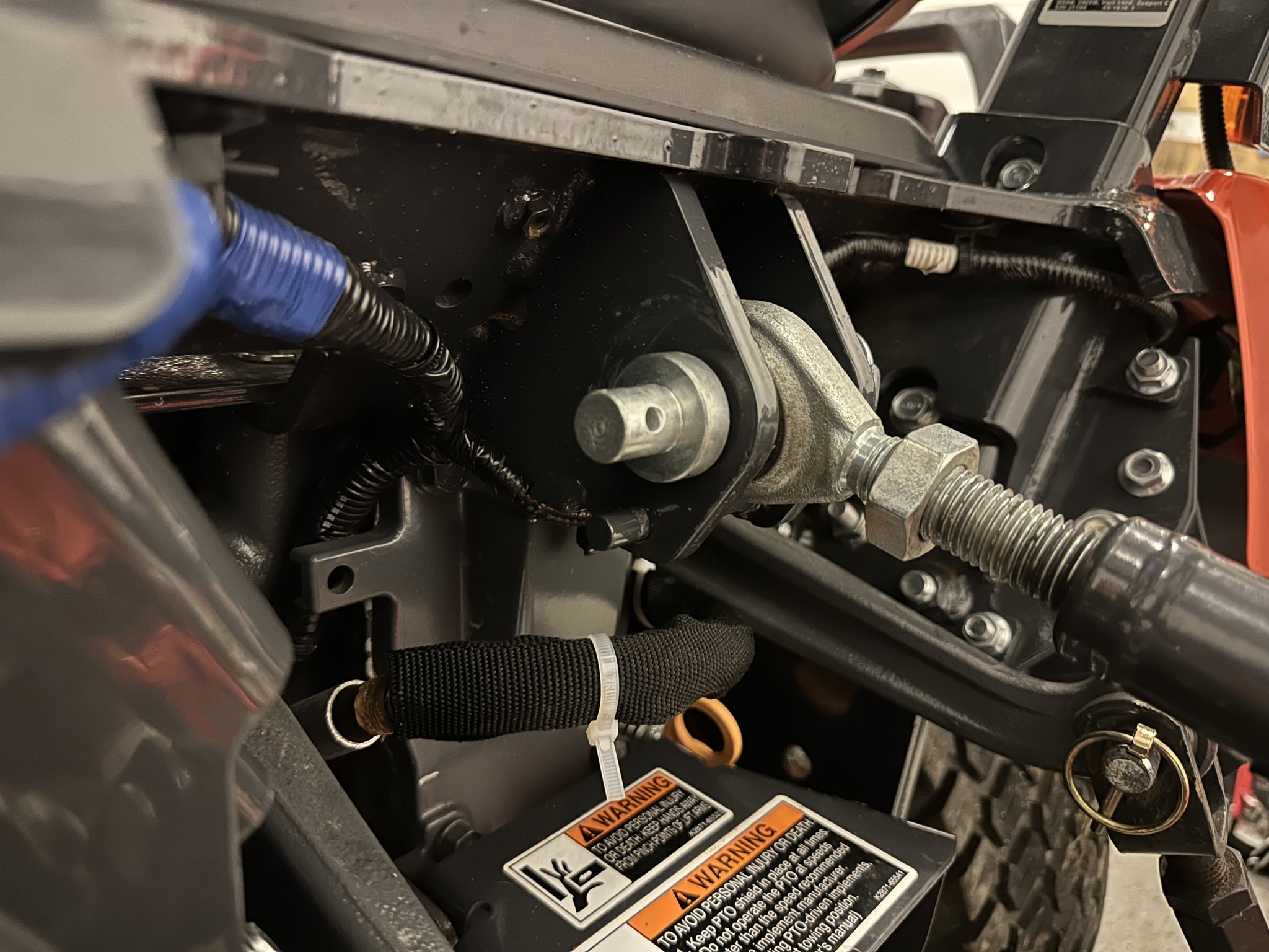

Next image is how it sits once I start to raise the implement with the lever.
The last image shows a little clearance between the left turn buckle (same on the right) and the frame of the tractor when I have the implement only a few inches above the ground (same spot as where the third image was taken). This will actually hit on the frame if I lift it any further.. Something seems very not right

Also on your third pic it looks like there's another hole below where your 3 point arms are attached. Did you try those?
I didn't, but given the wear on the blower around the hole, that is likely where it was positioned before they took it. Good eye!

You sir, if you're ever in the Portland (Maine) area, I owe you a beer, that was totally the issue, swapped those holes, and instantly allowed the attachment to drop to the floor like normal, and raise up without rubbing on the frame with those turn buckles.

Haha, I will keep that in mind! 😊 Glad it worked out for you. Its funny I wasn't really paying attention to the wear... it was my mechanical mind thinking that the lower hole would push out the blower and make it level. Glad that was the case! Enjoy blowing you snow! LoL
