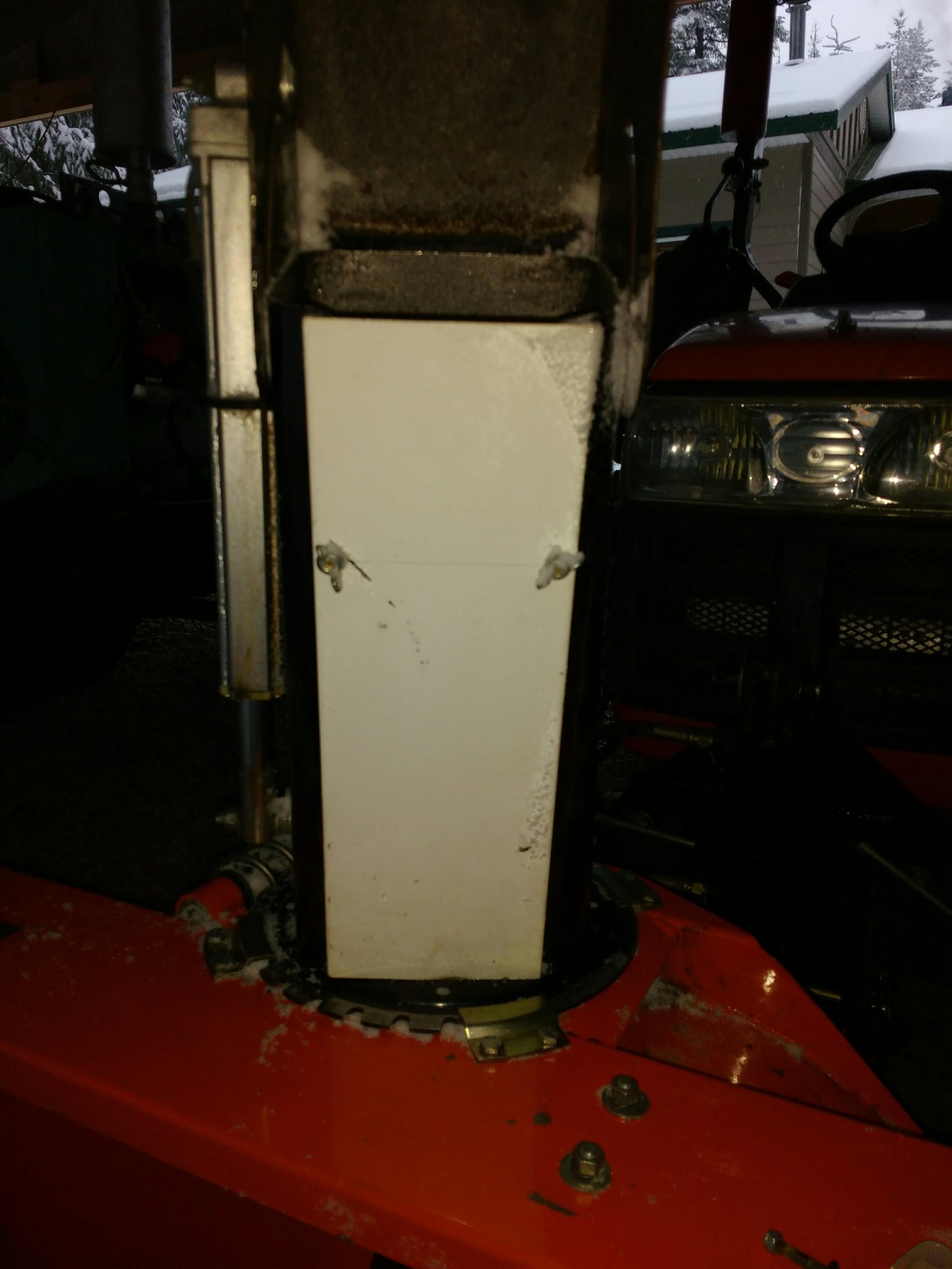

I’ve never seen a grate in the chute! I don’t understand why it would be there.
my Woodmaxx is lined. Their SB-series snow blowers utilize a high-density polyethylene chute liner to keep the snow moving and prevent snow from freezing on and plugging the discharge chute. This liner also provides a very slick surface for the snow to deflect off of, ultimately increasing the speed and distance at which snow is thrown out of the chute.

Grates are put there to keep the stupid people from sticking a hand down there while running and getting it chopped off. Companies have been putting them on for 30 years or more. I don’t think it is a country or state specific item.
