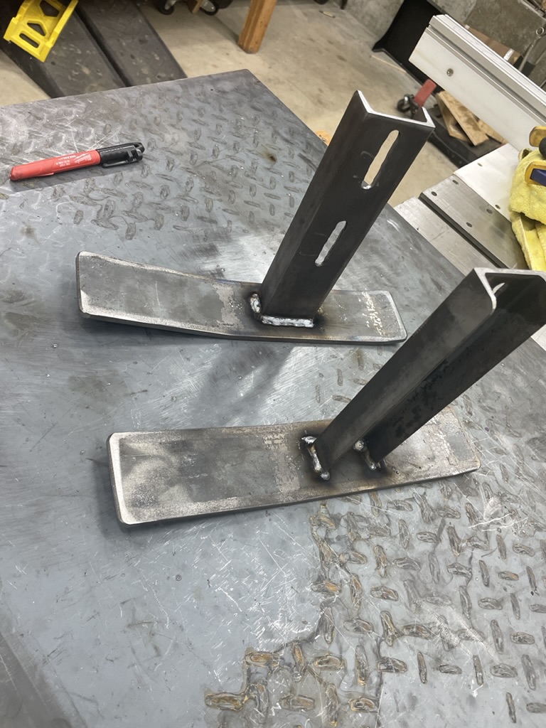

I have a Land Pride SB1064. My driveway is crushed asphalt; it's very well compacted, but still not as as solid as real asphalt. When clearing the narrow part (which is curved and on a hill), the blower skids drop off the edge of the crown causing the bottom lip of the blower body to scrape the driveway - not good for either the driveway nor the blower. And then on the flat parts, I leave an inch of uncleared snow.
Trying to address both, I've made a couple of modifications.
I made two additional skid shoes to run midships, to deal with the crown:
And I'm trying a rubber wiper to see if that will clean up the last inch better (pic of that to come later).
Hopefully we get some snow this week to test them out!

That's a great mod, I hope it works out, I look at the small shoes on my rear snow blowers they are basically useless as I'm running over crushed stone area around my barn and drive. Let us know how you mod works out.

Of course the best fix would be getting the driveway flattened out, but that ain't gonna happen in December! :eek:
Very nice work on those skids; that wiper is also a great addition. Be sure to get back to the forum with a performance report! (y)

The new shoes were good. Happy with those.
