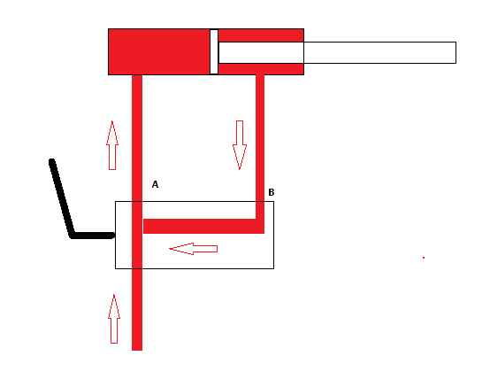

Here you go. This is the flow path in the regenerative section of the spool. Notice that A is connected to base end of the cylinder. This is crucial for correct operation of the valve and cylinder.
Incoming pump flow goes out A and into base end of cylinder. BUT - the return port B is not connected to tank as is usual. Instead it is looped back to A. Now both sides of the piston are at the same pressure but the rod end has a smaller surface area creating a force imbalance on the piston that extends the rod. Oil coming in B is looped back to A with the effect of increasing the flow rate and extend speed but force is reduced by the ratio of the two areas.
STUDY QUESTION
What happens if A is connected to rod end and B is connected to base end. The answer is not intuitive.

I'm guessing, but I think the would not move because the base has a larger surface area, or move very slowly???
9,952
5,282
Like I said this is not intuitive :)
Reversing the connections does not change the operation of regen becsuse the ports are looped together inside the valve and conditions at the cylinder are exactly the same.
What it does change is the operation of retract. With the connections reversed the retract port (B) is now connected to the base end of the cylunder. When the spool is shifted to retract pressure is applied to the base end of the cylinder, the rod end port (A) is connected to tank, and the cylinder is extended. You have lost the retract function.
