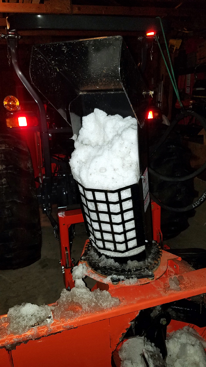

Here's mine, and for your viewing pleasure packed full of snow last year. That's one jammed up poop shoot! :ROFLMAO:

That is jammed full!

Here are the ones from my original post.there are 4 bars bolted to the chute and they have a bend inward at the top which made it hard to get any clearing tool or hand down the chute.
