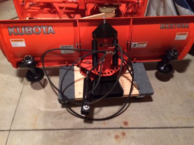

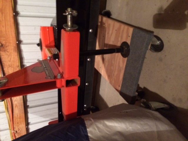

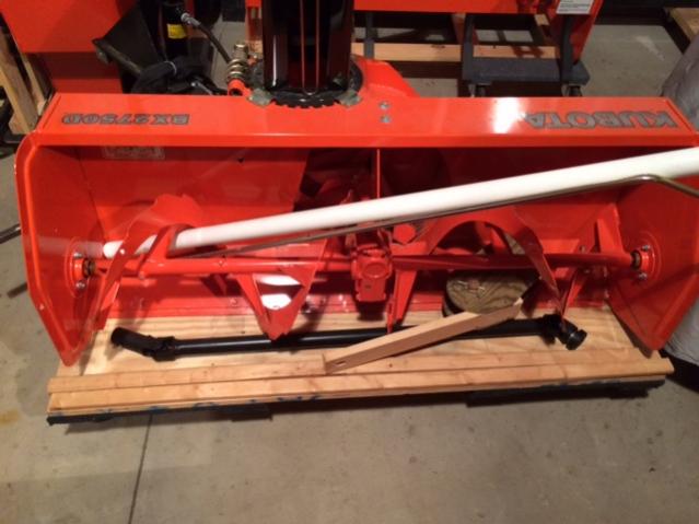

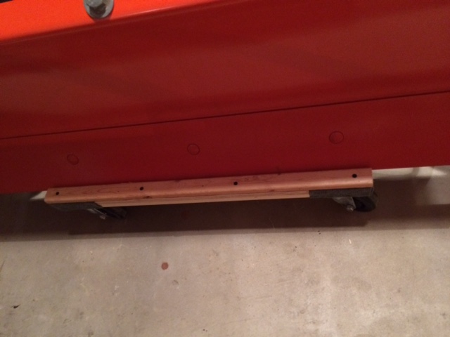

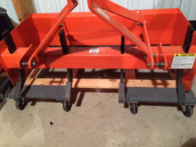

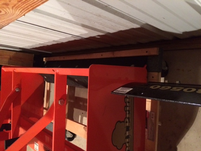

Ive been using furniture dollies that I bought from Menards. For the blower I used the bigger of their 2 sizes, I believe 18"x30", rated 1000lbs apiece. Oversize a piece of plywood and screw to the dollies. I added a 1"x2" lip to help center the implement. The dollies are on the outside so they are not tippy. All my implements are on there own custom dollies. Easy to move around the concrete shed floor. Pics are priceless :D

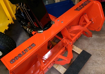

Agreed with the HF dollies. My new BX2750D rolls around just fine on a single HF dolly! And 12$! Just re-grease the wheels and spin joint and all should be well. And it sits at the perfect height to mount right up to the tractor.
