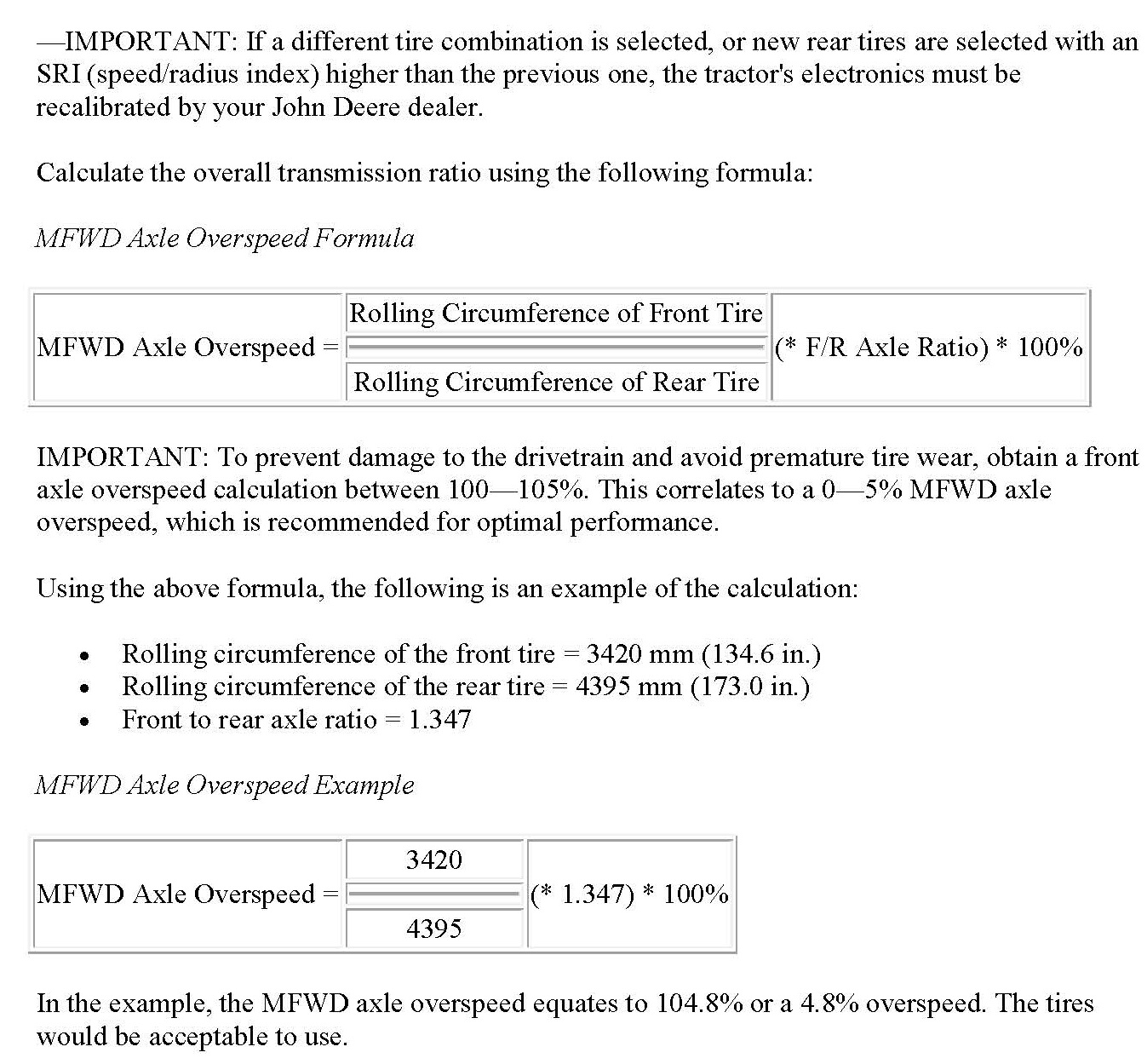

Remember when you have 4 x 4 you need to keep front and rear tire physical geometries in sync.
There is a front to rear ratio of rolling circumferences built into the transmission.
Years ago when 4 x 4 was just becoming more common companies like JD placed a front to rear ratio label on the back of the seat.
Here are some documents from my archives.

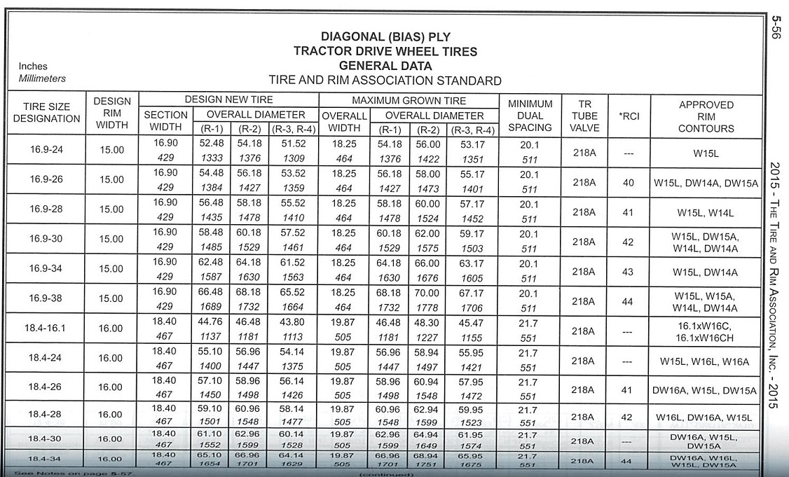

The Tire And Rim Handbook is the bible when it comes to a resource for tire and rim dimensions but unfortunately it has gotten so large you have to pay for it. Some big tire dealers might have older copies they would give away.
Here is a page from an older version to give you n idea of the amount of detail they have.
