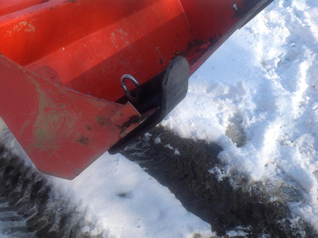

Here's a flick of a buddy in Ohio using his L3800 with shoes on the bucket lip. You can see them on the first frame before the video starts. His whole drive is gravel and he SWEARS by the shoes and just letting the bucket float. Much cheaper option.
https://vimeo.com/120393613
Ray
