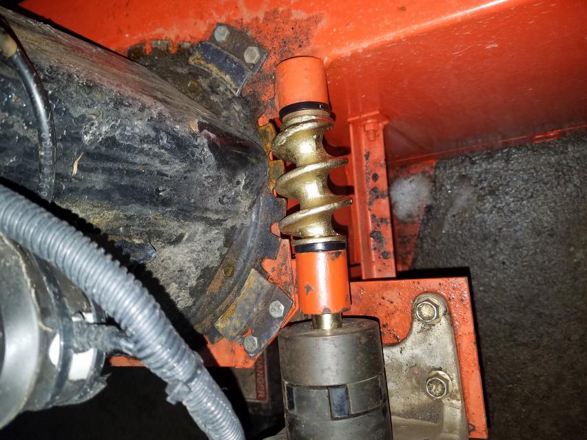

The new replacement part for the worm gear for the chute is a much better improvement over the old one. After having the wire worm gear break at both ends after this past Nor'Easter storm and having to have it "emergency" welded, the plastic bushings got burned and the wire "worm" was out of round. Ordered the new one and it is one solid piece. Works much better and I do not have to worry about anything break on the actual worm gear. That and the new plastic bushings it works a bit smoother.

That looks like an auger out of an old cranked meat grinder,,lol
reamer
I might have missed the post, but what have you done to avoid the damage of over running the drive gears on the chute rotation? It appears that the original "spring unit" failed due to over rotation.
What will happen now with the "food grinder" screw?
I ask, as I have recently purchased a hydraulic motor for this same application, and don't wish to repeat failures.
Not that the wire "spring" failed because of over rotation...it rusted out and broke at the weld because of the heavy snow we had up here that year. There was a lot of heavy wet snow being pushed through the chute and rotating it when it was into the heavy stuff is when it broke. I wasn't even to the limit of the rotation for the chute when it let loose.
The "new" screw drive works fine. I usually take the chute off and clean everything up and make sure there is no significant wear on anything before it goes back into snow blowing duties. Probably going to add a few extra notches into the edge of the chute when I service everything before any major snow hits.

Is the new worm gear superseded over the old spring?
I haven't completed the hydraulic rotation yet, but added notches all the way around the chute a long time ago. And no, I've never blown snow in my face, but the added rotation really helps in some tight spots.
