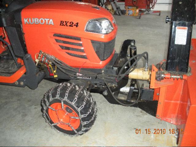

I hope to do the same mod to my blower. Here is the change I did this fall. It's a little slow but much better then by hand. The motor was 30 years old from a compressor station I work at. The system was changed to air. I spent about $100 on hoses and couplers.
