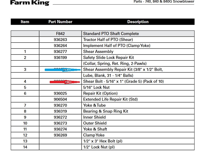

Please post photos of good and broken both styles of shear bolts.
The model 840G Farm king which is a model from 2012 shows 3/8" and 5/16" shear bolts.

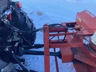

Lift the blower off of the ground ,turn your pto off and shut your tractor off. Make sure nothing is still turning, then check that you can turn the blower easily by hand. If it turns easily find a flat place, lower it and verify its level. Your 3 point hitch top link may be too long and causing your auger to be pressing on the ground.

I think my top link is adjusted OK as per picture. The PTO shaft is near level as well.
