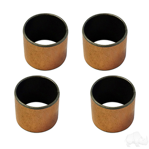

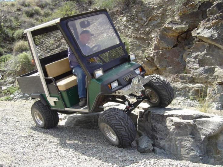

The problem is that the golf cart spindles (pic #3 in post #1) have nice, beefy, 1" dia axle/wheel bearing assemblies, but the kingpin setup is woefully inadequate, even with stock wheels, let alone the huge rims & massive tires on mine. As shown in #1 pic below, the spindle casting only has room for a couple of short, thin, oilite bronze bushings for the 11/16" kingpin bolt. (#2 pic) These bushings are completely inadequate for the weight & side loading, so they wear quickly, yielding lots of play in the steering. Ideally, I would like to add a set of upper & lower tapered roller bearings of suitable size to handle the load, but there just isn't enough "meat" in the EZGO spindles. That's why I'm considering swapping to a more heavy duty "automotive" style front axle, IF one exists that I can find, adapt, & afford. Found a couple Jeep 2wd drive axles as suggested above, $1900 for one & $2500 for the other. Ouch. I have recently found there are aftermarket bushings that may fit mine that are full length & a different material, but further research is necessary. (#3 pic)

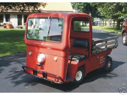

Something like these? I have wanted one of these for a while. They can really trick them out.
Mini Trucks
I really like those little trucks, but have never seen a junker or parts truck to cannibalize. But I'll keep looking.
